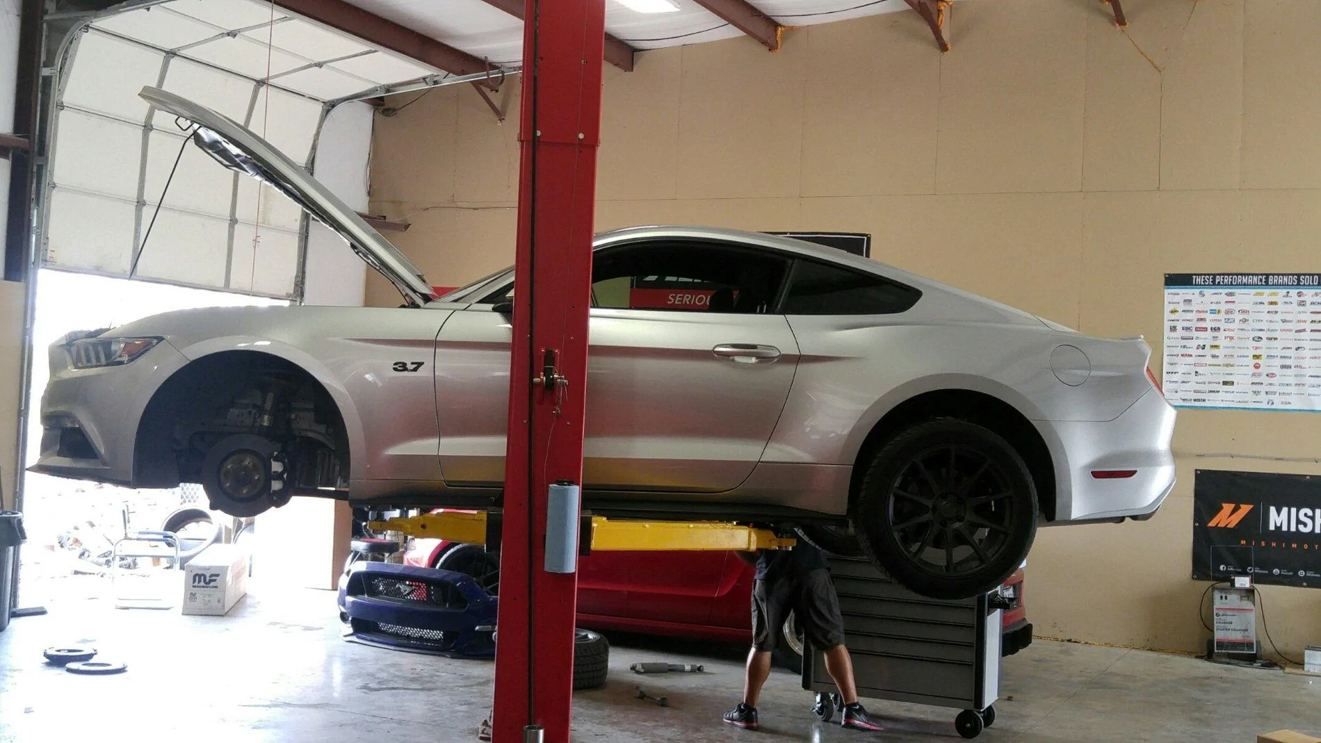

Today BMR 763 springs and performance pack dampers are going on. Also the BMR cradle lockout kit. Can't wait to see how different the car behaves afterwards.

I noticed a difference in how it feels immediately. At highway speeds the ride is better. So much more controlled. Ever since I put on bigger wheels and tires it felt like the car was bouncier and less in control over bumps. It's so much better now. Sharp bumps at low speeds feel a little harsher but not a huge difference. I'm going to cruise around with some other local S550 owners tomorrow and should hit some twisty roads. Looking forward to seeing how it handles.
One thing about putting BMR minimal drop springs on a V6. I think the front drop might have been zero, lol. Lighter front end, I suppose is why.

Give it time to settle and that front drop will come out to .1 maybe! Always good when you can tell the immediate benefit after install. If you went a step further with the dampers it might be even better, but for the price it's hard to argue.

Haha. I guess I should have gone with the 080. I actually tried to sell the PP stuff locally. I wanted to try the Koni or Steeda actives. When I didn't get much interest I decided to stick with them. The 18-19 PP rear shocks are supposedly better than the 15-17. Hopefully, that's the case since these came from an 18 GT. So far everything feels like a clear upgrade from the base V6 springs and dampers.
