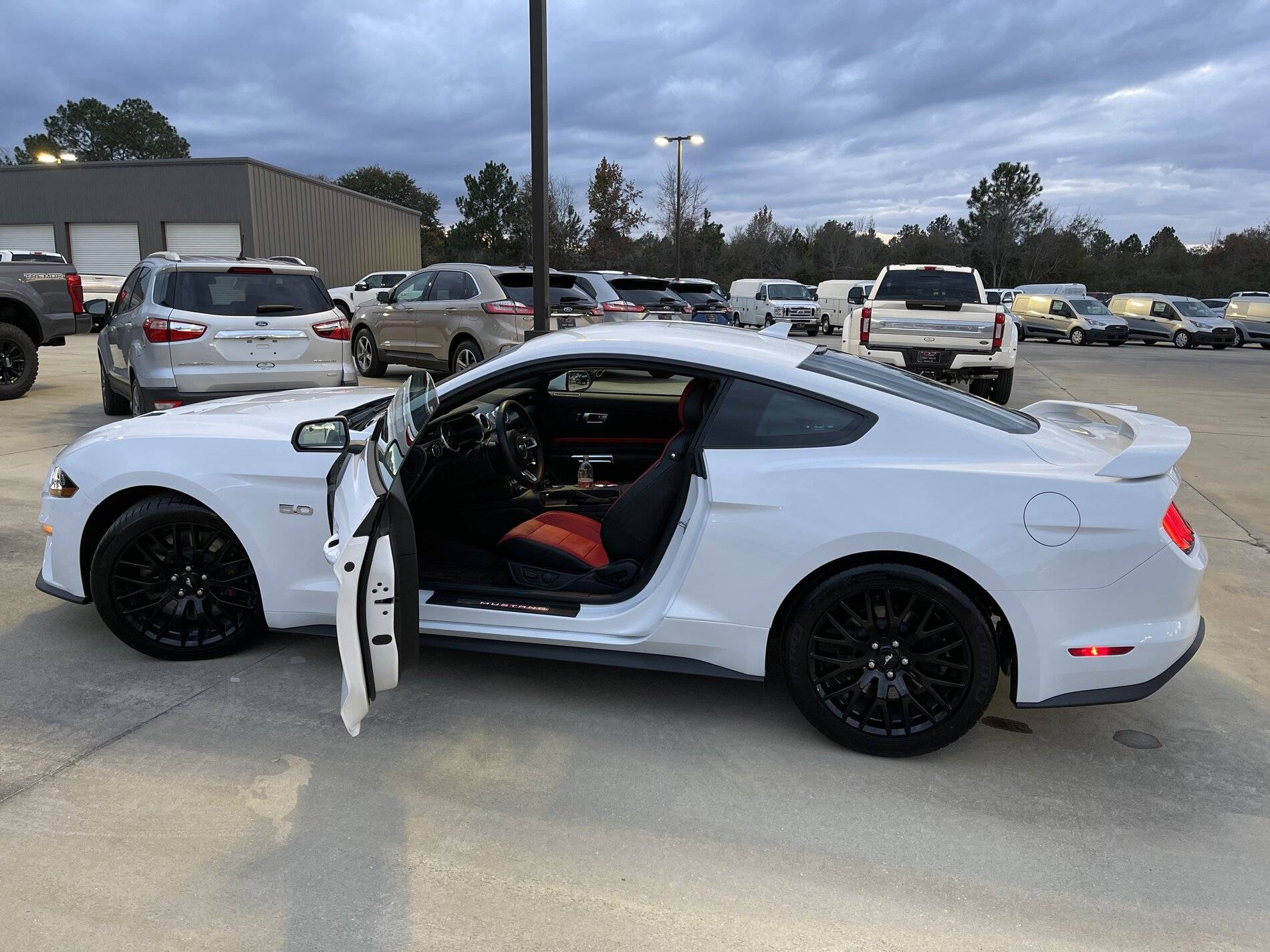

Well after waiting nearly 7 mo for my order to get here. I finally traded my 15 pp1 for my newly ordered 20 pp1 401a magna car 5 days ago. I can say magnaride is a whole new world of comfort and handling compared to the old pp1 cars 😳
Im sure this has been asked an ungodly amount of times. My first mod will be headers and exhaust. I want to go with a stepped header to full proof future mods. I’ve narrowed it down to: Kooks, ARH, and Pypes. What’s been everyone’s experience with the 3 brands? The rest of the system will be Corsa.

Very nice. Congrats! Love that red interior!
Me too, it’s one of the reason I had to special order the car. I wanted all the options with white exterior and showstopper red interior. Try finding one of those on a lot 🙄
