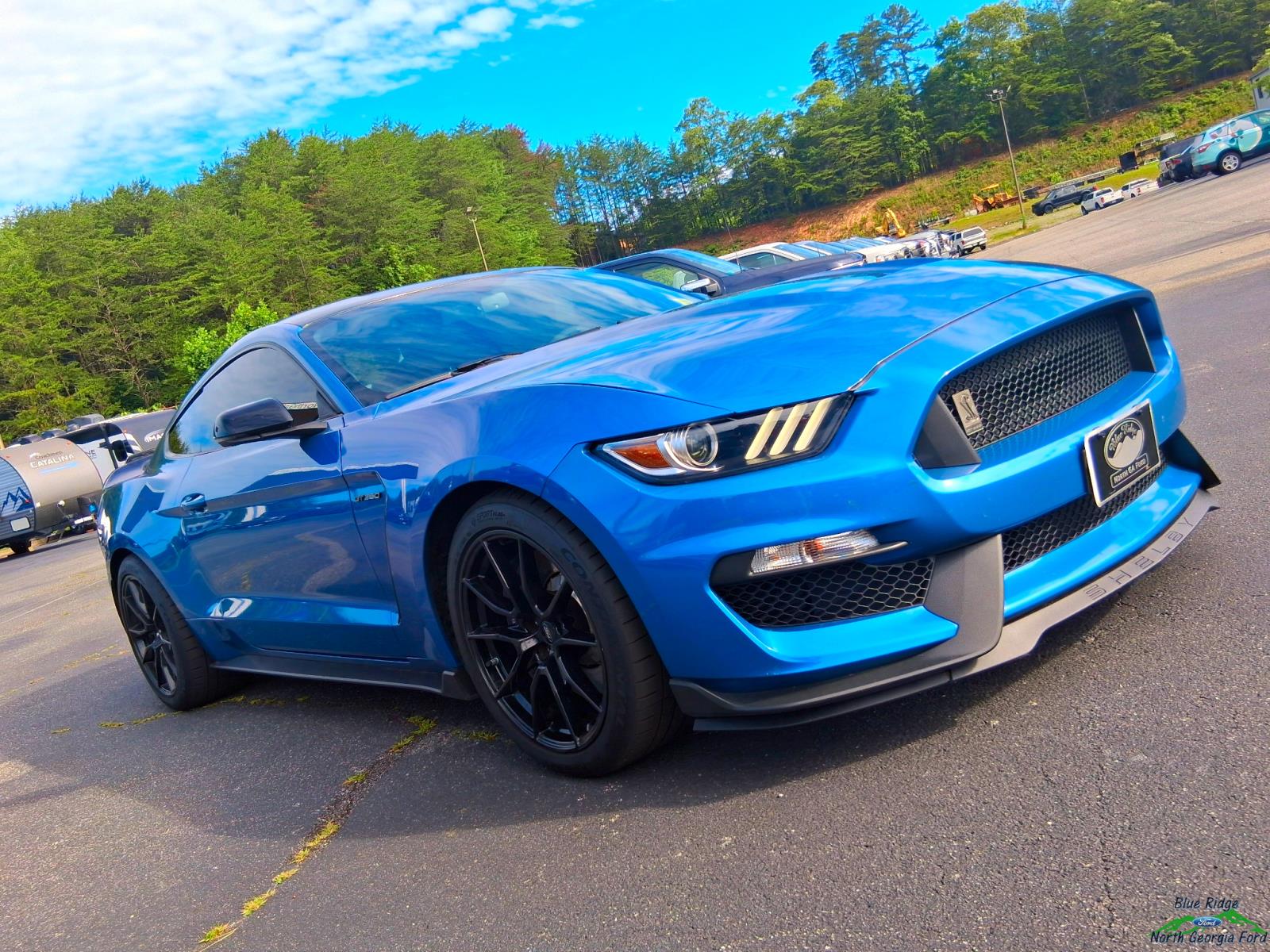

I have a busy day ahead of me today. I hope to be able to provide some first impressions tomorrow. In the meantime, this is a dealership photo:

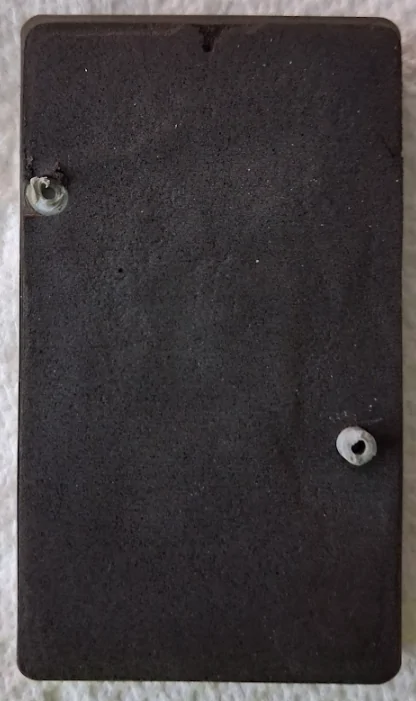

The Shelby badge/logo/emblem on the trunk is mounted with two snap into place posts. One of the posts is broken. Unfortunately the broken piece allowed it to rotate and scratch the paint when I washed the car yesterday. It’s not bad, I think I can easily buff it out, but does anyone have a recommended source for a replacement logo? If not, then I am thinking I could reattach this one with a couple of short SS panhead screws from inside the trunk?

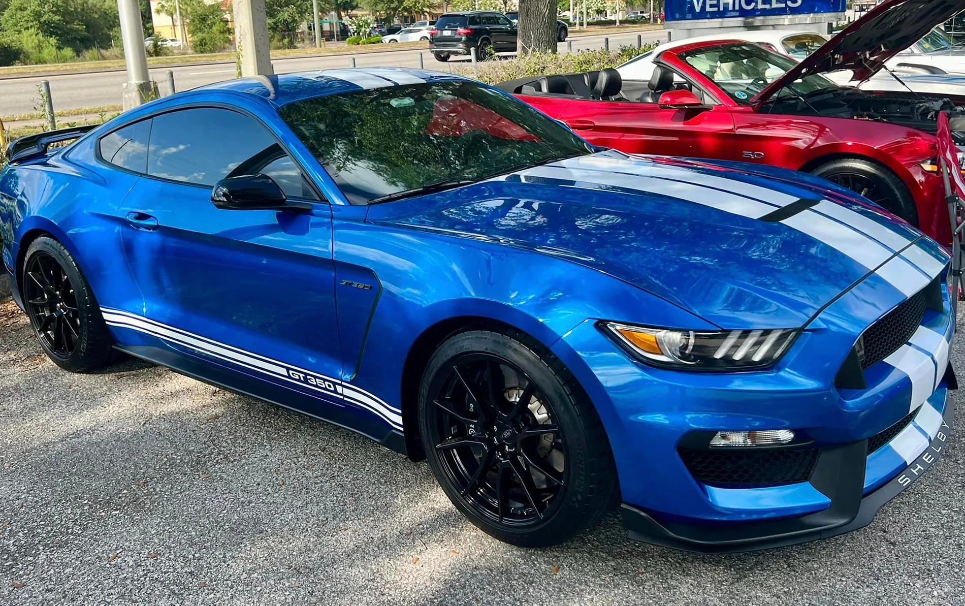

Welcome & Enjoy. Pics and lighting can be deceiving, it looks Velocity Blue?

  • 3M double side tape arrived from Amazon yesterday for reinstalling trunk emblem. I am now thinking I will tap the remaining plastic posts and screw as a backup to the 3M tape
I am debating whether I should remove the OEM backing/padding off the trunk emblem or just put the 3M tape directly on the padding. Any recommendations?

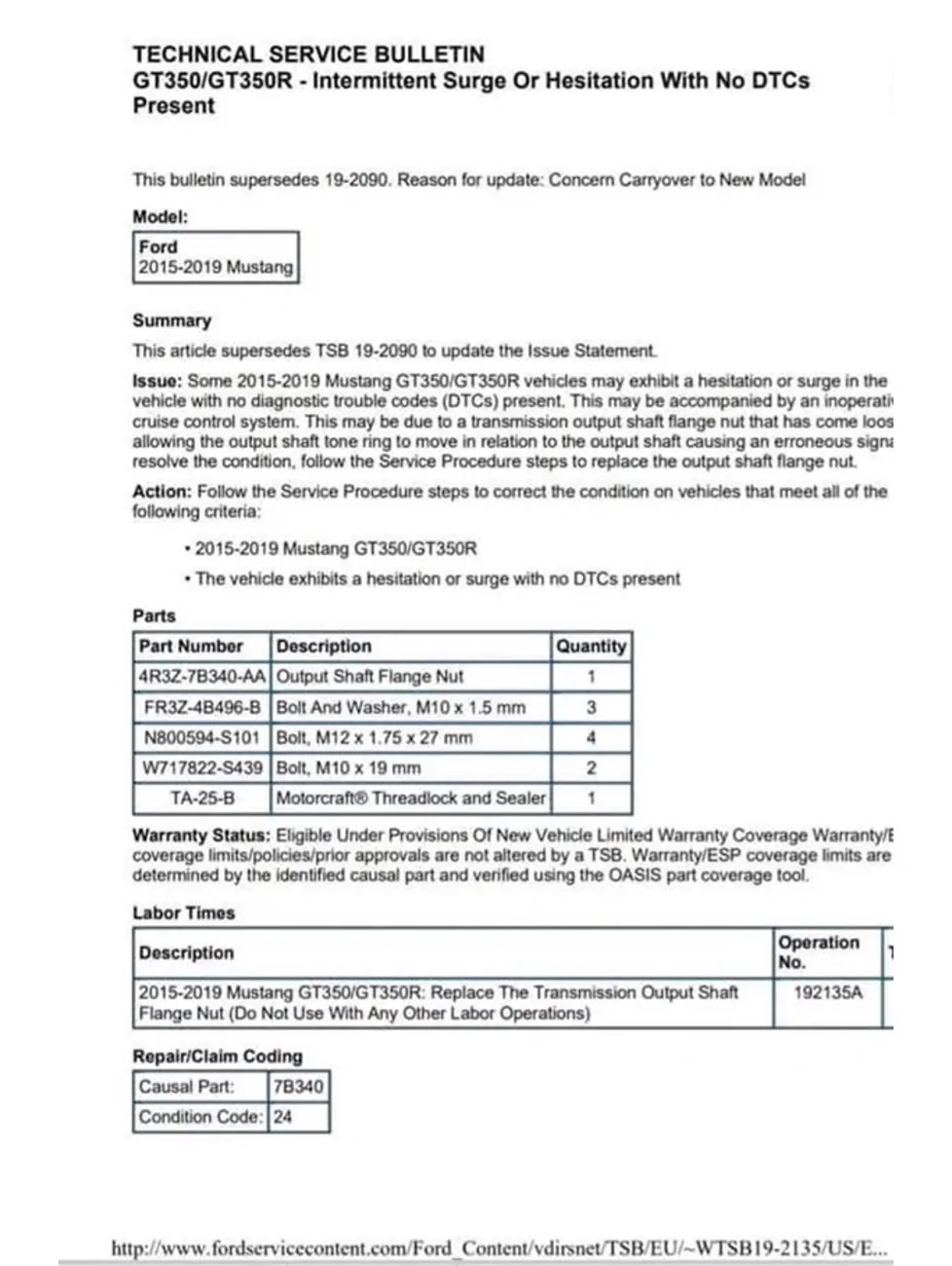

So, I am experiencing the well documented wrench display and surging down the highway experience. I have ordered new transmission flange nut and driveshaft bolts - they will be in next week. In the meantime I am driving with traction control turned off and all seems well, cruise control even works 👍

Are you talking about the tone ring TSB?
if so, there’s a couple more bolts recommended 😉

Indeed, the magnet/aka tone ring/hall effect sensor on the transmission output not matdhing the rear ABS sensors issue. I don't perceive the other bolt replacements as critical, but I am receptive to an explanation why they are.
