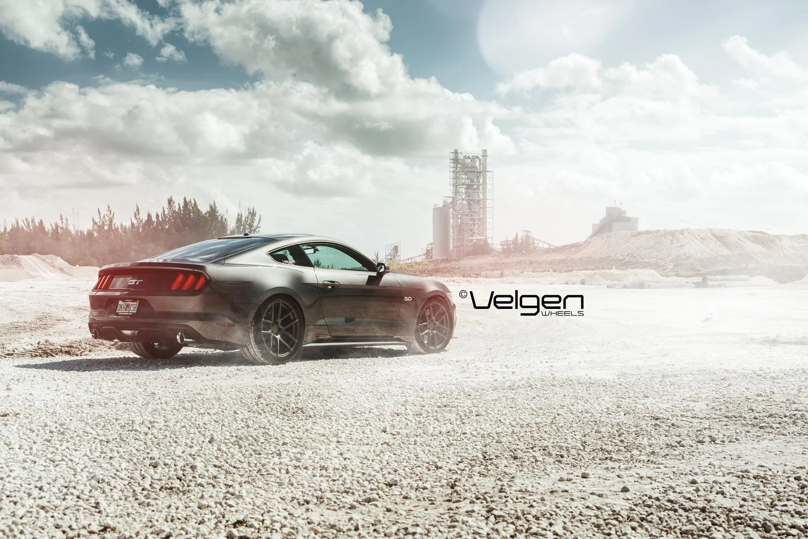

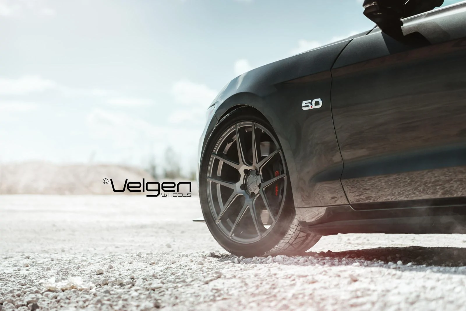

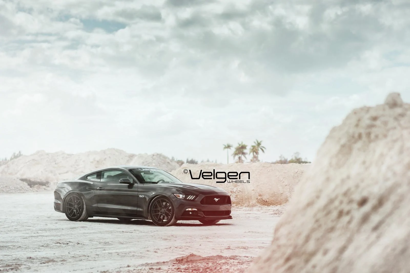

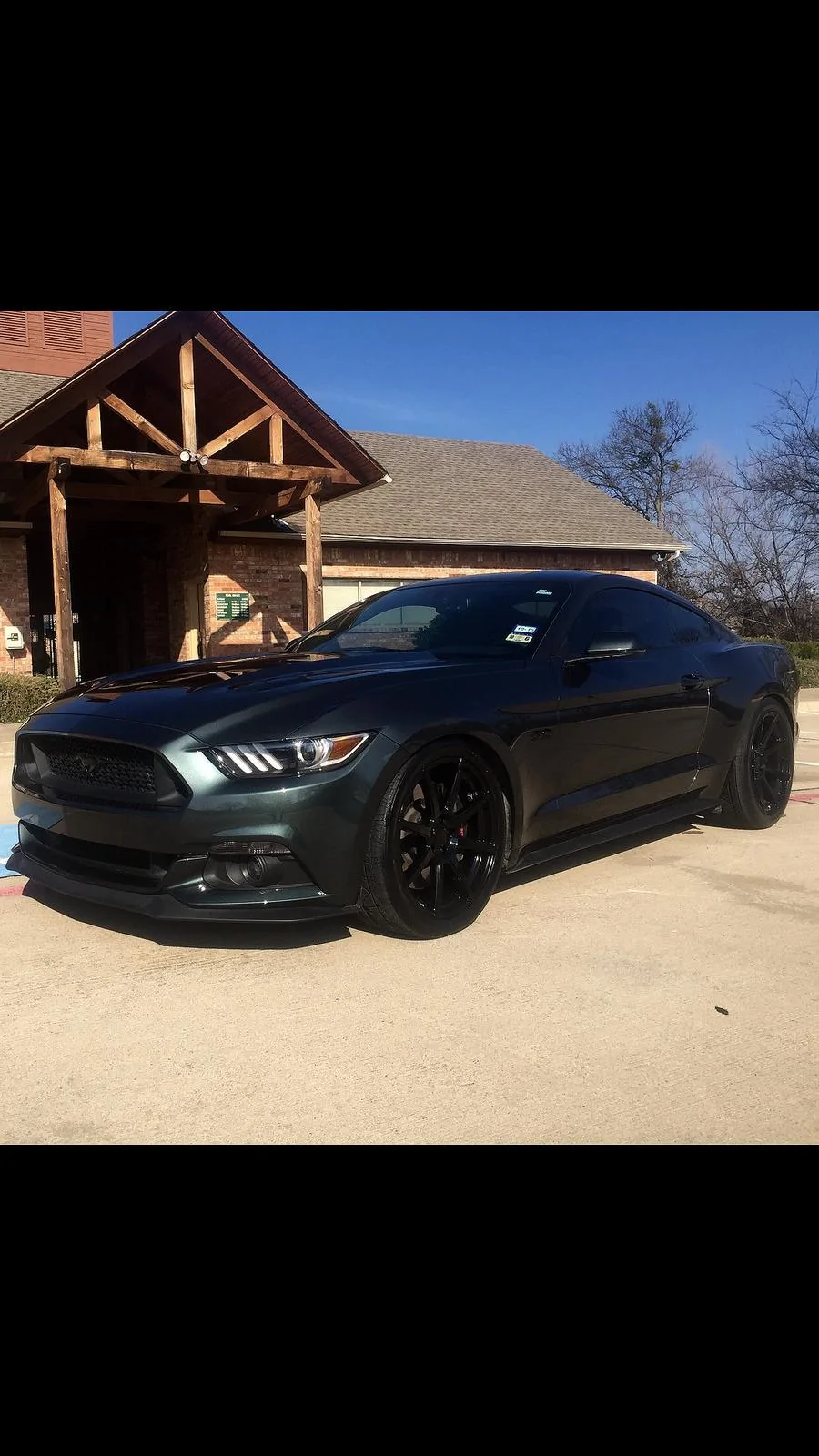

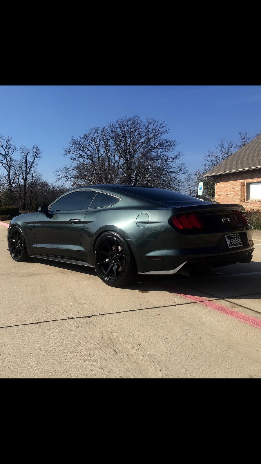

Hi guys, just bought me a 15 race red GT non PP. I'm wanting some black wheels with new tires, I'm thinking the staggered look with a 275/ 305 combo? What is gonna be my best bet? My car is a weekender only that will see no rain or wet weather ever. Any body have any pics of black wheels on a 15? Thanks for any help.
We are currently lowered on eibach sportline springs with our Velgen Wheels VMB5s on a 27/35/20 in the front and a 295/35/20 in the rear with no issues at all. The wheel specs are 20x9 +35 & 20x10.5 +45. You can definitely run a 305/35/20 without a problem, some of our customers have run that size and they love it and have no issues rubbing. Here is a picture of our mustang on the VMB5s as well as chargedguard5.0s mustang on the VMB8s custom Gloss black Finish with the same tire setup.
Chargedguard5.0's mustang lowered on Eibach pro kit
