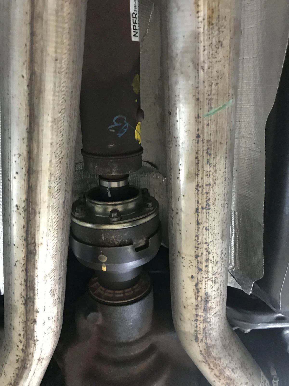

Thanks guys. I put my car on jackstands and noticed that the yellow mark on the driveshaft doesn't line up with the yellow mark on the pinion flange (see picture). I read in another forum that Ford put them there so the driveshaft and pinion can be lined up to minimize vibration. I guess the mechanic who did my gears didn't line it back up.
I took my car to the shop and rotated the driveshaft relative to the flange so the marks lined up better. The vibration was greatly reduced, but still there. Same speeds. The low drone/hum was also there. I then noticed in the picture that there's a hemispherical button-looking thing on the driveshaft. Is that supposed to be a balancing weight ? There's a circular shape on the pinion flange that looks like something similar was attached to the flange but it fell off.
Anyone know what those hemispherical shaped things are? Could it have possibly fallen off the pinion flange? Any other ideas?
