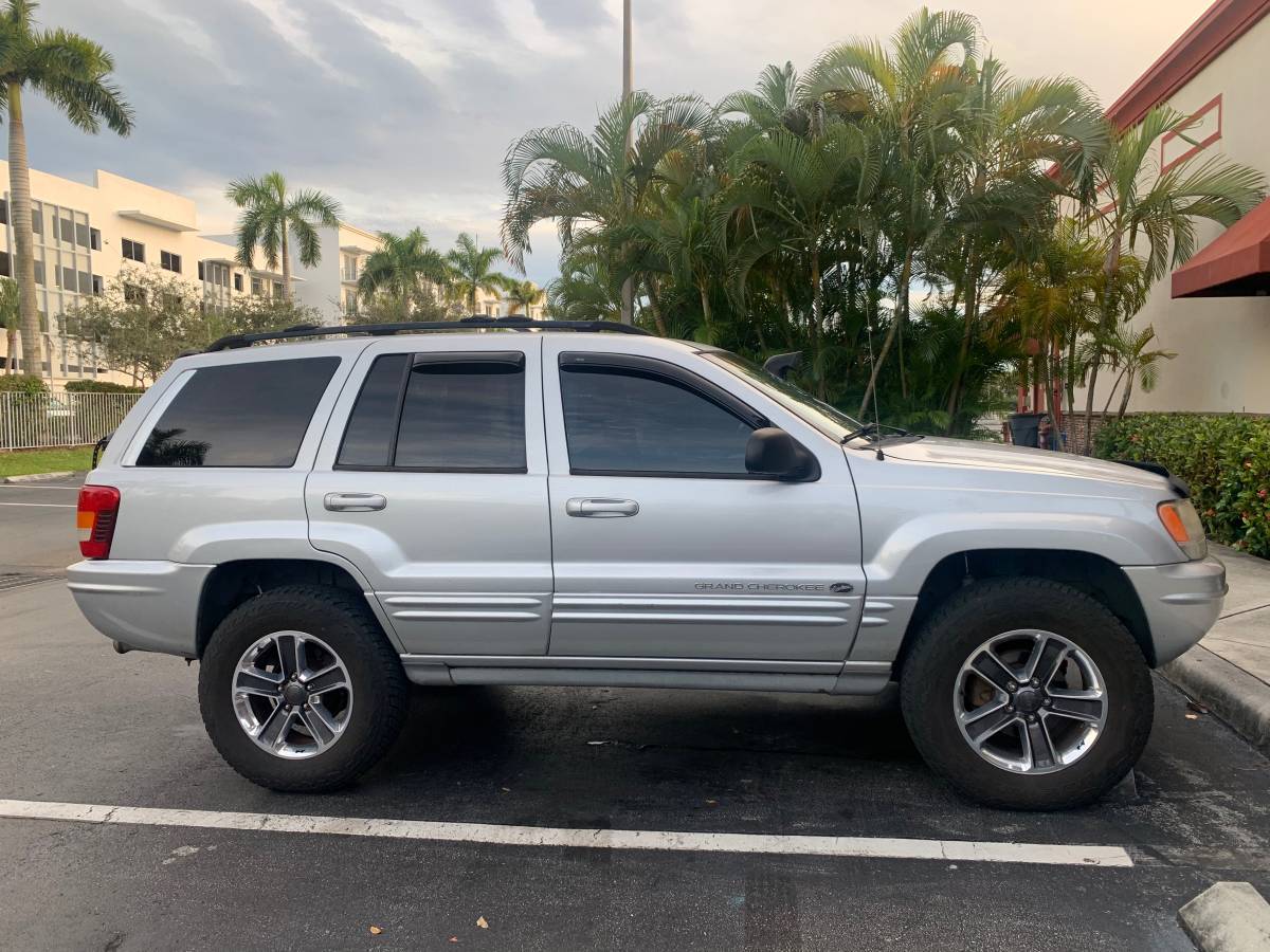

Finally broke down and did it. I purchased my third Jeep today, I should probably be put in a straight jacket.
Little background - my first vehicle was a 97 Cherokee (XJ, for those that speak the language). The thing was an absolute tank and have a drivetrain that wouldn't quit. I sold it in 2013 and missed it dearly.
I then ended up in an 04 Grand Cherokee (WJ) Columbia Edition. 2wd, 4.7HO which is essentially what Ford could've done with the 2v 4.6 (the 4.7HO had 265hp and 330lb ft). At the time I was commuting about 40 mi/day to and from work and gas was a blistering nearly $4.00/gallon at the time. I traded that in on my former Focus ST and with the savings in gas and repairs, I was coming out on top with the Focus ST monthly.
Traded my ST for my GT in late 2018. Still missed my old Jeeps pretty much every day in between. Something about how comfortable and simple they are, plus the ability to explore the unpaved wilderness has always been a part of my life since I was a kid.
Fast forward to the past few weeks. I started browsing Craigslist/Offerup/Autotrader for Grand Cherokees to DD and keep the miles off the Stang, haul my bike to the trails and ideally get into some other outdoor activities that require cargo capability or off-road capability. The ones I found were either being sold by dealers for more than my budget, or they were beat to hell and back. I looked at two, one of which sold the same day - and that was OK as it was an auction car and looked like it had been buried underground for a decade.
Found a private seller, '02 Overland (top of the line back then), Quadradrive (still one of the best 4wd systems around), 3" lift and wheels/tires off a newer Wrangler. 183k on the odometer and the interior was actually clean, seats not all busted up, etc. Overall it's in pretty good shape for an 18 year old truck but definitely needs some things and I'm OK with that. The PO did a lot of maintenance items and disclosed everything I found as far as things that need fixing. TO my shock and awe all the windows, hatch/glass and sunroof work. It's going to teach me some things I haven't tackled (rust repair for a spot on the roof) and some other fun stuff. Air is ICE cold, but blend doors need to be done and there's no heat (core is bad), but I could care less being in South Florida. The engine still makes good power and sounds healthy, but I believe it needs valve guide seals which are a pretty common thing on higher mile 4.7 mills. Puffs a little smoke (blue) on startup and idling for an extended period when you give it some gas. But you know what, I don't really care. I am so freaking excited to be back in a Jeep and it just brings back a lot of good memories AND I get to keep the miles off the GT. I got it for under $2k.
Anyway, without further delay (yes, that's a snorkel on the other side):

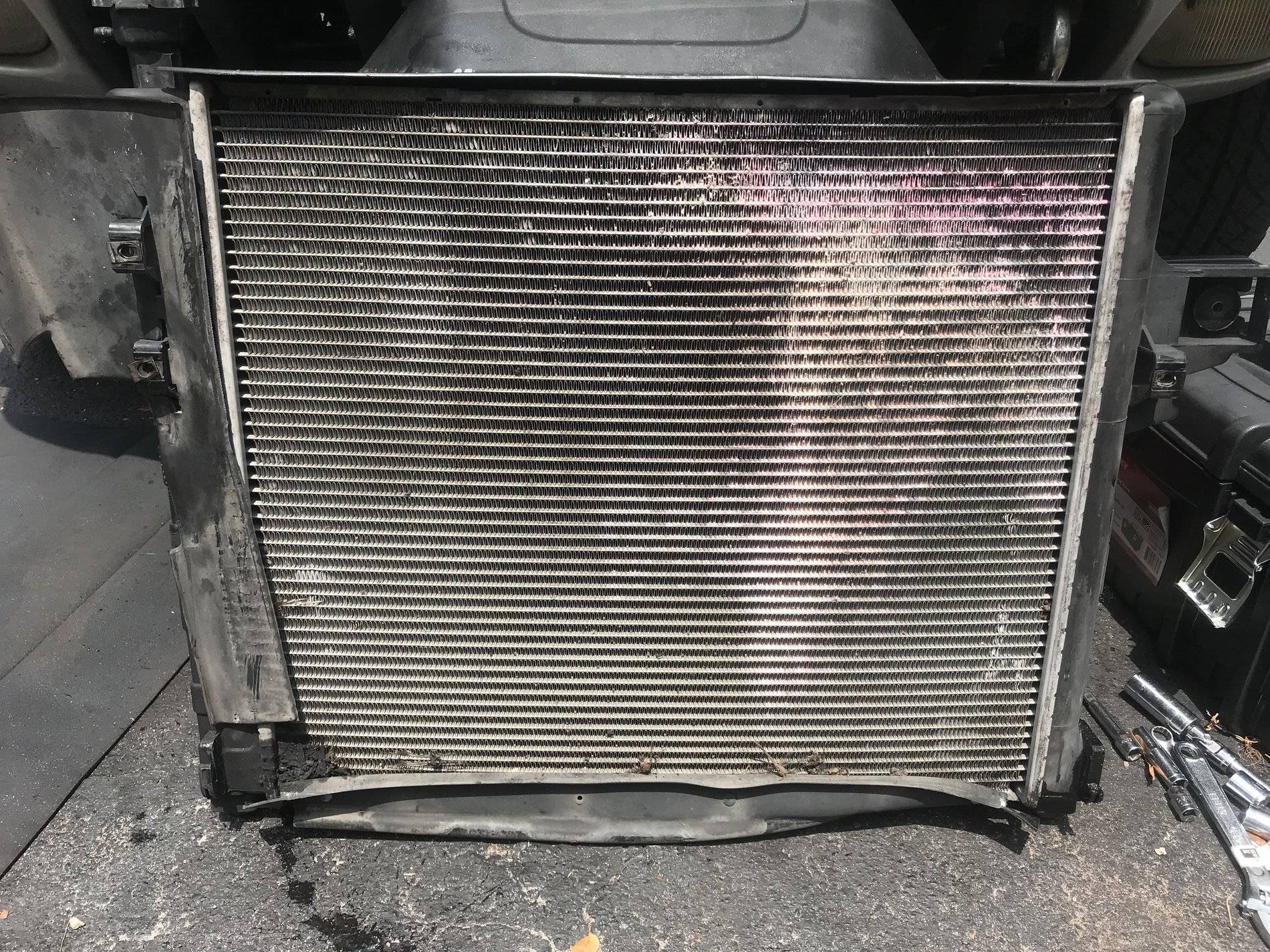

Yesterday I changed the radiator. Had a small leak when I got it that lead to having to add coolant every day before driving, got tired of that real quick.
The old one doesn’t seem to be in too bad of shape... lol.
I would also like to take a moment to thank Chrysler for making some absolutely bullshit designs with the cooling system.
1: Single core radiator. Some of us live closer to hell than others. Sure it works, but it would be nice to have a 2+ row especially on a heavy SUV with 4x4 and tow package.
2: Plastic end tanks - this is the third radiator I’ve replaced. One per Jeep. Absolutely God aweful design that doesn’t handle heat well at all. It starts with a small weep and loss of pressure and goes to hell from there.
3: The fan is powered by the steering pump. There’s two hard lines and a soft line that attach to the fan assembly. The fan assembly has to come out with the radiator, because it’d be damn near impossible to reach and loosen the bolts that attach it to the radiator AND squeeze the rad out.
4: Impossible bolts. The best way is to remove the front skid plate to get to everything. Well, because the bolts are difficult to reach, even with swivels I had to kiss that goodbye once I realized they were rusted in place. I had to contort myself in ways I rather forget to reach everything with the skid on.

Your WJ looks to be in good shape. Nice find. I have a '96 Jeep XJ that I've been modding for a few years. Unfortunately the Just Empty Every Pocket acronym can be true lol. These things are getting on up there in age now.
With your radiator leak, did you see a puddle on the ground or was it evaporating before it hit the ground? I'm having a coolant loss issue as well.

It would drip on the ground after parking it. It was running down the end tank and would come out between the bumper cover and skid plate. Problem with mine was the AC condenser and trans cooler block the view to the radiator from the front and the fan shroud from behind, so it was hard to pinpoint the source. I had a WJ a few years ago that had the same failure (end cap leak).
Have you checked your water pump? When they go bad they leak out of the weep hole which often causes it to drip in obscure places or not at all once the engine is off. I miss working on a 4.0, so freaking simple.
I've got a lift with 33s, aftermarket bumpers, and hopefully about to re-gear in the next two weeks or so. A fairly simple build compared to some, but I just wanted something reliable that I could drive in bad conditions or run a trail every now and then but still occasionally drives on the highway.
I haven't checked the water pump, but that's a good idea. I wonder if I should clean everything up and put some UV dye in the coolant to track it. Might not be a bad idea.
