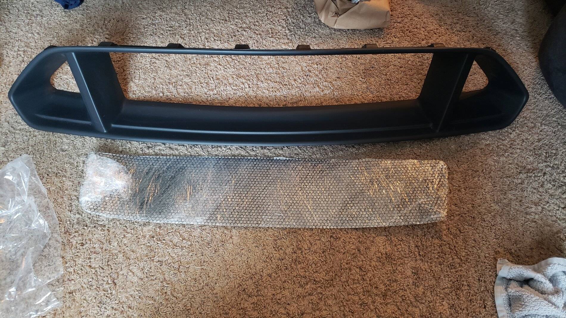

Got my new Cervini C-Series upper and lower grilles today, will be installing this weekend and posting pics. First thing I notice is that it was covered in some sort of black soot when I took it out of the packaging. Also the texture is a weird grippy plastic thats clingy and I think might be a PITA to clean. Hard to explain but if you take a cloth or paper towel to it all the fibers stick to it and it makes white lines in the plastic. If anyone has any suggestions for cleaning these thatd be great, my only thought is pressure wash it and blow it dry with compressed air.

I always wash with a pressure washer and snow foam cannon and rinse it all down with the pressure washer as well and have had no issues with my C-Series grilles over last 2 years.

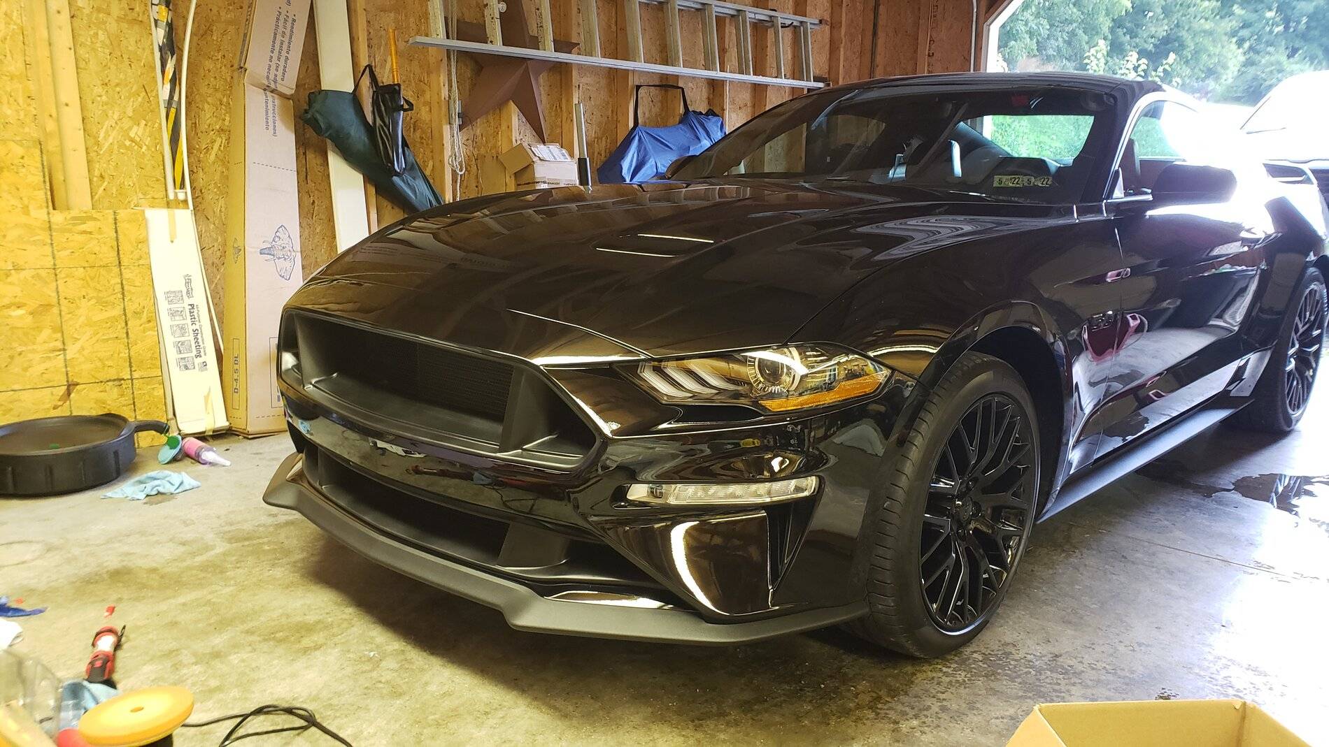

So I have the grilles installed. It was horrible. I would not want to do it again, however I have a PP car and the L and V brackets don't have the "factory hardware" to bolt them to the car?

Excuse the mess. Just a few tips, the brackets on the performance pack cars use 6 supplied bolts, 4 go through the L bracket into the V bracket. 2 go into the radiator support using the speed clips, the front oval shaped slots in the V bracket must be lined up with the nearest holes for the underbelly pan, tighten from the top of the L bracket first, then the 2 bolts at the bottom then the radiator support last.
The fitment is decent, take your time! But the install took me over 8 hours. Its a major pain.
