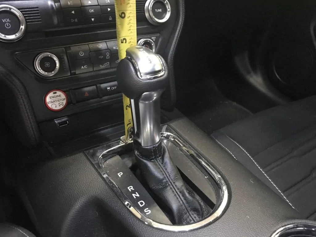

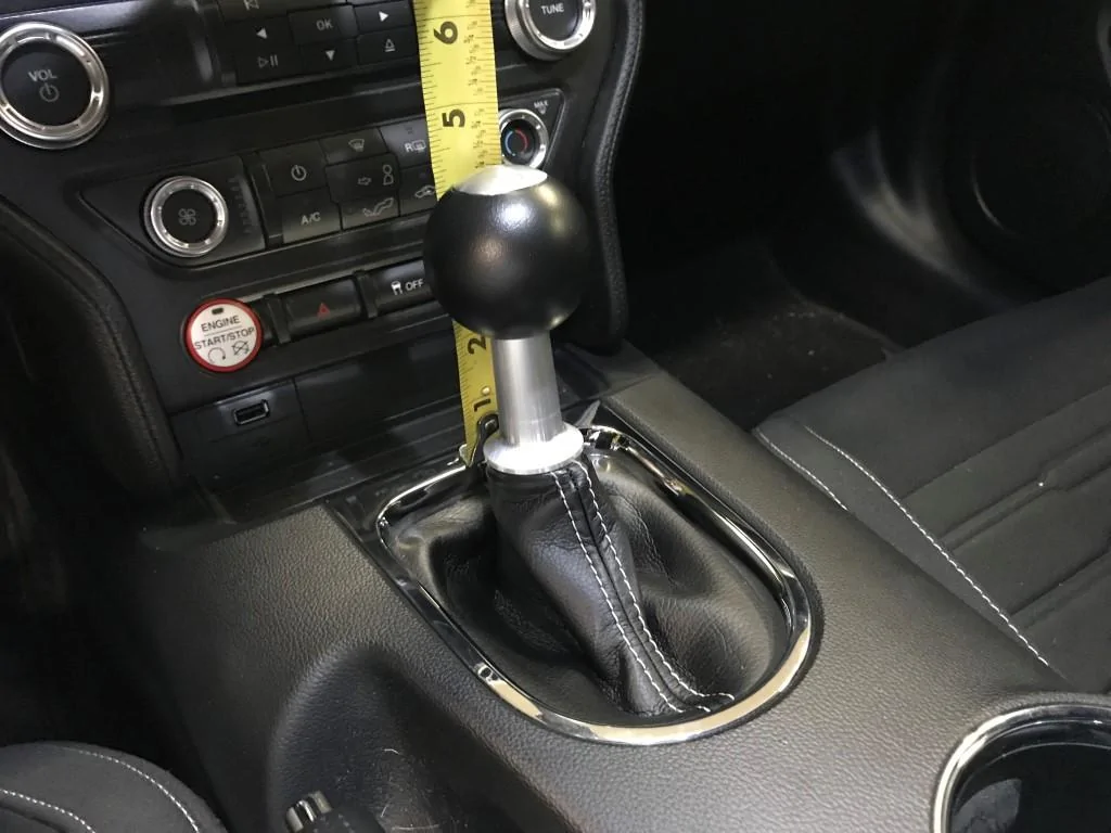

Thanks so much for the pics, I agree that it looks a little tall. I wonder how hard it would be to cut it down a little. Thanks again for taking the time to post the pics, much appreciated.

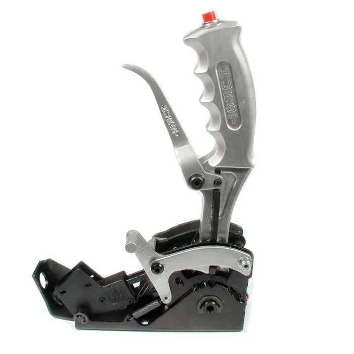

Excuse the quick low quality cell phone pic.
Something like this? Except with the Coyote logo reading normal left to right, and the right side of the grip chamfered and angled to match the left side?
That would look great!

Now this would look killer

The over all height has to be that tall because of the way the factory mechanism activates, however, ours is about 3/8's of an inch lower than stock. We are working on adding a momentary switch option to all the knob choices.

I have the white madness garage shifter. What I like about it is how much lower it sits than the stock shifter. This one seems to be about as high as the stock shifter.
I would like to see a t handle conversion kit though.
I agree. I was hoping that it would be shorter. I did take measurements before and after and its only about 1/4" shorter. Not enough IMO. Love the build quality and look...but the shaft needs to be a lot shorter.

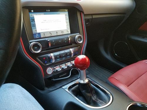

Installed this shifter using the stick shift boot. I think it gives it a much cleaner look and I was able to get a white stitching boot to match my seats.
Initial opinions:
Operates smooth and easy. When putting the car in S and racing, stomp on the gas and then slap it into D, more than 50% of the time it would slip past D and into N. This is problematic if you race your car this way. After playing with my shift techniques I was able to get less misses into D, but it still happens. Not sure if heavier springs will help as the side effect will be harder operation getting the car out of park. I have since swapped back my stock shifter to ensure no lost races.

Oh no the dreaded mt -82 tie strap... no thanks!... lol

You can move the shifter from S to D without pushing down on the shifter. You cannot move the shifter from D to N without pushing down.
There is a notched cam mechanism that prevents movement unless the interior shaft is pressed down. This double shaft design is why both Barton, Hurst and WMG are all designed the way they are. Simple engineering without changing the factory shaft.
I'd definitely like to see some real engineering done to replace or modify the double shaft to allow for a proper low profile T-shifter.
It'll never happen though.
