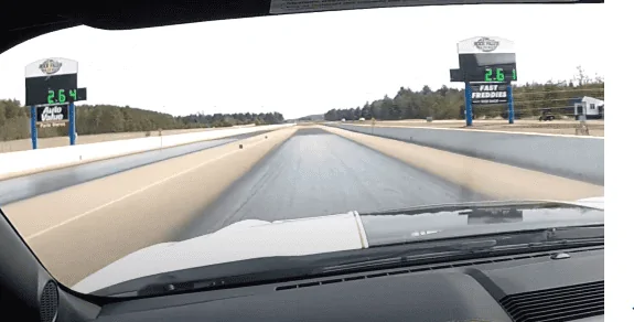

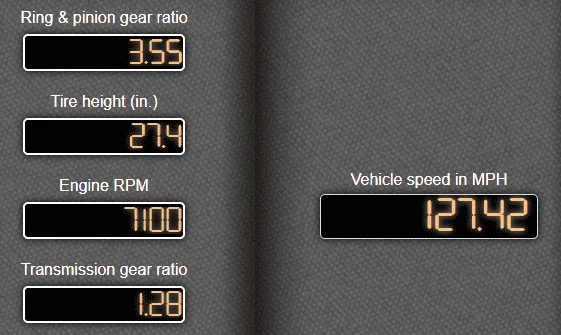

While not 100% accurate, I am calculating that my car shifts from 6th to 7th at approximately 7000-7100 rpm. I base this on the fact that it shifts to 7th VERY shortly before the end of the quarter mile where I reach 129 MPH. The screen shot below shows how close the finish line is when it shifts to 7th. I don't know precisely what speed I am traveling at that point but here is a calculation based on a speed of 127 at the shift point.
