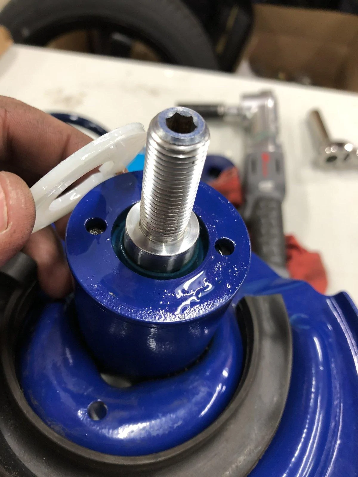

Well I got to the bottom of it, and it ain’t good.
Steeda’s techs were thinking it was the poly bump stops not working at my ride height with their progressive front springs, so having just got the damn thing aligned I went about tearing it all apart again to disassemble the struts and replace the poly bump stops with the OE jounce bumpers (what Ford calls them) since it worked fine before with those and the OE struts.
Good news, it’s not the poly bump stops. Bad news, it’s blown ass struts. Well one is completely fucked (pic attached) and the other will still extend on it’s own and is blowing less oil, but it isn’t long for this world. I’ve got about 200 miles on these and the problem existed from day one. I did not bottom this shock out, the rod slowly dropped down just due to gravity.
I need my car for a trip in 3 days so I have no choice at this point but to put the stock PP shocks back on until I can figure out what to do. At least I know that when I complained that it felt underdamped, that’s because it was.
Oh and as a side note, the rubber caps Steeda sells for their rear shock mounts do more harm than good, trapping fine gravel to sit on top of the spherical bearing and work it’s way in over time. Until I find a better solution I just used the OE caps and duct taped them on so at least it’s sealed.
