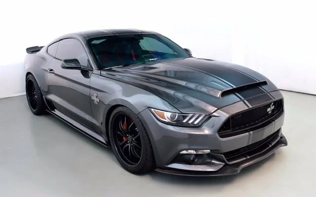

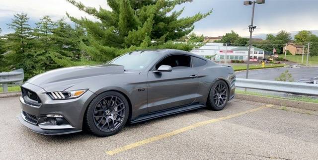

alright guys, so basically I’m running a 255x18 in front and a 275x18 in back. I don’t know what the exact offsets are because the RTR wheels were on it when I bought the car a year ago.
I’m looking to go upgrade to the Shelby wheels, for obvious reasons. I got Eibach lowering springs on it and for 18’s there literally no gap so I couldn’t go 20’s. I could roll into 19’s probably at 275x19x9.5 and 305x19x11.5.
Anyone have trouble running this?

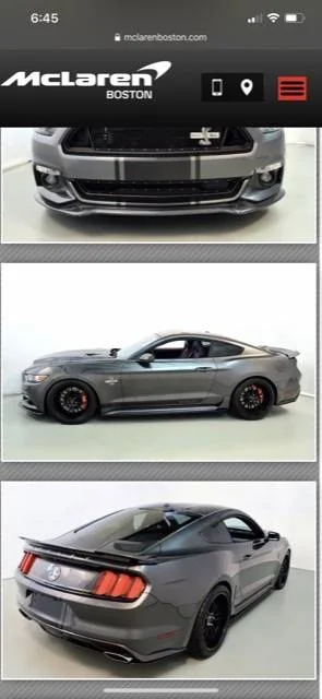

Or anyone have recommendations? Love the deep offset on the rear, makes the car really standout. Want to replicate that look.

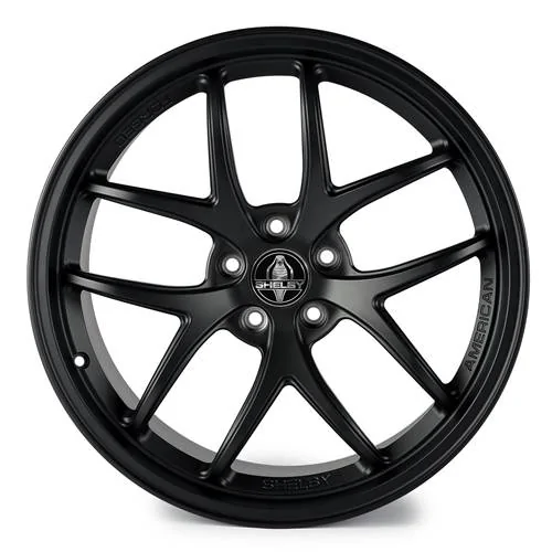

Are you looking for these supersnake wheels? btw the wheel gap can stay the same or close with a 19 or 20. its all about the tire height not the wheel size.
