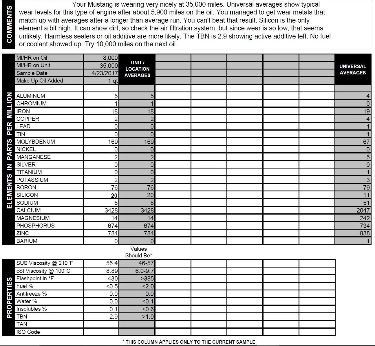

Changed my oil after 8k miles with Amsoil SS 5w-20 (longest I've ever gone on an OCI - made me nervous). Sent in for Blackstone UOA. Here are the results for your viewing pleasure:
I politely beg to differ with that analysis, your silicon is needlessly elevated and is wearing internals. change that air filter. Your wrist pins are taking snagging on that cylinder wall. You have no idea where the acid sits on this oil, nor how much active additive you have left. No idea on the air/fuel ratio this engine is running or how much life is left on it. I would not push this oil to 10k without knowing what's really happening.
I love when Blackstone says no fuel or coolant. As if they are actually able to test for it.
