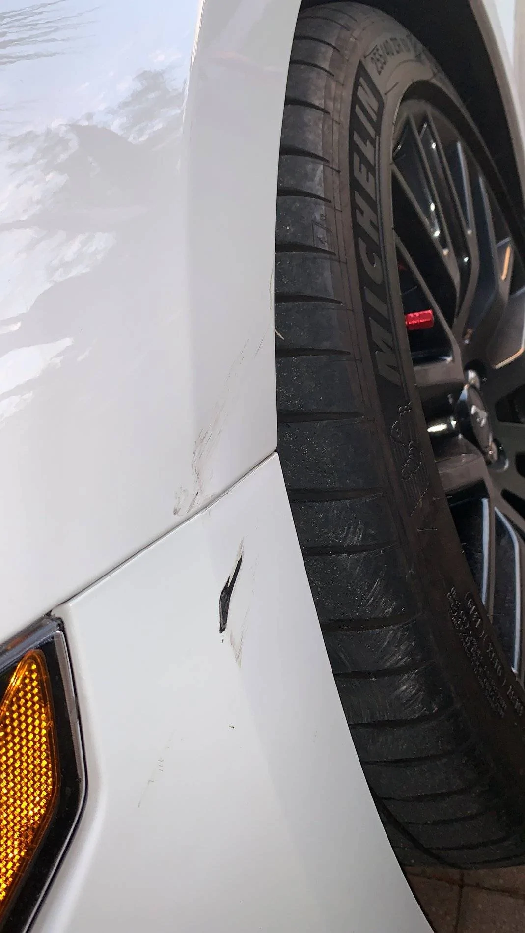

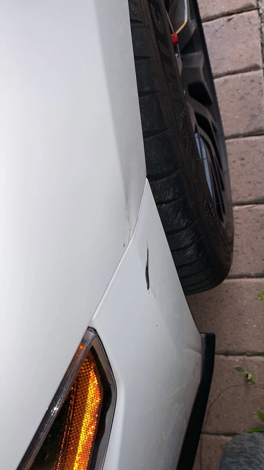

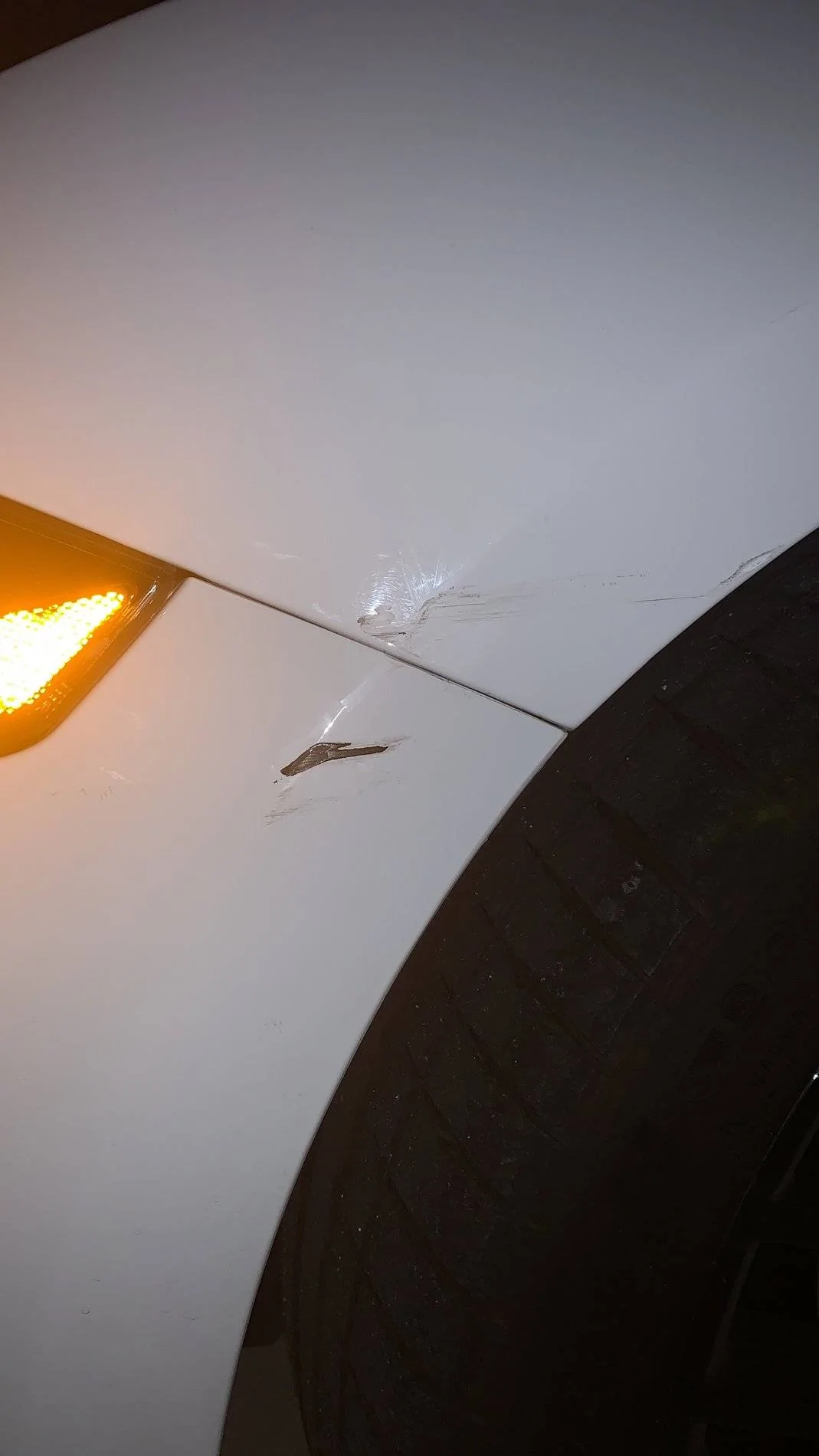

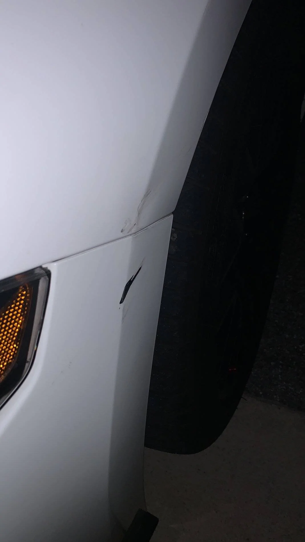

Hi, so someone scraped and slightly dented my fender and bumper on the driver's side where the two panels converge they took off which is good because then I can just pay cash and its all good so no insurance, its very minor damage and I was quoted 1300$ by caliber collision which seems outrageous for what it is, does anyone know a good body shop in palm beach county FL or have any suggestions on what to do I attached some pictures below any help is greatly appreciated :)

Research a local PDR guy to you and read up on the reviews. The PDR guy will be able to get that fender damage fixed back to new for far less than a body shop. Probably about $200 for that type of repair.
The fender will look like it was never damaged but the paint work will need a touch/blend. That’s when you just need body shop for that area of the fender and the small damage on the front cover.
If you do the PDR separate - the body shop repair (which is very easy from your pics) should be around $500 +/- for merely a scuff, prime and blend of a very common color (white).
If your paint was 3-stage like many of the S550 metallic impregnated paints, you would be looking at a more costly repair for the paint fix.
Before any work is performed - get yourself a bottle of this Meguiars product:
https://www.meguiars.com/automotive/products/meguiars-ultimate-compound-g17216-152-oz-liquid
Apply it to the whole area affected. Use a microfiber pad to apply; use some pressure and buff it using manual hand method OR use a mechanical buffer if you have one. Use a micro fiber to remove the product. You’ll be surprised that it will look 100% better afterwards. The Meguiars product will remove the surface scuffs and level out the finer damages.
At least it will look better until you can get it fixed.

thank you so much this was just what I was looking for, I found a guy that does mobile PDR and he said he'll do it for 300$ because he has 20 years of painting experience and just branched off from another company to start his own. He also said he can do it in 2-3 hours using ppg nexa aqua base and curing is about an hour, does this sound right?
