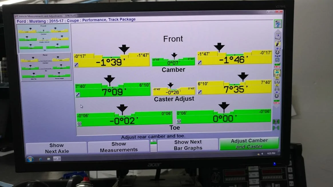

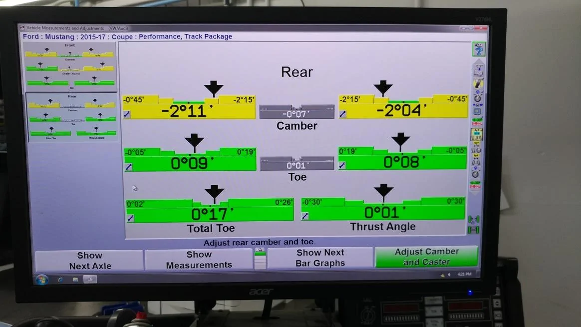

Here are my numbers from a month ago with our Hunter Hawkeye Elite, you can see the min/max and just guess on the center. These are after my Eibach Pro-Kits were installed.

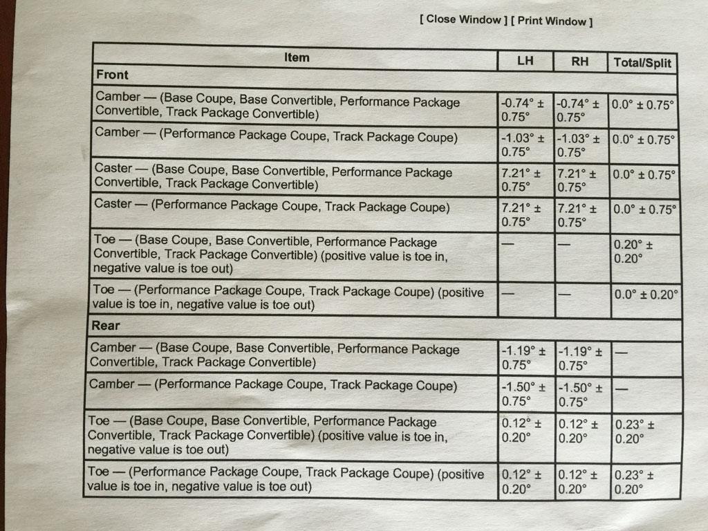

Here is the list for factory alignment settings

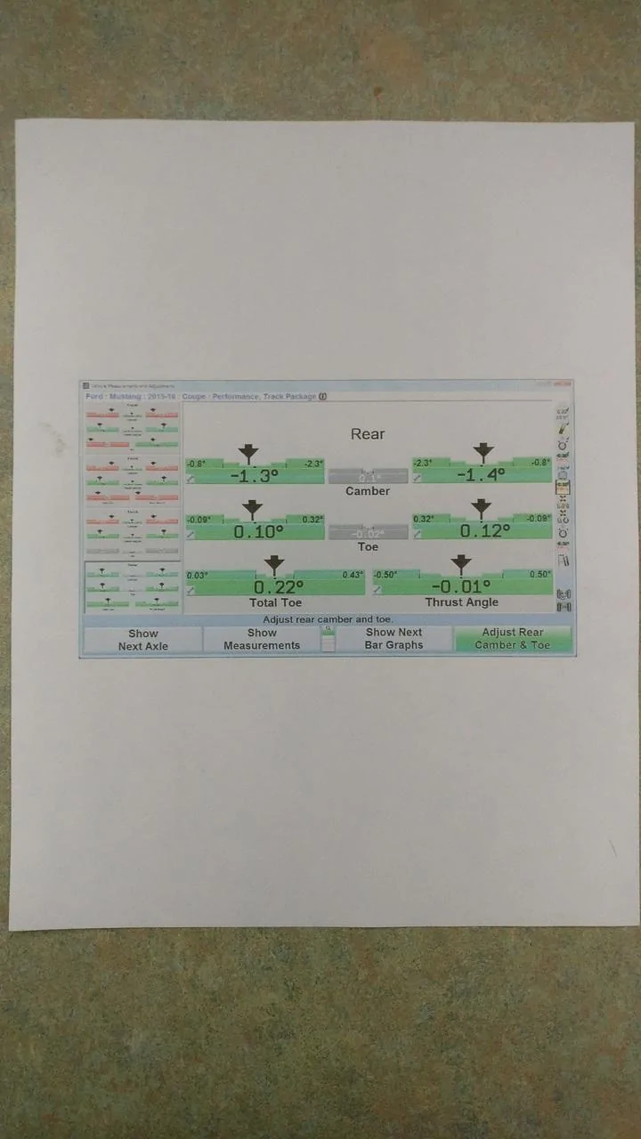

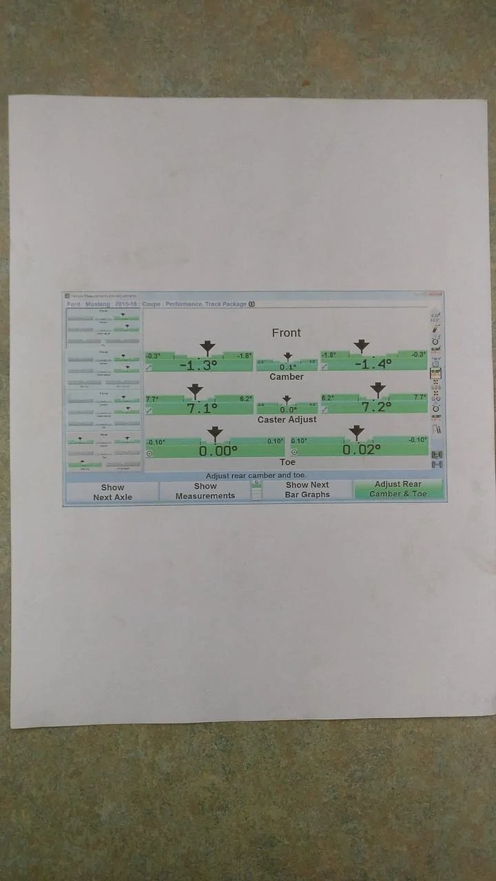

Hi guys,
did the alignment today with Steeda recommended values.
