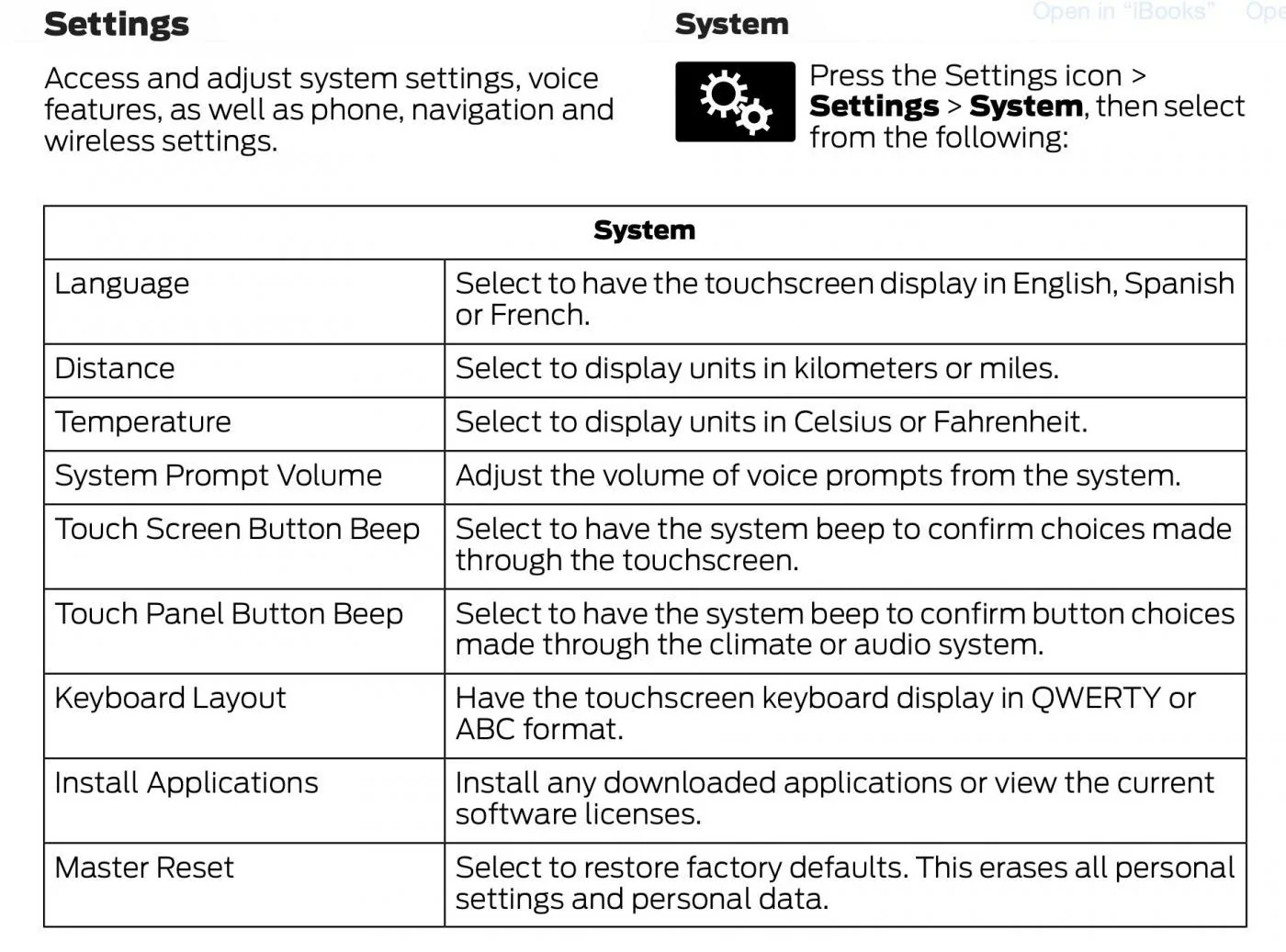

My service manager showed me how to "master reset" the computers today. I don't remember the exact steps offhand, but I remember it was easy and the instructions on the screen walk you through it. (I would imagine all this is in the manual.) You press several buttons and you're done. (Ford sends updates to SYNC in this menu as well.) Your contacts aren't lost, either; all you need to do is pair up your phone to SYNC again, if applicable.
No battery disconnection needed. :D:thumbsup:

Settings, System, Master Reset
