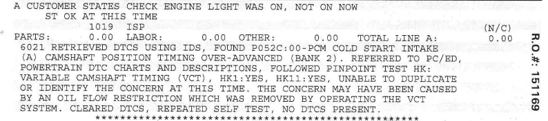

I was at a track day and mid-session my check engine light came on - starting blinking and then turned off and did not come back on again during the track day. Thrown code was P052C (see pic below). Below is the feedback from the dealer. Code again showed up this past weekend and again went away and in a subsequent session the code did not show up. Is this something I should worry about and/or press the dealer to do more or is this something that people experience where a code or two might flash under hard driving, but issue is only temporary and should only be a concern if the check engine light remains on (or remains flashing)? Thank you for your thoughts.

I think some have had wires break on the plug to the vct solenoid. Yours might be ready to break.
Good luck
