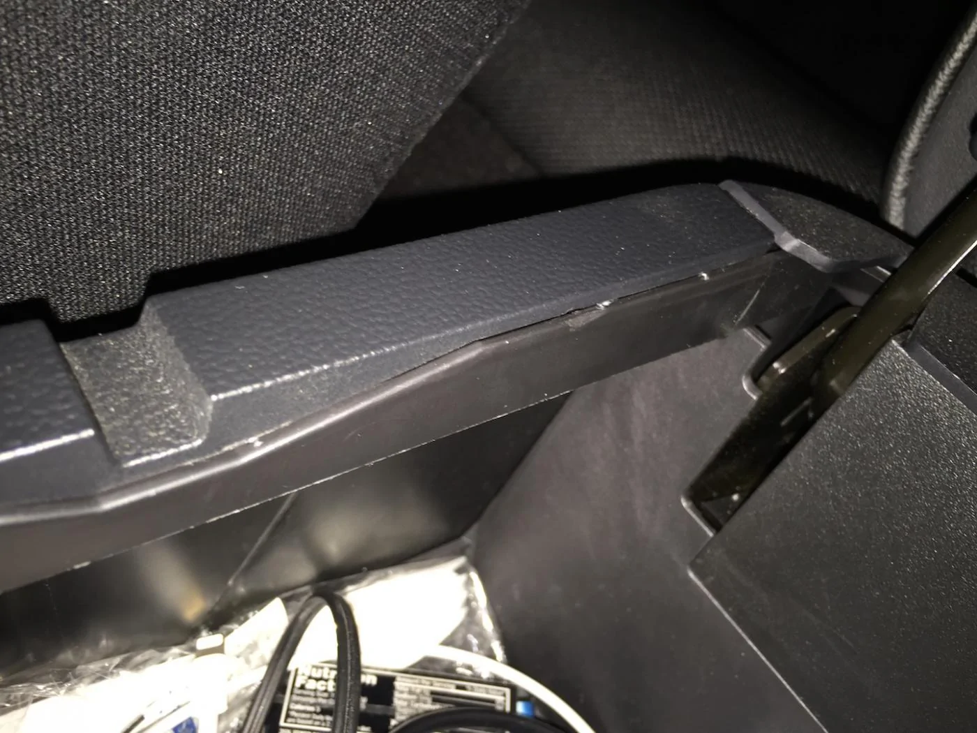

Start here. Use a flathead to get in between that panel line and pull up. Do this on either side and the clips will start to release as you move forward.

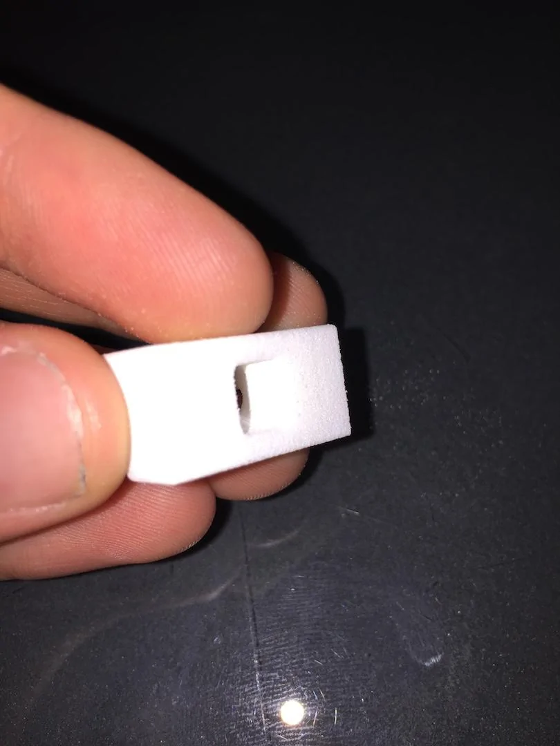

Also, I highly suggest you sand your transparent buttons down about .5mm. Since you were the first to order you received the longer buttons. They will work as is but better toggle feel will be achieved by sanding them.

Which area of the transparent should I sand down ?
