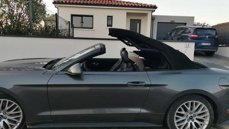

Hi friends, last mount I lived an amazing moment, my convertible top was stuck half open during the closing procedure.
I don’t have any idea about the root cause of this problem, and I need your help to understand what the matter (and solved it :like: ).
This is what it was. Last month my car was parked convertible top open. I installed my baby on the back seat, turned on the car engine and push the close button. Halfway, my baby began shouting out. I stopped the closure sequence to see what the matter (nothing, he was just afraid). But, when I retry to push the close button, nothing, no motion, no message …

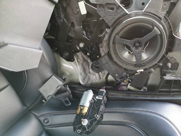

Next, to close the top, I removed the two electrical engines and I closed manually.

  • When the two electrical engines was removed, no mechanical trouble, and no rotation on engines when pushing open or close button.
My opinion is : The problem is not mechanical, I don't think it is electrical. It's look like the computer car dosen't want to allow the convertible top movement. Perhaps a sensor problem, or an internal condition not solved ...
For the moment, I haven’t gone to FORD France, I prefer understand what the matter before.
Can you help me, do you have an idea about this problem ?

No, I'm not resolved my problem. I keep information about electronic wiring and the i fund the maintenance manual. This is very interresting.
The convertible top system is composed of 2 calculators. One calculator on each motor block. Therse two calculators are connected to the CAN bus and connected to the open/close button.
With this new informations I made new test and it is possible that one calculator dead.
So now I have to use the CAN bus to speak with this two calculators and see if i have answers (and read error codes). I have an ODB dongle but I don't have software who can adresse other calculator than ECU (If you have a software name, I'll take it)
