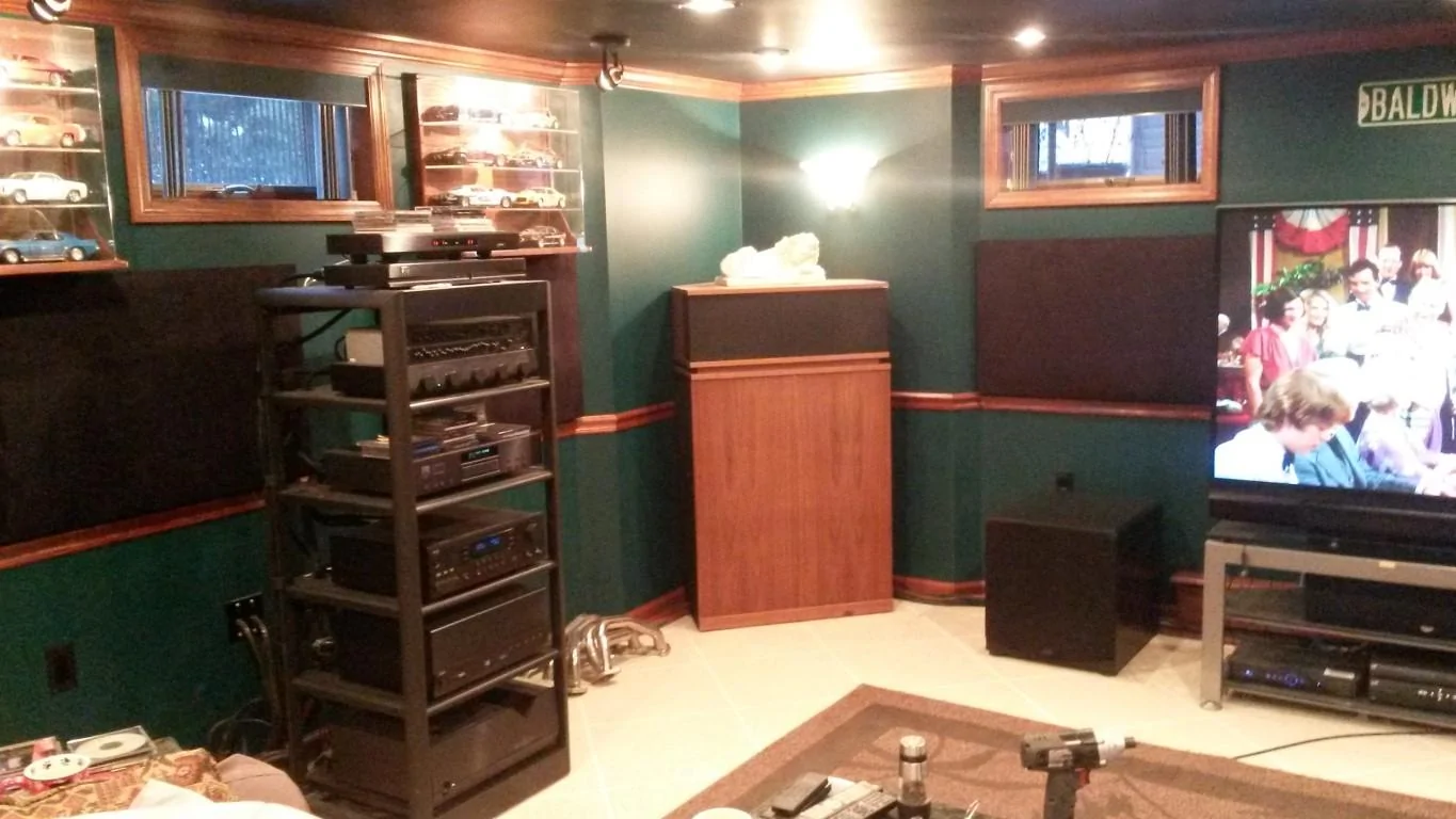

    Here is a picture of my Basement theater.All Klipsch 7.1 with Klipshorns as the front mains.

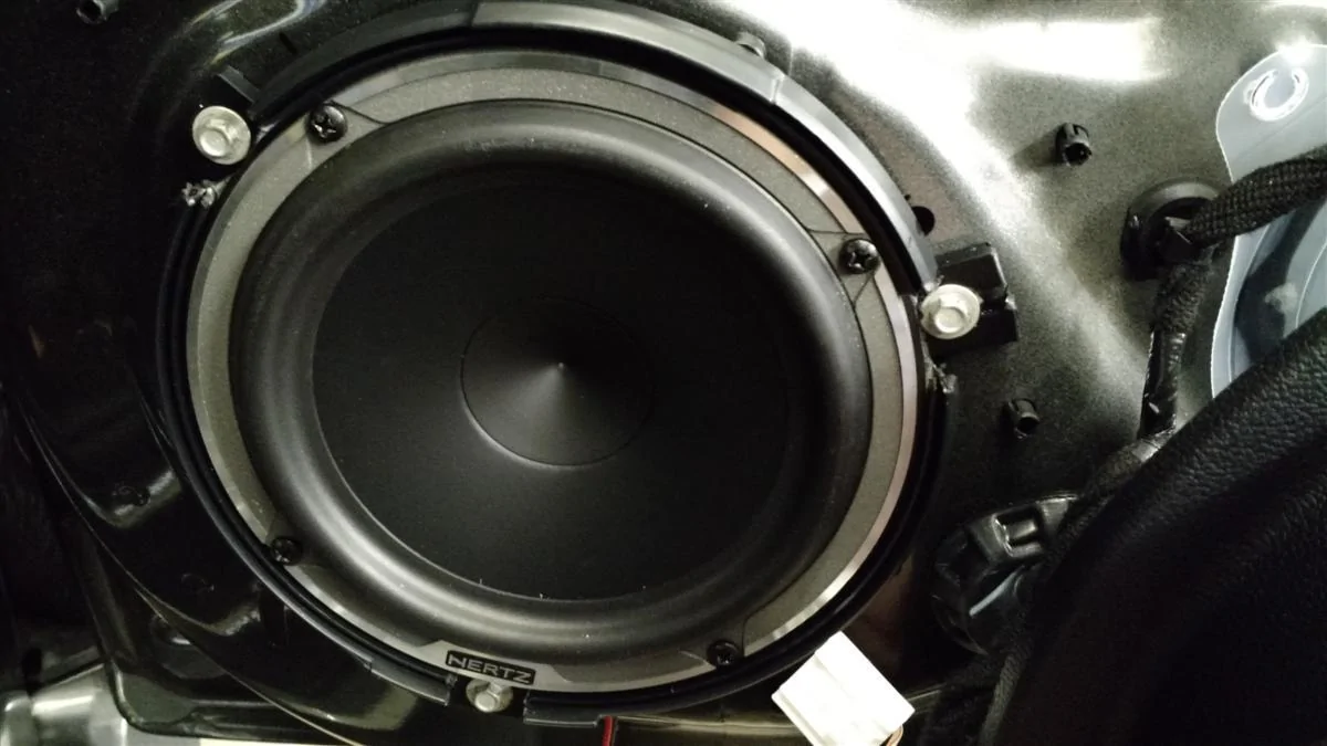

    Did you replace the factory 6.5" grilles because you wanted to or because the Hertz wouldn't fit behind the stock grilles?

    The Hertz wouldn't fit by themselves in the door panels, the hole was too large. So I had to cut and dismantle the factory speaker mount and secure the Hertz speaker to that.
    Because of that, it did fit, but the speakers would hit the door panels when the volume was turned up and they started moving, even when I cut most of the bass going to them.
    I probably could have solved it by making my own mounting rings but I just didn't want to go through that. So instead I cut the door panels and attached the Hertz grille to them. Unfortunetly for me, Ford did not put the speaker grille where the actual speaker is, it's slightly off center. So the grilles had to be surface mounted to the door panel rather than screwed to the speaker like usually done. It doesn't look horrible, but I'm not thrilled with the end result. Definitely the weakest cosmetic link of the install.

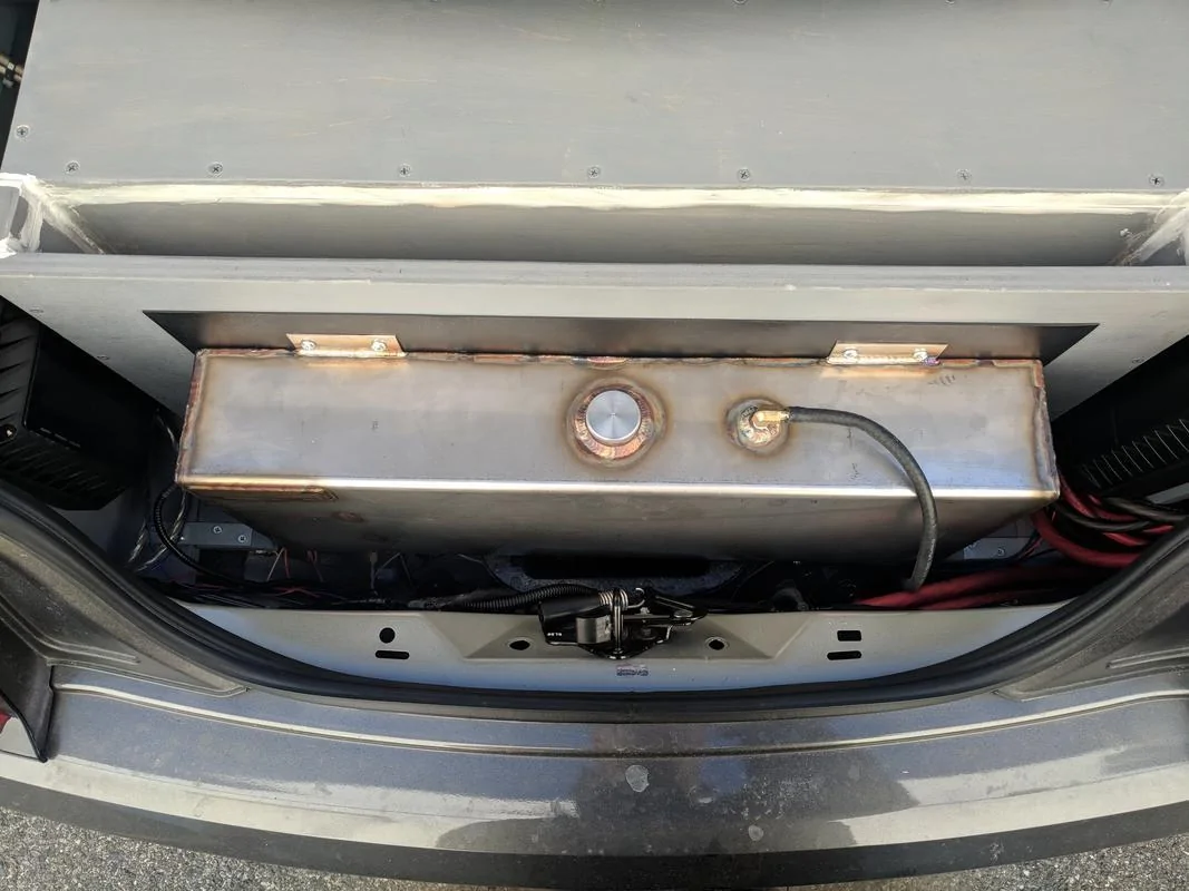

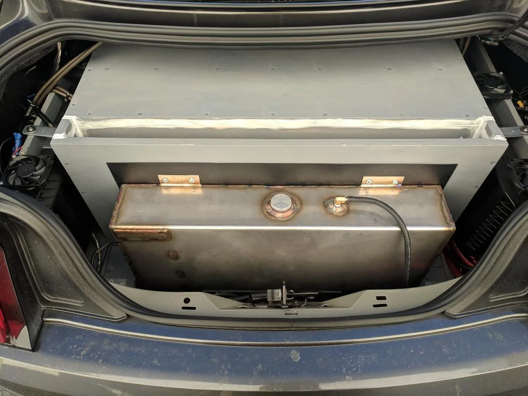

    Also, figured I'd post the final pics here with my Methanol tank mounted. To explain what that space on the back of the box was for.
