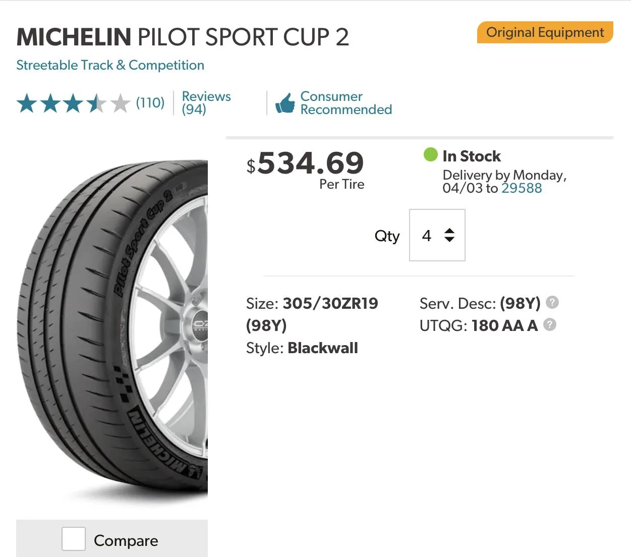

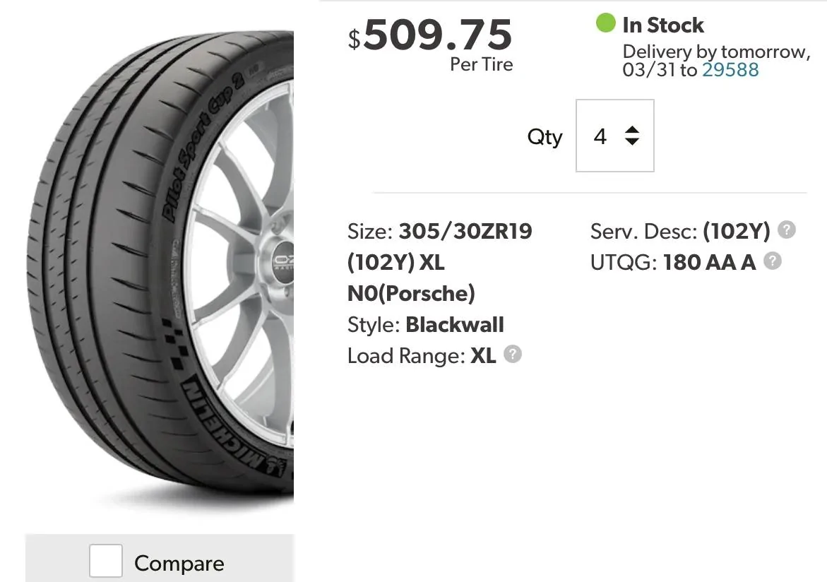

Yes, the PP2 does run a square setup. Tire Rack does, in fact show two different Cup 2 tires so having two different ones could make a difference.
kz
Oct 26, 2014
4,627
2,943
West Chester, OH
Mustangs & F150
Yes, the PP2 does run a square setup. Tire Rack does, in fact show two differential Cup 2 tires so having two different ones could make a difference.
It's not about two different specs (which could be different and Michelin is notorious from having a bunch of different OEM spec tires) but just purely wear on the tire that stays and no wear on brand new that replaces the damaged one - that where the tread depth / height / whatever you call it difference comes from.
