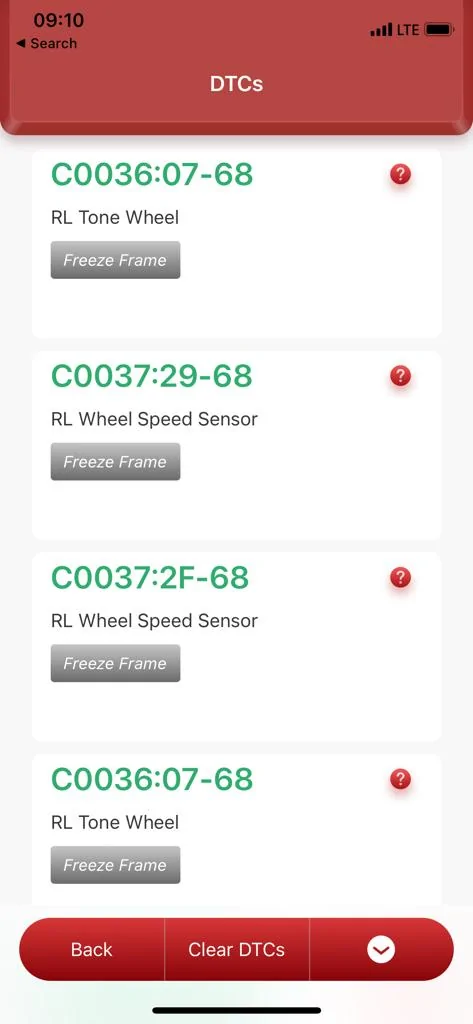

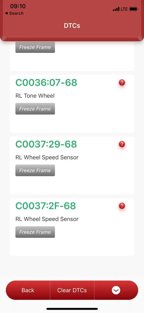

Hello everyone , i have problem with ABS in Ford Mustang GT 5.0 2017 . it writes me every ride. the sensor does not appear to be damaged. Can you please advise what it could be? Thanks

Wheel bearing, sensor, or wiring issue.
The sensor reads a magnet inside the wheel bearing. You can swap the sensor from right to left. If the codes stays on the same wheel after the swap, replace the Wheel bearing/hub assembly. If the code changes to the other side of the car, replace the sensor.

thank you very much for your willingness, I will try it tomorrow and let you know
