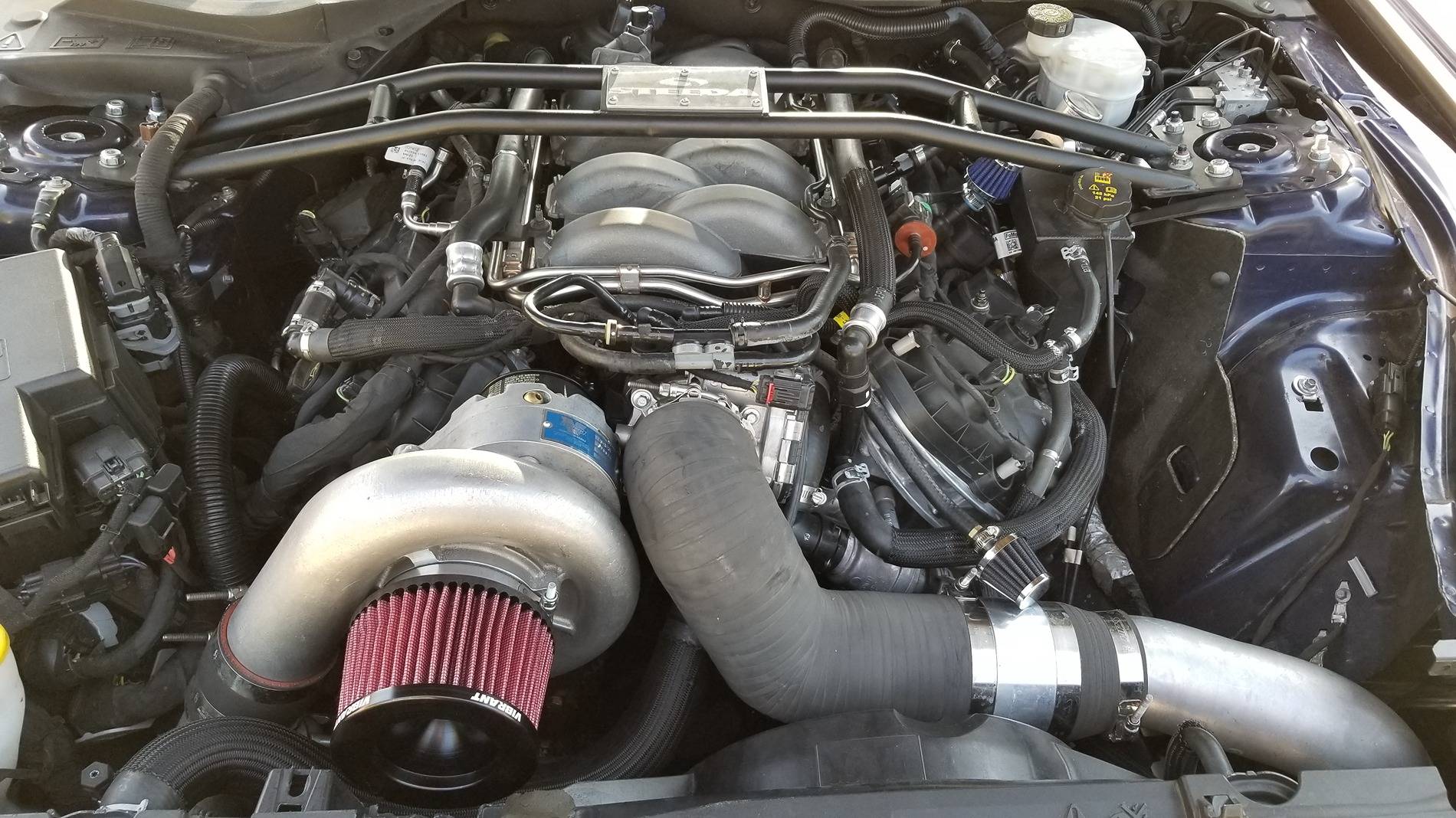

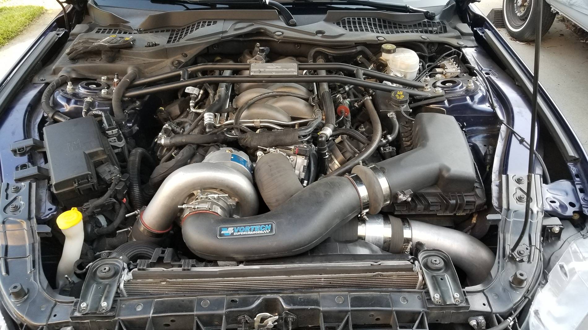

I lost .15 and 2.5mph with a filter on the end versus the factory elbow and airbox with k&n filter. Took the elbow off and Picked up .2 and 3mph. Put the inlet bell on and it was minimal, like .03 and .5 mph. That was with the 3.6 pulley on a Vortech V3Jt
On the dyno with my new engine and a 3.3 pulley, the stock airbox made 88hp less than open blower. I forgot to bring the bellmouth with me, so I don't know how much horsepower difference there is with bellmouth versus no bellmouth with the smaller pulley.

Vortech is a bit different as the blower sits more on the middle, ess and procharger sit right in front of the stock airboxes air ducting for cold air. I know no filter is best but i daily so i need a filter, was just playing with the idea of the filter on the supercharger for noise and effeciency but i dont believe the filter can be big enough to be better than the stock bent tubing

I drive around with my stock airbox. More than enough power for the street. I even leave it on when I race Buttonwillow or Willow Springs, just in case I end up off the track. Lol
Unless you're really worried about racing the car light to light just put the filter right on the end. I used a vibrant one
