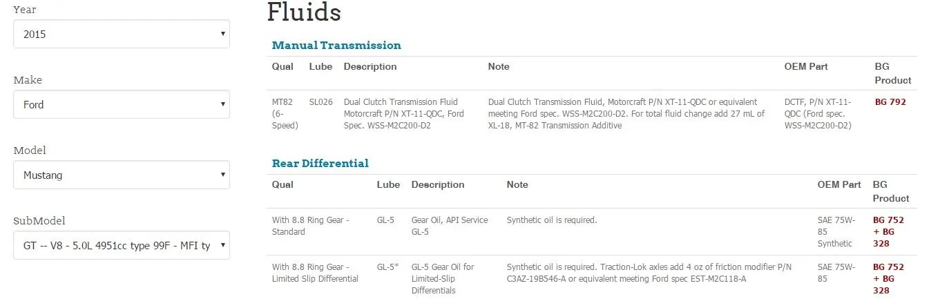

I understand but We have discussed it at length on several threads. I have posted two of the more recent ones here.
BG ONLY Recommends Syncro Shift II in the MT82 Transmission.
HERE
More HERE
It works better than what Ford uses, and the biggest market for BG is OEM dealers.
To add to this my BG Rep actually just set up a new Ford Dealer in Florida and actually sent him the second thread above to help explain why they needed to stock Syncro Shift II for the Mustang :)
