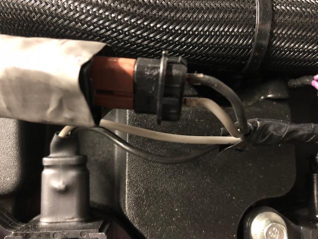

Finally was able to get to the car and start putting the JMS LaunchMax & MSD 2-step in the car. My car was built in March of 2016 and has the new coil packs/wiring. [MENTION=25680]Bkingnorth[/MENTION], so what did you do? did you trim both plugs so the MSD harness will fit into the coil pack & the OEM harness???

Go with the nb2b. Think it's a five wire install. You can splice plugs but why do all that splicing if you only have to do five or six. (Can't remember exactly)

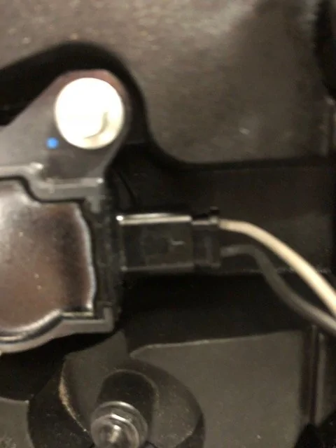

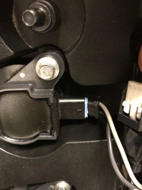

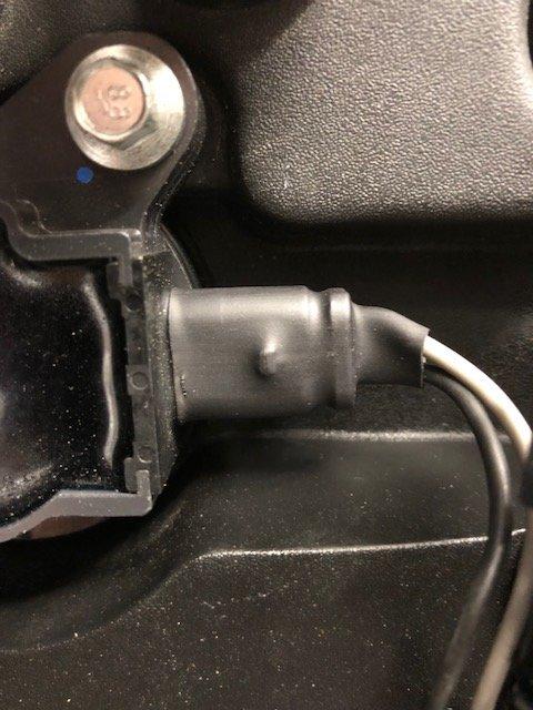

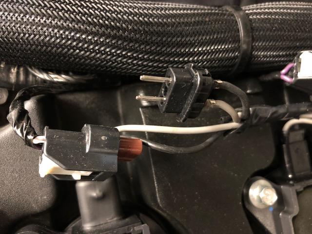

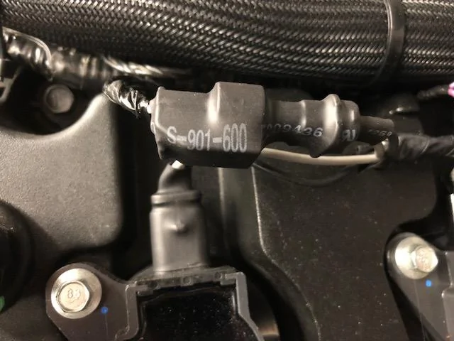

Just like so... disassembled the plugs from the MSD harness.

Could u also get the coil plug connectors from a 15 and pull the pins out the newer plugs and re pin them,same amount of wires.

32 spliced like that, each with a potential to go bad.
No thank you, and I can wire the fuck out of anything.
32? There’s 8 coils and 8 harness terminals. Actually, the terminals fit so tightly I’m not concerned a bit. But, I guess I can’t “wire the fuck out of anything “
