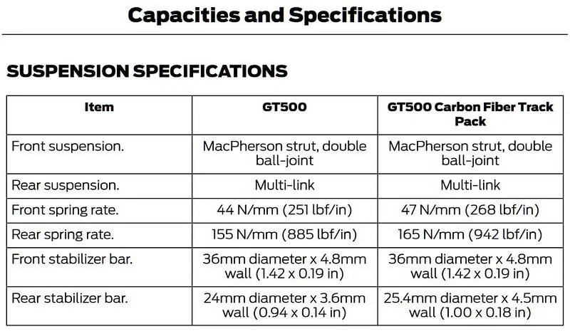

Surely they mean BASE BASE - not track package. I suspect the track package gets a lot of the same hunkered down suspension parts that they CFTP gets.
Outside of the aero and wheels/tires isn't the underlying suspesion the same between base, TP, & CFTP
Epiphany
Oct 11, 2015
77
7,962
13,597
Global
I like to disassemble things.
There are spring rate and bar differences between the two. Handling Package and Base without it look to use the same suspension hardware as one another.
protraxduner
Jan 22, 2018
939
693
OK
2020 Shelby GT500 Race Red
Good to know! Thanks I hadn't seen that. So the regular track package gets the base springs and bars? They really should have added a third column for Track Package, but probably didn't want people to know its the same stuff as base.

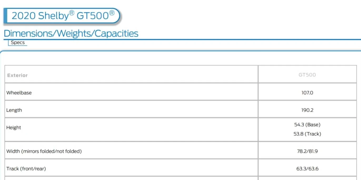

Found the height difference in the eSourcebook from Ford.
Epiphany
Oct 11, 2015
77
7,962
13,597
Global
The wickers have no effect on the ride height numbers from Ford. Do they reduce ground clearance? They do.
Ride height difference comes from either the different springs (Base vs CFTP), a decrease in tire diameter (Cup2 vs 4S), or a combination of the two.
