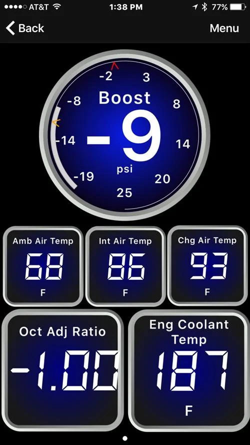

I hear you. All I can do is look at the data that I have and reference that with the physical experience behind the wheel. Not sure if your familiar with the Track Addict app, but it allows you to record vehicle data, and GPS data, on top of the in car video. I have replayed the laps watching all the vehicle parameters real time as I was lapping the track. I can say with 100% certainty that the engine was producing full power/boost all day long with coolant temps shown in the 230s. Now, I assume that what TrackAddict is receiving via the OBD II interface is the actual coolant temp. It behaves as you would expect during the course of a lap, i.e., moves up and down a bit based on power demanded. But, I didn't program the ECU or Track Addict. Again, I am intrigued by the fact that the factory coolant temp gauge was not way over to the right. Since the factory t-stat is 180 deg, one can assume that the middle of the gauge is somewhere close to 180. If the temp was actually 230+, I would sure as heck assume that the gauge would reflect something on the hot side?
Here's one theory. Maybe what Track Addict was displaying as coolant temp was really cylinder head temp, i.e., a translation issue between the ECU and Track Addict? I could see the CHT hovering in the 230 range more so than the overall coolant temp.
