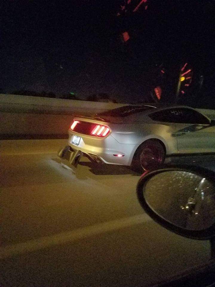

Yup forget that diffuser this was my buddys car last night!

2016 Oxford White EB
That looks like catastrophic fastener failure. So now we have one completely shatter and one become detached. I really want to hear about a remedy from MMD/AM on this. Starting to think mines a time bomb. I just hope I don't lose one day and get to work and its not there.
