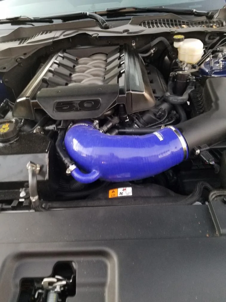

got mine installed. helps the engine bay look much much better. what drop in are folks going with? mainly looking to know about dry or oil or just use the stock one. no tune yet, but coming later this year.
Mishimoto coolant tank going in next. engine bay is coming along.

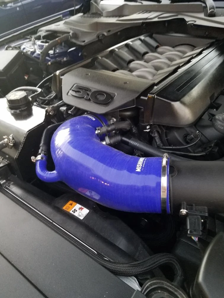

installed :coolphotos:

Much of a diff to the Airaid one gameovergt?
I think it makes more noise from the engine which is cool, exhaust note seems to have mellowed out more. Not sure on anything else as I have not done any WOT runs yet.

the engine bay just looks better with the oem tube and sound tube gone. love it.
