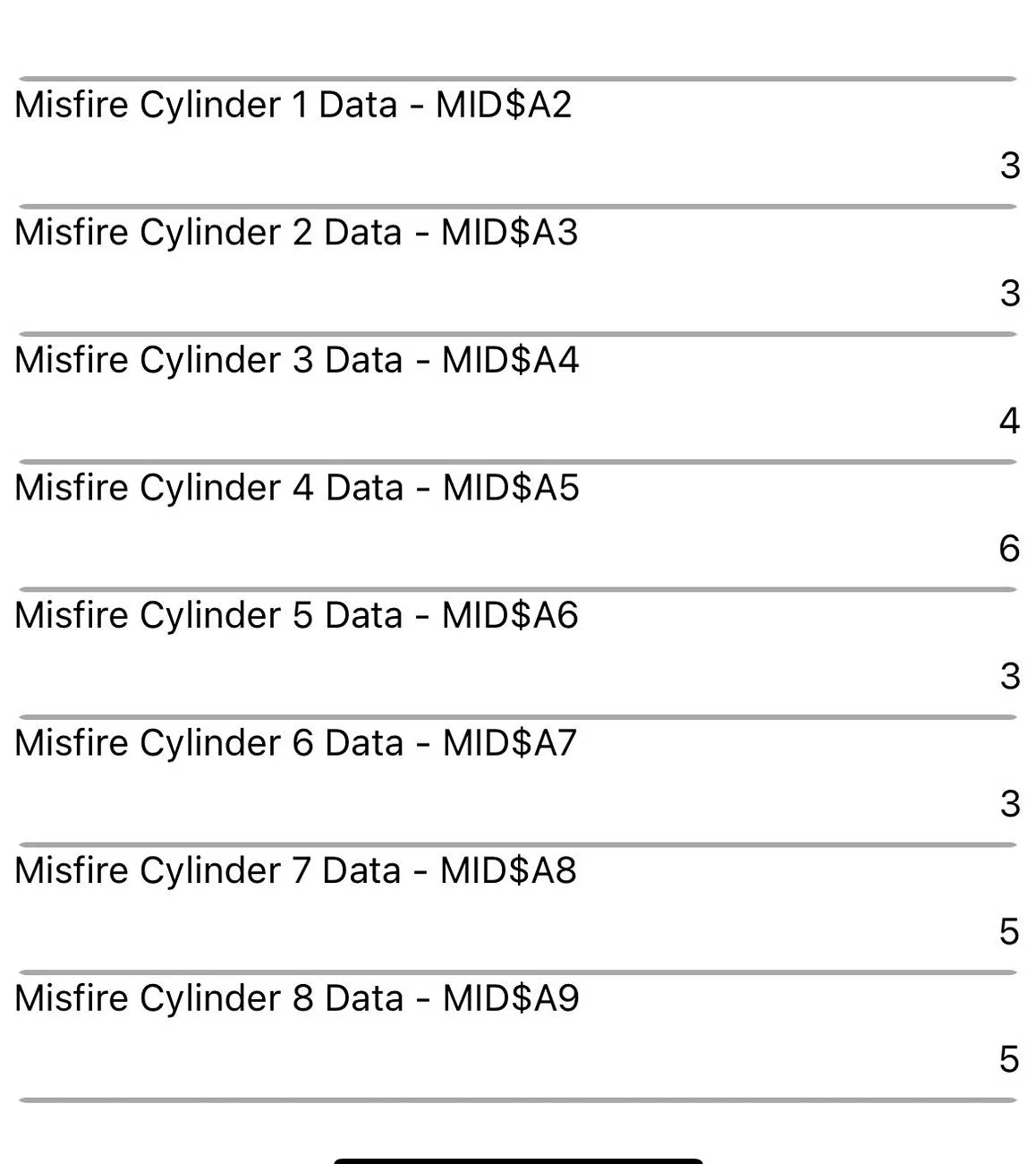

I have attached a photo of the misfire cycle during a 30 min drive in my 2020 Bullitt and I trying to trace a problem.
are these number of misfires within spec for a 30 minute drive cycle ?.
Just wondered if it’s pointing at something wrong ?
thanks

At least I now know looking at those cylinders that it’s not a bad injector, spark plug or coil. Because they wouldn’t all be missing which probably leads me to fuel pressure or Fuel pump ??
I have been driving the thing to almost empty for the last 4 years and probably put a lot of pressure on the fuel pump. Is their a way I can log the fuel pump to see if it’s healthy ????

OK, Let's try troubleshooting 101, Have you done anything to the car lately??
Since it's calling out all cylinders, I'd check the Crankshaft Position Sensor.
Try a Crank Relearn ..

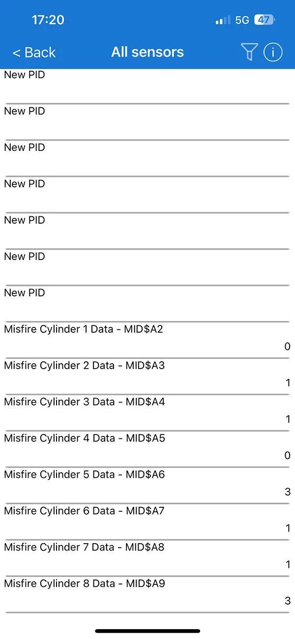

So this problem has been haunting me since new from 2020.
One day running ok but not quite right. A little stumbly during low rpm driving but doesn’t seem happy.
suddenly next start up it’s as smooth as silk and runs amazing exhaust note even sounds really strong.
reinstalled tune the other day and yes I did a crank relearn.
the image I sent was when in my opinion it’s not running at its best…..
But after stopping and re staring the engine check this out…
Still misfires but much less. The car is pulling really hard and low rpm is smooth and refined.
I guarantee tomorrow it will be back to rough again.
