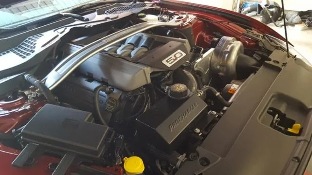

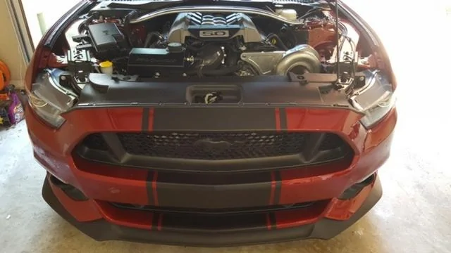

Well, the physical part of the install is done, just working on the remote tune with Lund now.
6 hours for the install according to Procharger, well, I guess if you've already done a half dozen or so, LOL! But, it wasn't bad at all, actual "hands on time", well, probably about 8 hours or so.
A couple of tips for anyone that is considering this kit:
- I was concerned with the radiator hose being pretty tight up against the fan housing after installing the hose adapter. This is actually alleviated further into the install with new radiator brackets that will pull the radiator fwd about a inch. I'd think that Procharger would have this as a note in the instructions.
- I mounted the horn to the inside of the spot that Procharger showed, much simpler to make the electrical connections.
Like I said earlier, still working with Lund on the tune. Up to Rev 4 and datalogging WOT pulls, 2500-7200. Still a little choppiness down low but above 4K, pulls like nobodies business.
