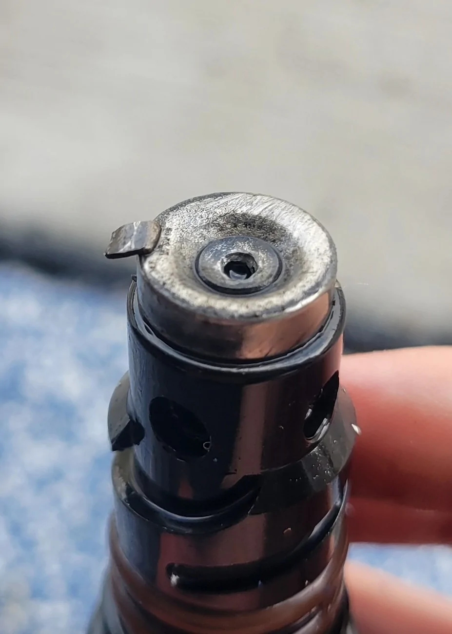

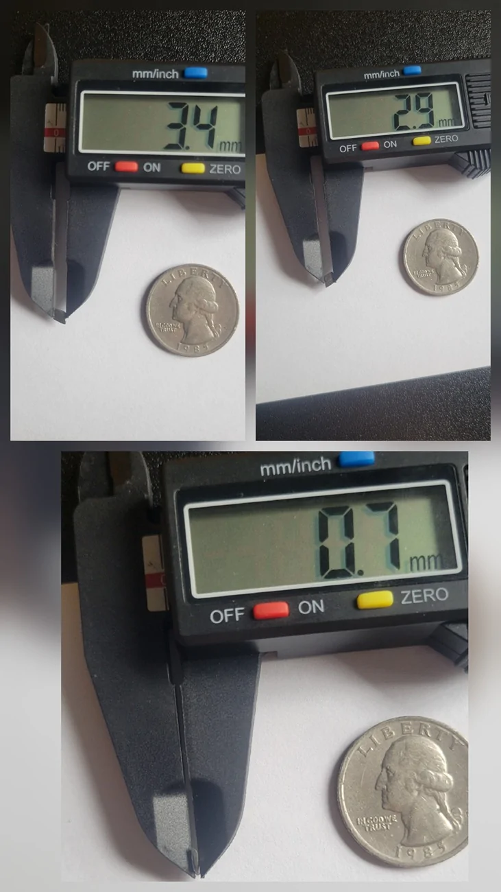

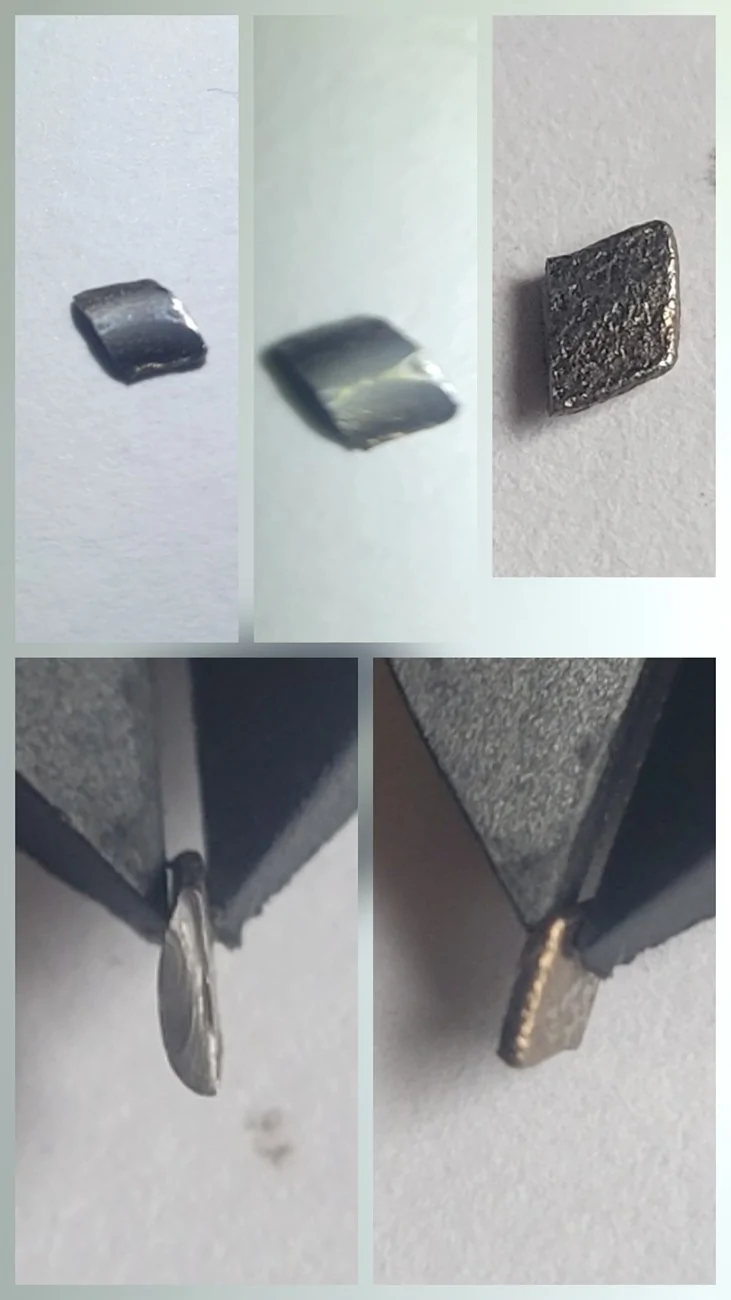

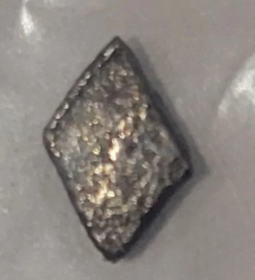

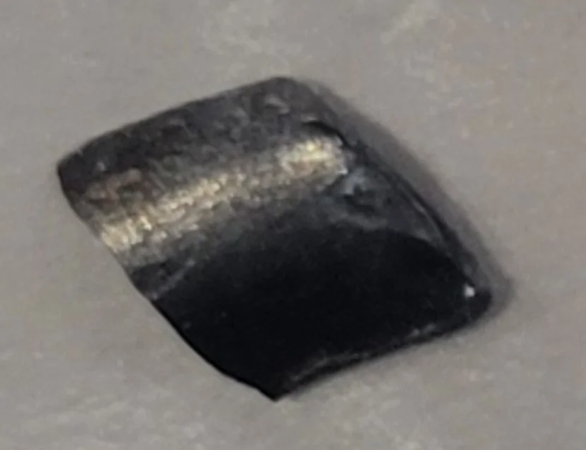

Found this today. Any clue what it may have come from or how much I should be worried? First oil change w/ the magnetic plug (clearly worth the money), so I'm not sure if this is a new issue. I found it odd that the piece has 4 relatively straight sides, a flat back, and half round top. I happened to save the filter from the last oil change. I cut both open, and there's a few slivers and a little glitter this time, but not much. nothing notable in the older one.

Hello; There is another thread active currently. In that one the consensus seems to be a broken sprocket tooth. Your picture is some different from the other picture.

can you point me towards the other thread?

That other thread is unfortunately my car this is what i found during my oil and just like sk47 if you start seaching you will find loads of people with the same issue. My car is still under warranty so its going to the dealer on the 24th. Not sure of you have warranty or not if you dont id start with getting behind the timing cover and checking everything there. Sorry this happened to u as well its such a shit feeling best of luck

warranty ended in March of this year lol. ugh, what a shit show. car blew out the clutch at 4k miles, too.

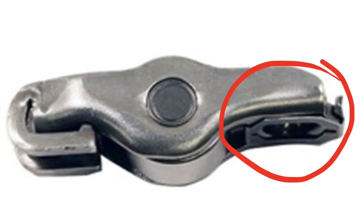

Your piece looks the the end of a rocker retainer clip. Some break occasionally when they See high RPM.

that tracks. car tends to see the upper end of the range quite often. thanks!

It doesn’t look like a cast or machined part, but rather a bent / formed part.

I would've thought the opposite from the pitted look of the first close up
from the looks of how thin that is, I would be looking at something like this area. Not sure where else this type of metal might be used in the engine however…
ah, good call. in the doomsday scenario that this is the issue, what would be your protocol (or anyone else's that wants to chime in)? are you pulling valve covers to check, or letting it go another year and checking if any other pieces come out? oil analysis (it's all recycled now)? if this is the issue, is it just a new rocker? or cams, too? or even more than that? I'm a novice mechanic, at best.
