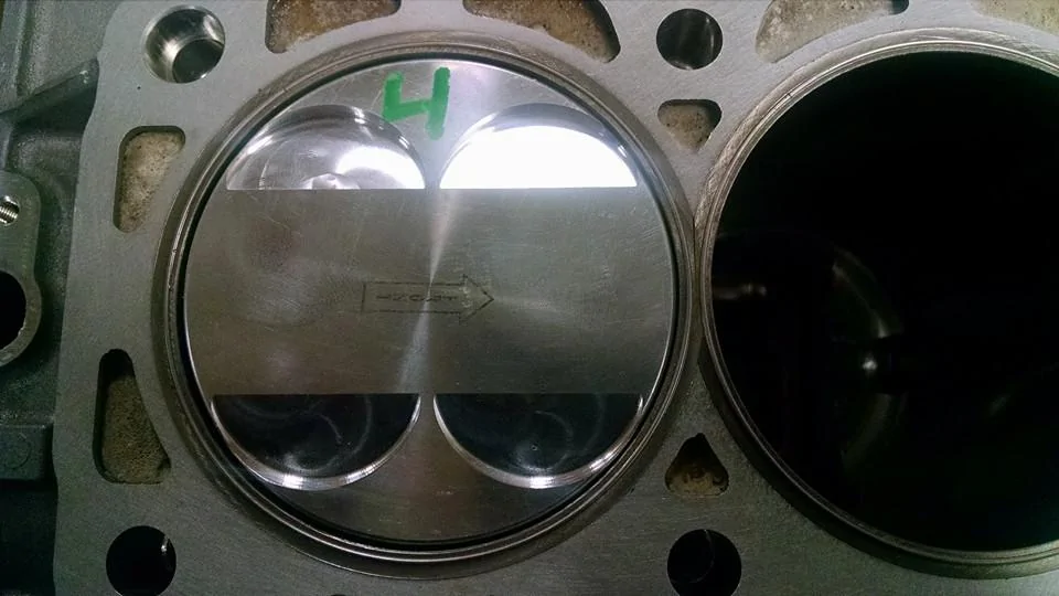

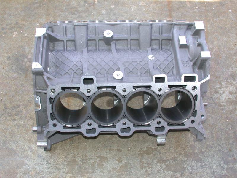

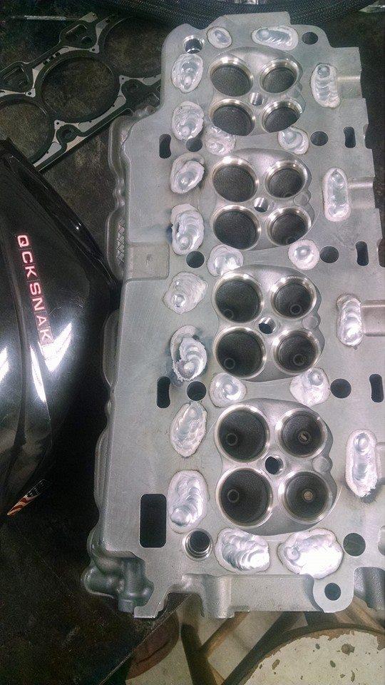

There are plenty of shops that do full fills on the blocks and dry deck the head. Its just not streetable. Here is an example from MPS:

Cool. Seems like I heard of MMR filling their race blocks after they sleeved them. But I didn't know a lot of shops were doing it. Any idea what kinda power they are making with full filled blocks?
Like I said before, I would also like to see a coyote with coolant holes in the block filler.
