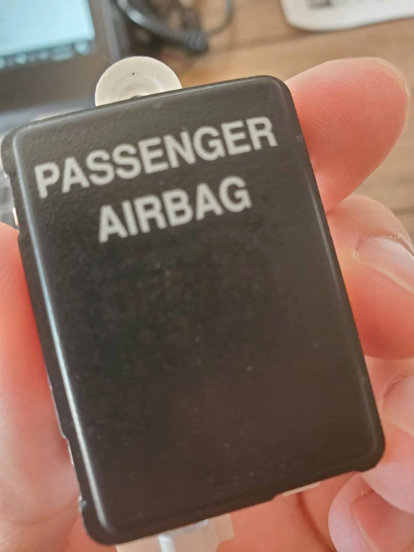

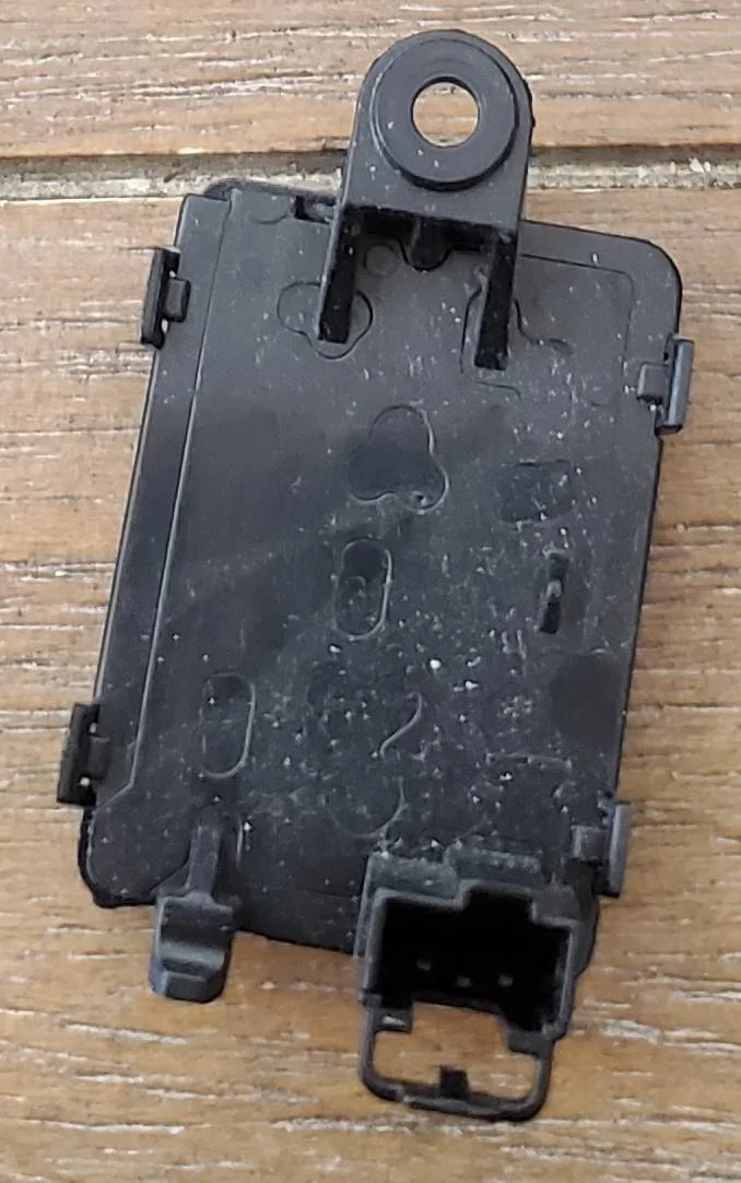

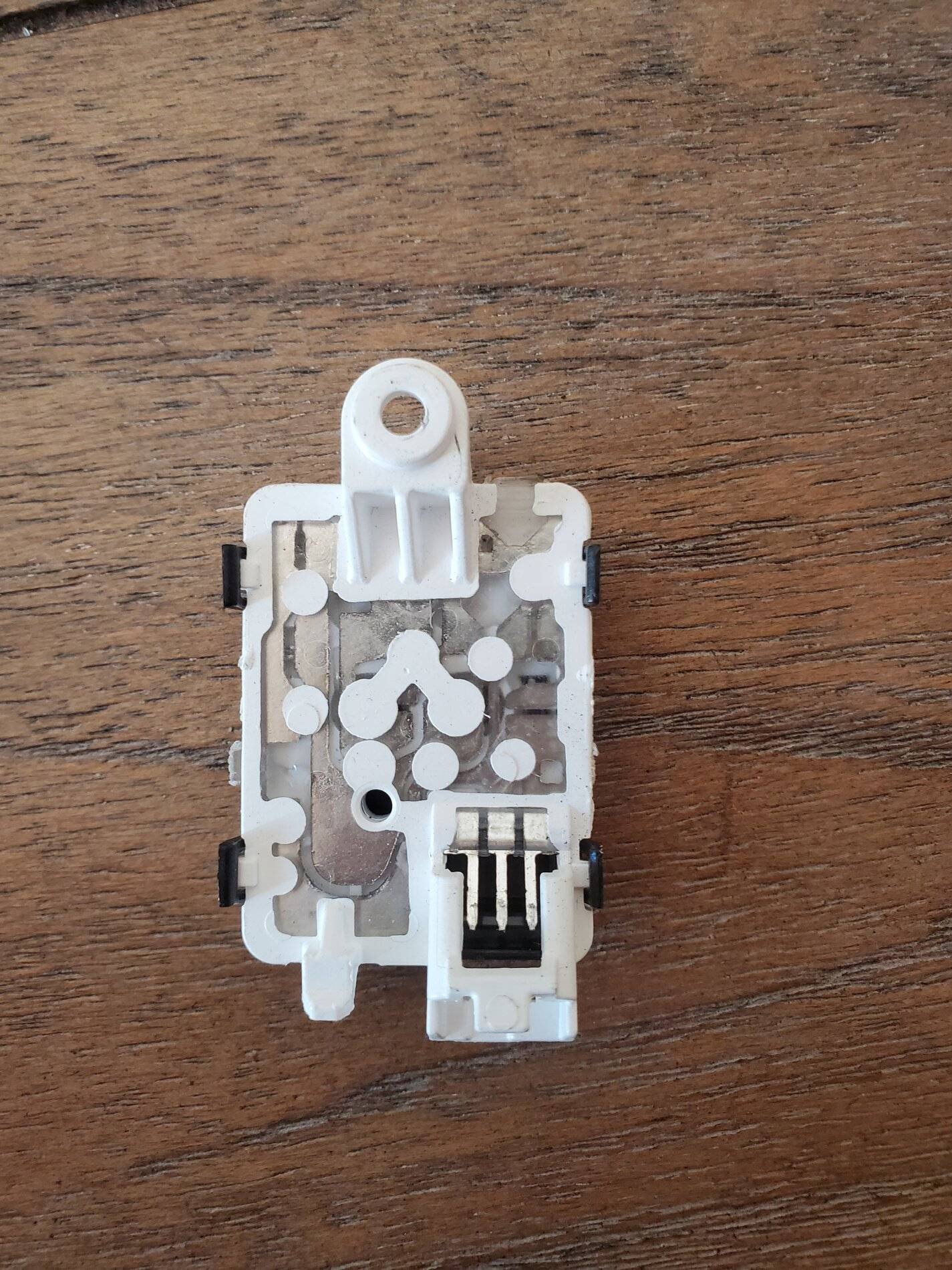

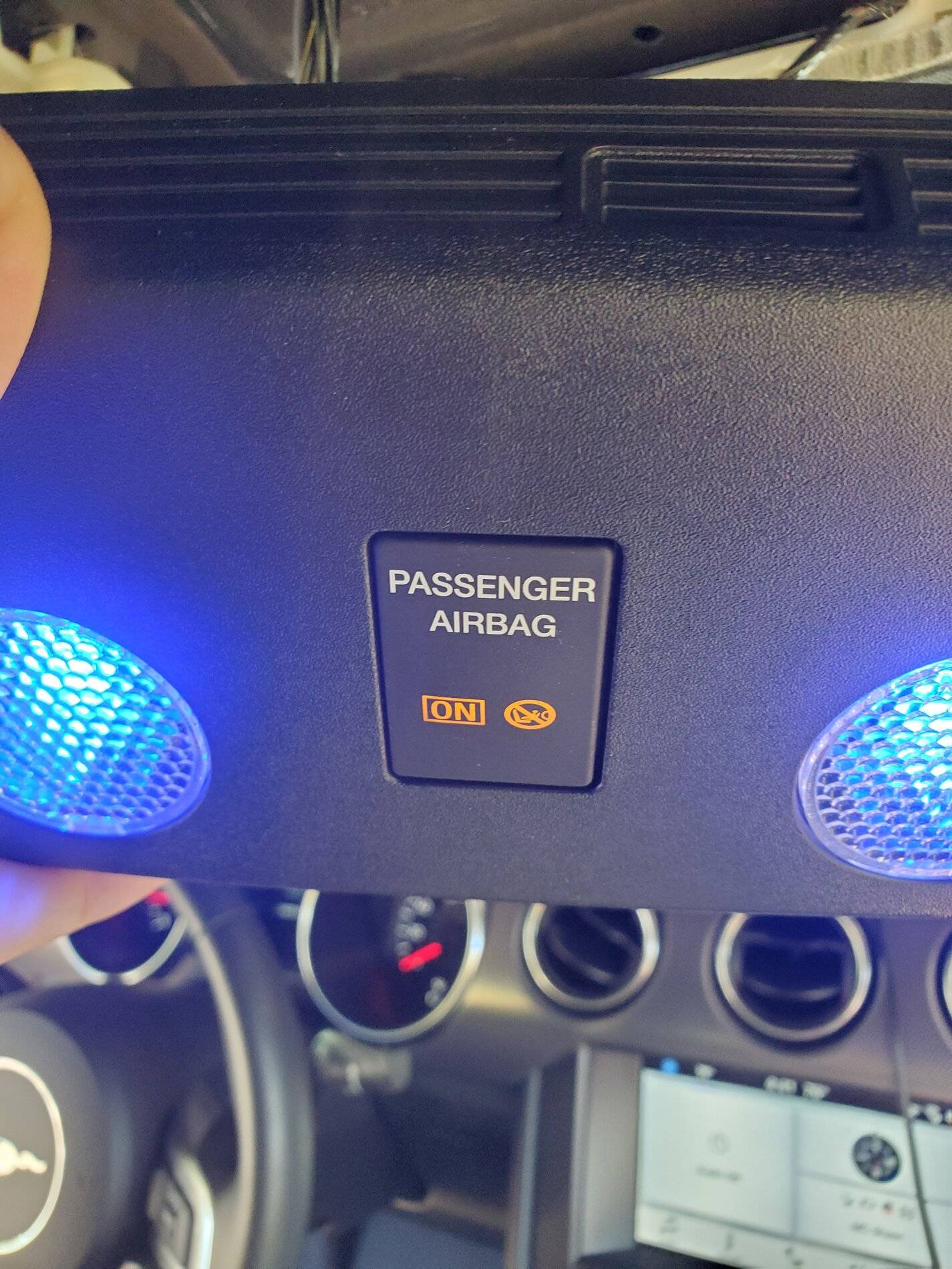

Wanted to post an update to this issue. I procrastinated handling this issue, and ended up failing a safety inspection because it "failed safety for airbag light staying on". After taking the map light assembly apart again, I compared the used 2016 one I installed with the original 2019 one I had where I broke one of the light bulb sockets. I found that while the map light assemblies themselves are pretty much identical, the airbag light module that is part of the assemblies are different. I missed that the first time being a newbie when I first replaced it 1.5-2 years ago.
The 2016 air bag light module has its plug angled at about 30 degrees and only has an airbag "OFF" light. When I angled it in the sun, I could not see any "ON" light and when I sat in the passenger seat, the airbag off light just turned off.
The 2019 air bag light module has its plug angled 90 degrees and has an airbag "OFF" and "ON" light. You can kind of see it in the photo when I angled it in the light.
I unscrewed the 2019 air bag light module from the 2019 map light assembly and it replaced the module in the 2016 (plug and play, the screws and tab lined up). When I plugged everything back in and sat in the passenger seat, I confirmed that the airbag light went from the "OFF" light to the "ON" light.
I'm going to be taking my Mustang back later this week to get that safety inspection sticker.
So if you ever break the map light assembly, the housings are interchangeable (with the 2016 one being easier to take on and off then the 2019 one), but you will have to transfer the air bag light module over as they are only compatible with their respective sub-generation (2015-2017 vs 2018-2022). Also don't procrastinate problems lol.

I zoomed in and cropped the image of the 2019 one since the web page seems to have sized the original image weirdly, and do not see any part numbers. I can confirm there were no part numbers on the 2016 one so I don't think they have one. I would say the best bet would be to try and buy a used map light assembly off of eBay. My 2016 one had cost me about $40 2 years ago. I'm not sure what a 2019 would go for right now though, but probably cheaper than $1200.
My best guess as to why Ford doesn't sell it individually is because the map light assemblies tend to break when taking them off (mainly the 2018 onwards, I don't know why, just see a lot of comments about it) where the clips are attached (I broke it on my 2019 map light assembly when I took it off). That's why they might package everything in that assembly as a set so if a tech breaks it taking it off they don't have to worry about since they're replacing the whole unit.
