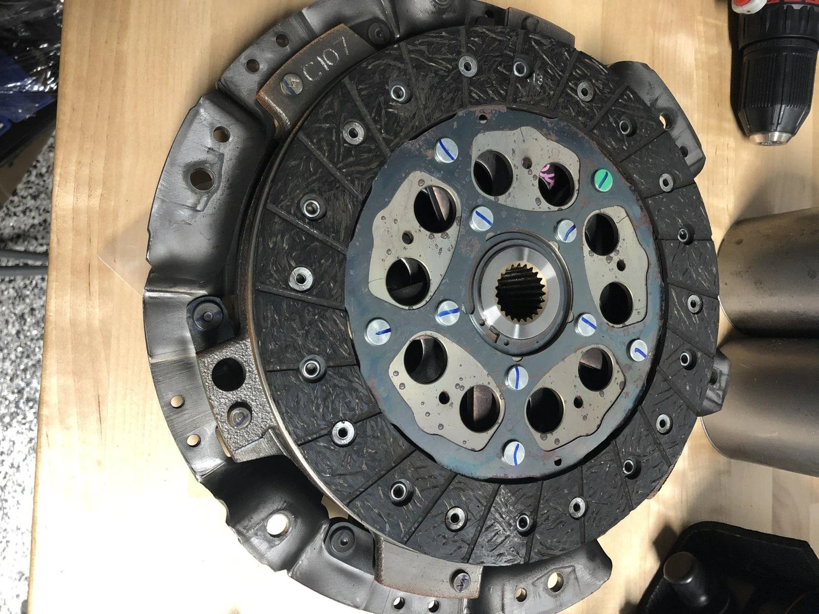

Interestingly enough - for those having the debate over whether the sprung hub clutch option is worth a $1200 premium over say a McLeod RXT or not - it appears the stock clutch is solid hub design.
Its got a snap/lock ring keeping it assembled as a unit from the factory and goes in and out as an assembly. I wasn't expecting that, but it sure made removal simple in case I decide to reinstall it some day!
Just more info for those trying to decide.
My stock clutch after 2500 miles and about 1200 of them whipple powered. It looks to be just fine but I wasn't on sticky tires and I've never done a burn out in it. So with clutch engaged power pulls it seems like a pretty stout piece. Its definitely heavy that's for sure!
