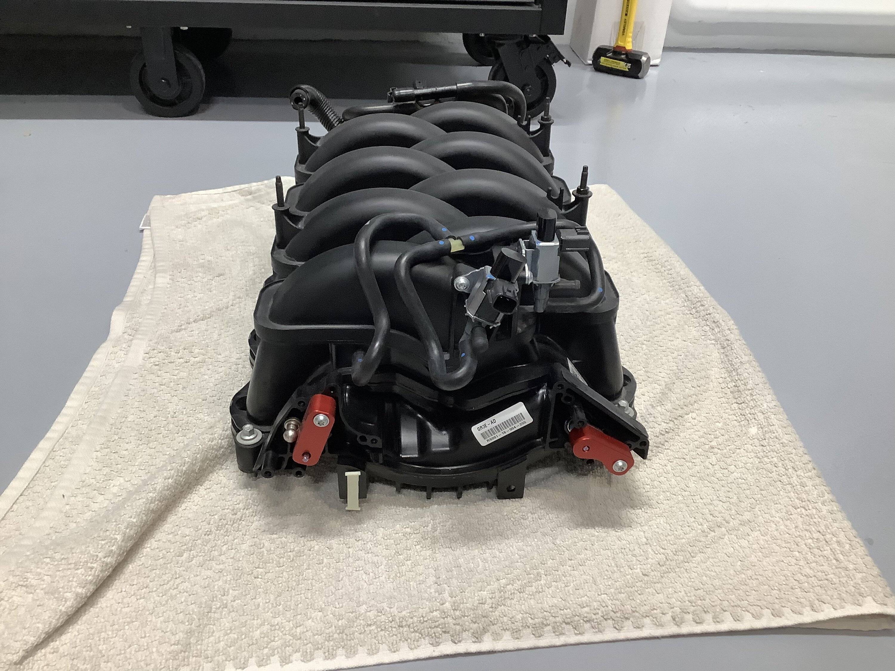

Boss has higher and longer powerband as does GT350/Bullit. Would require tuning/lockout IMRCs. Solid 10 numbers with an increased RPM range

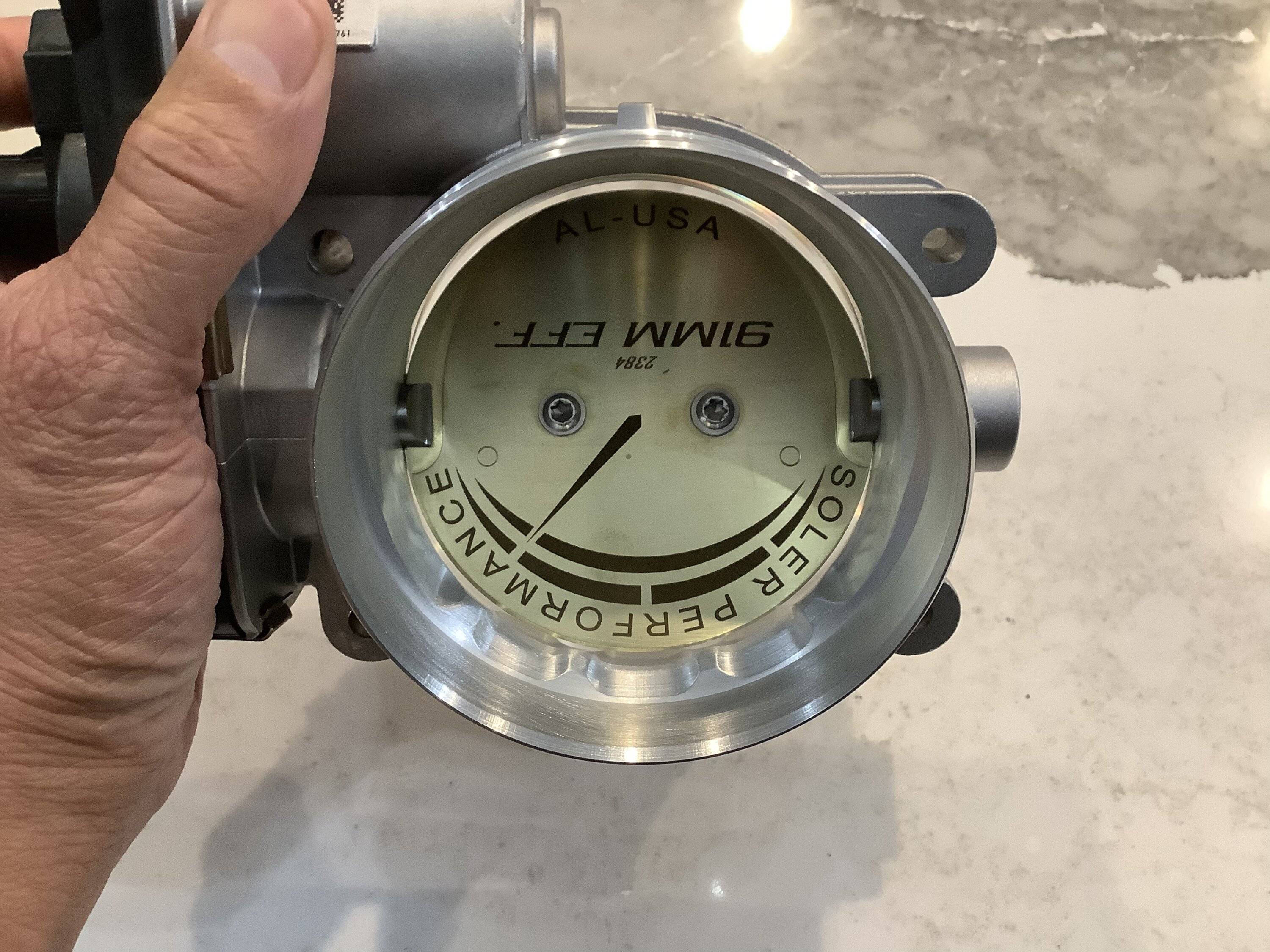

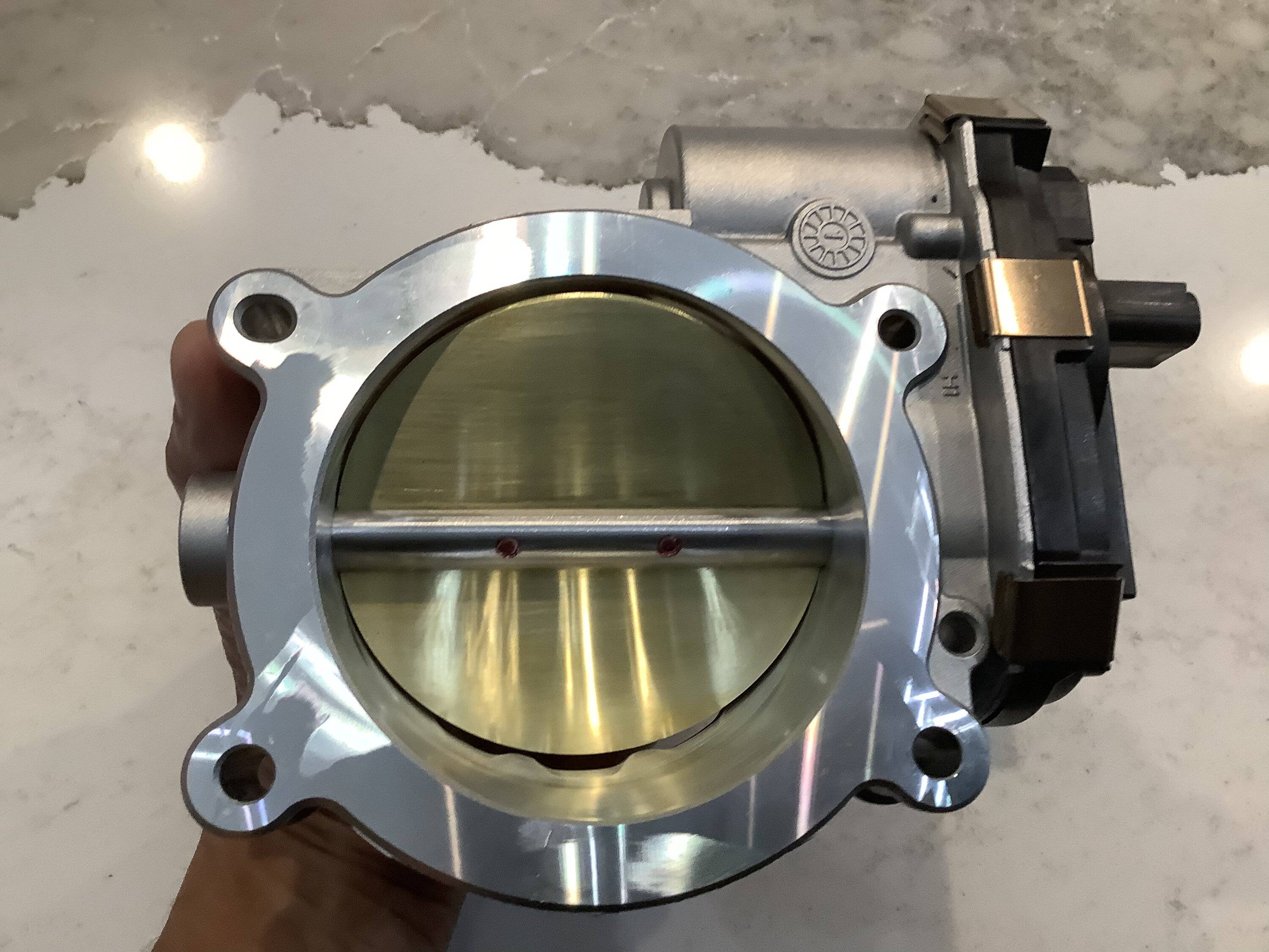

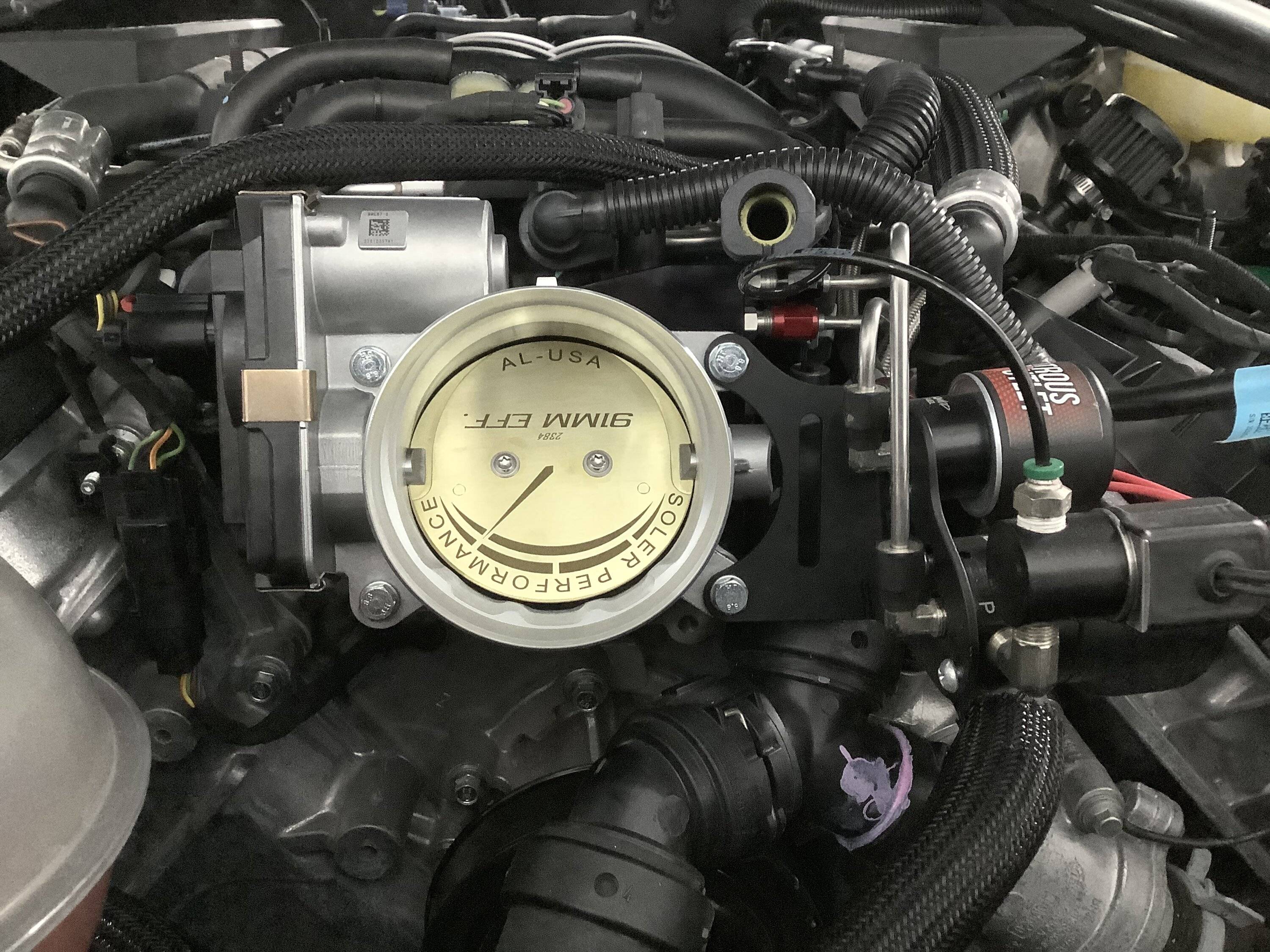

I have the GT350 IM (comes standard on the Bullitt). I also added a Soler Performance ported 91MM TB, but haven’t dyno’d again since the addition. It sure looks really good though.
I also added the MMR IMRC lockout kit, which will require a retune.

My TB was actually a factory 87MM unit, which I sent to Soler and had them port to 91MM for me. There was no tune required (although a tune is always best, IMO). During the short time that I ran it before delving into other work, it performed very well. While I don’t know if it picked up any additional power, it certainly wasn’t a step backward either.
I forgot to mention that I also have Soler’s throttle controller too which also pairs and works well with the ported TB.
Brandon at Lund was my tuner, but that was before I added the TB. Perhaps with the upcoming retune that’s required for the IMRC lockouts, I’ll feel/see an improvement in the ported TB as well.

The car was initially tuned (with the factory installed GT350 IM) after I installed LTHs. About a year later, I added the TB and did not retune. Having said that, the Soler ported factory TB does perform at least as well as it did before porting. I would guess there may be a little power to be had by tuning after a ported TB, but wouldn’t expect huge gains.
I liked the idea of helping my car breath in and out (short of adding cams), as well as it possibly could, which is why I later added a PMAS CAI and ported TB to compliment the LTHs.

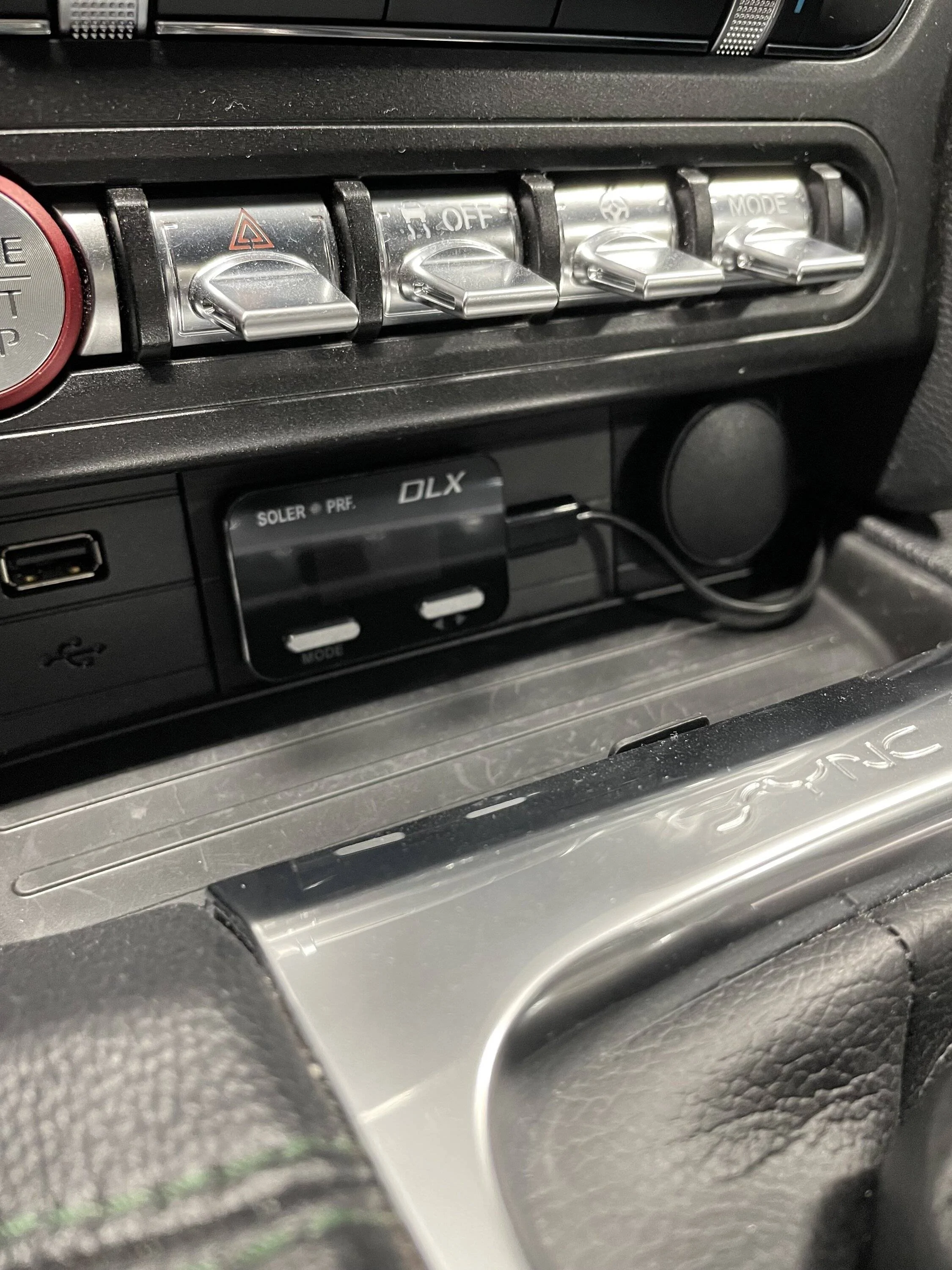

@In5am0us, I do have the Soler Throttle Controller that adjusts the sensitivity of the throttle and has multiple settings on it. It can be manually adjusted by a small LCD screen or via Bluetooth from your phone. I like it a lot and have been running it along with my ported TB. Here’s a pic of where I mounted my LCD screen.
