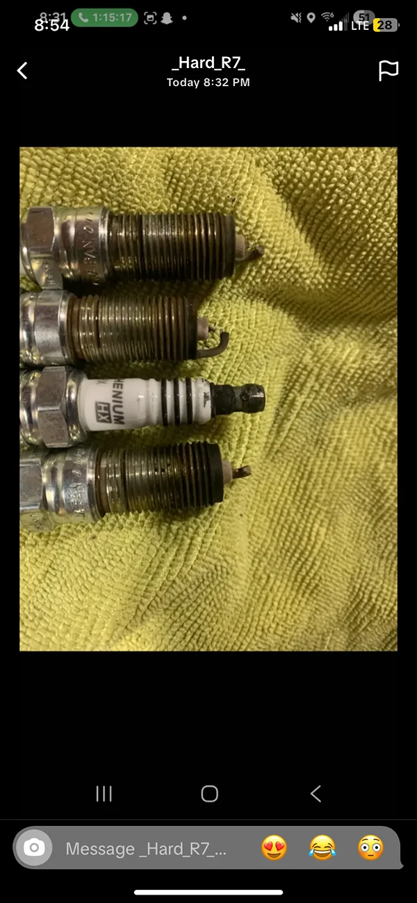

One of the things the tuner did ask for was new O2 sensors. Put two new ones in right before that datalog I believe. That was me in the log. I haven’t driven it since this issue except around the block because I don’t want to cause any damage. Is there something else I should try while datalogging to simplify it a bit? I could also try putting in some octane booster? Maybe bad gas? I could always buy new plugs if need be. I think I might have a picture of the plugs I pulled. It currently has 93 in it now since I went put all the factory parts back on it including factory tune.

Plugs from passenger side, I can’t find the other pics I took of them

Check the gapping on those plugs...
Oh, ok so basically you have done everything you needed to fix this issue. Strange.
Are the o2 sensors you replaced, are they factory OEM sensors? I have bought aftermarket ones and had issues with them, but it was extremely obvious in a log. What cold air intake do you have? If you messed with the MAF sensor, are you SURE you put it in facing the right way?
