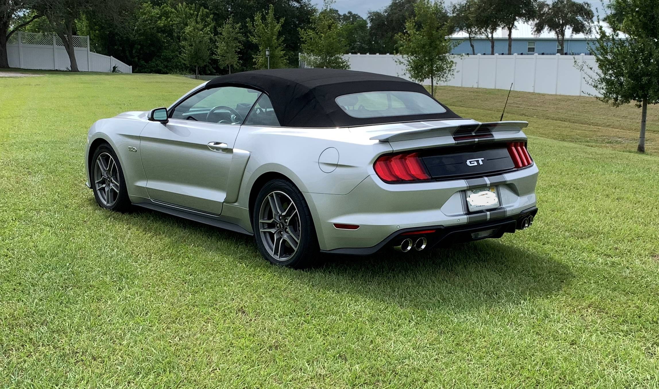

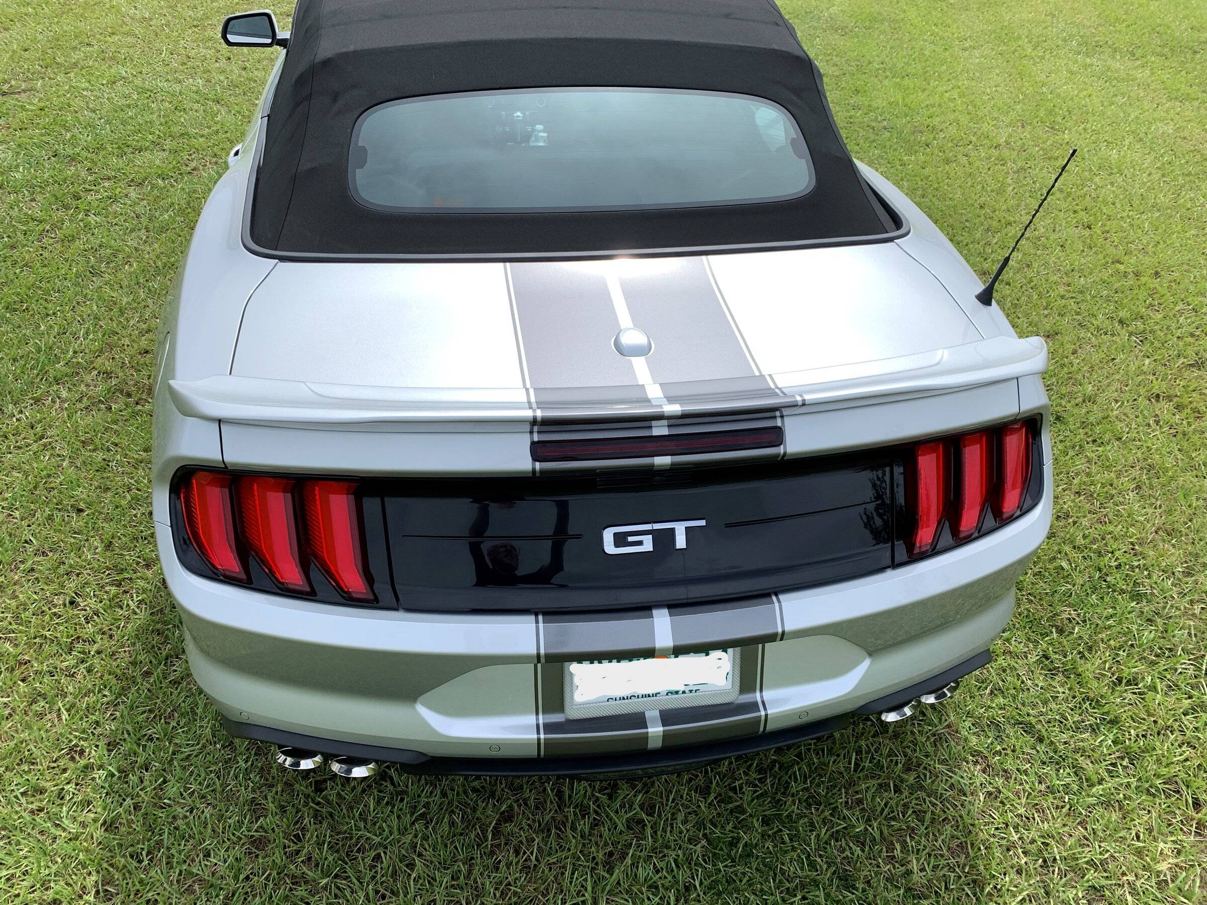

I purchased this one pre-painted for my convertible and I am very pleased with it.
https://www.ebay.com/itm/132012775761
The fit was very good. It wasn't as refined on the non-visible side as I had hoped, but functionally and aesthetically, once installed is very appealing.
The holes of the token spoiler and this spoiler did not align, but the token spoiler holes were completely hidden.
Using the supplied templates according to their instructions worked great for a first time fit.
I'm attaching photos of the completed spoiler.

This Sia's it's direct bolt on if you already have factory lip spoiler. Did you have to drill at all
Yes I did have to drill I wish the supplier would have done a little homework and made the hole locations the same as the OEM mounting points. They could have.
I say they could have, but if they did their homework, advertised no drilling required, and they got off 1/4 inch, many folks would complain more than they do now.
Because the spoiler is permanently attached, I'm quite okay with the way they sent it. More work for me, but I'm happy with the result, just the same.
