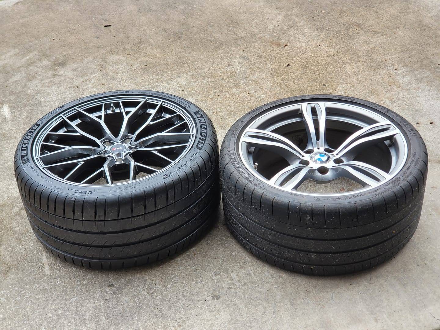

Just an example. The one on the right is a 295 on a 20x10" wheel. The one on the left is a 315 on 20x11" wheel.
