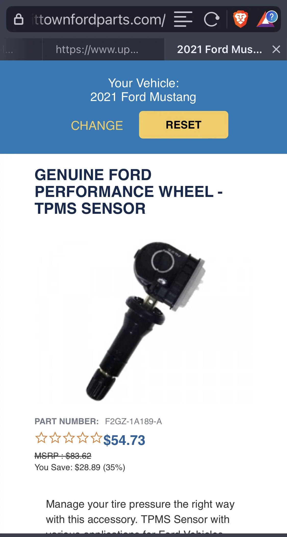

You sure? They’re what @LevittownFordParts shows on their website. Aside from the Shelby’s I think all the V8 sensors from like 18+ are the same. I’m open to correction however.

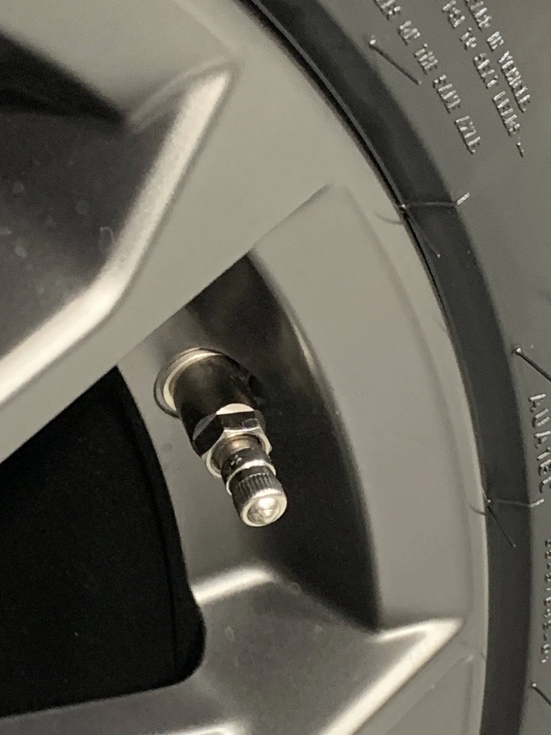

Looks like the sensor itself is the same but Ford sells a separate valve part # FR3Z-1700-C for unique applications as such. We will get these added to our site soon

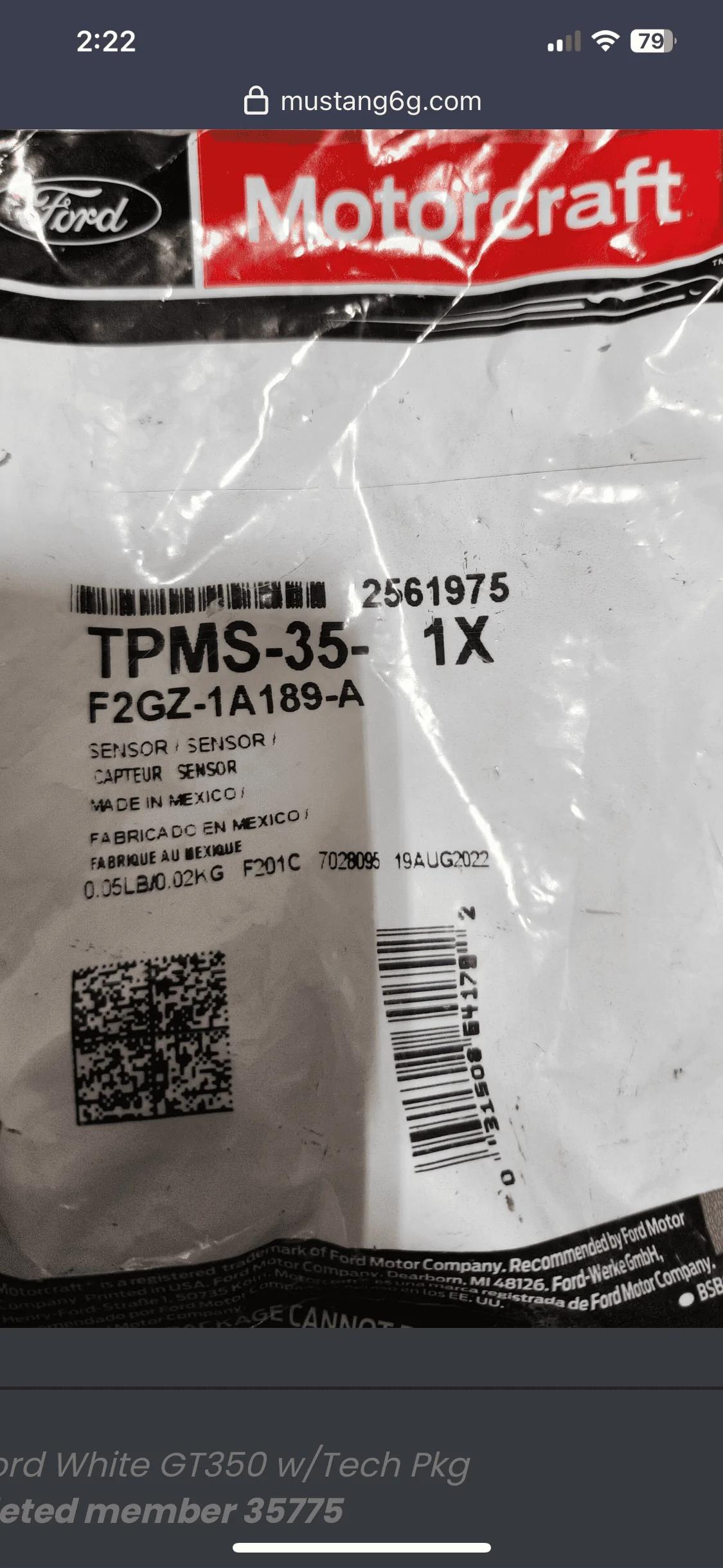

I'm going to show these to the tire shop I had put my wheels/tires on. I bought some from him that just won't work. They read the psi just fine, up until after :45 mins of driving, then 3 go off line, some times 2 & I get the tpms light. He's tried every frequency in his programmer & none work.

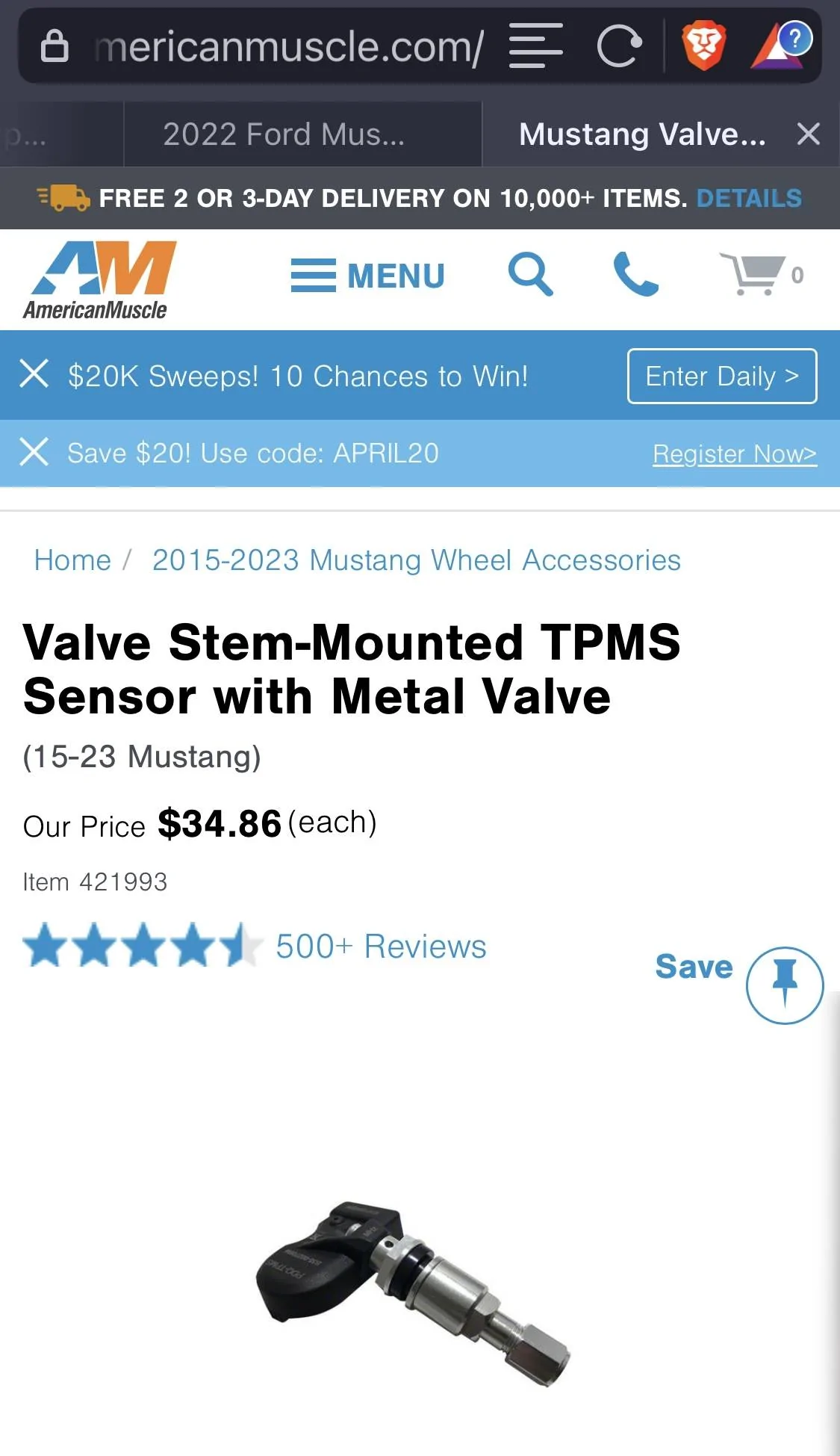

Thanks Benny, pretty sure I got it figured out if you wanna confirm. PN: FR3Z1A189C. Same Hz

That does look good but even with a Mach 1 HP VIN it still wont verify. The photo is metal like the valve I pictured and it's 315mhz so you should be good to go. Ford shows it fit's Shelby's only, I think there just behind on data.

Yep, thanks… shows GT500 from what I’ve found and since it’s a “PARTS” car 😬 seems right
