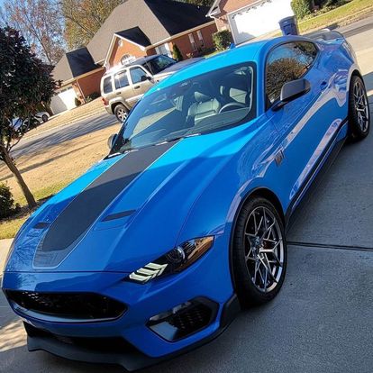

Hmm I do like those, are those the "platinum" colors? any other pictures? And aren't those the same sizes that I already asked about? What makes them different aside from color and them not being geunine Ford?
They're 19X10's w/35 backspacing. Yes Platinum.....They're about 7lbs a wheel lighter.

Please forgive my ignorance but the backspacing helps them not poke out like the genuine Ford ones correct?
I believe so......The fronts on mine don't poke as much as the Stock ones. I've got about 12000 miles on them without a problem. The center caps are a tad smaller than the OEM's but I was able to get some horse ones of EBay. You'll need tuner lugs as well....the OEM's won't work.

I just wanted to follow up on the platinum mach style wheels that were mentioned, the ones in the link are 19x10 and 19x11 so what tire size am I going to be able to use with these rims on my 2015 mustang GT?
I would call them......They should be able to tell you fitment stuff etc. I personally have 19x10's on all four corners. I know they're listed as a staggered set, but they should sell them squared like they did mine. I've put them on my wife's 2017 with no problems with 305/30/19's

Anymore pictures by chance?
