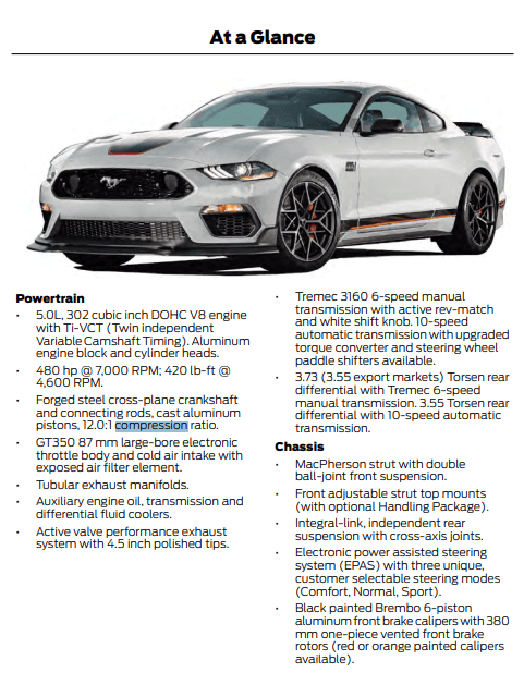

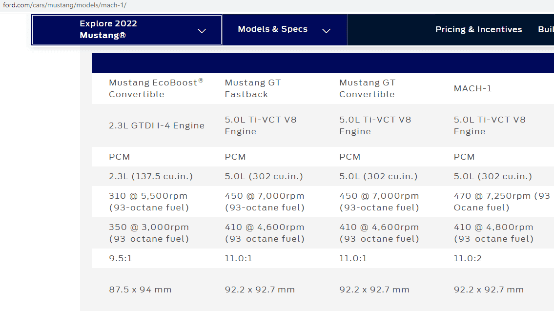

Which is correct literature or website? I'm inclined to say literature.
Apologies if this has been covered already. I also pulled 2020 literature for Bullitt and that is rated 12.0:1 in literature.
2022 website

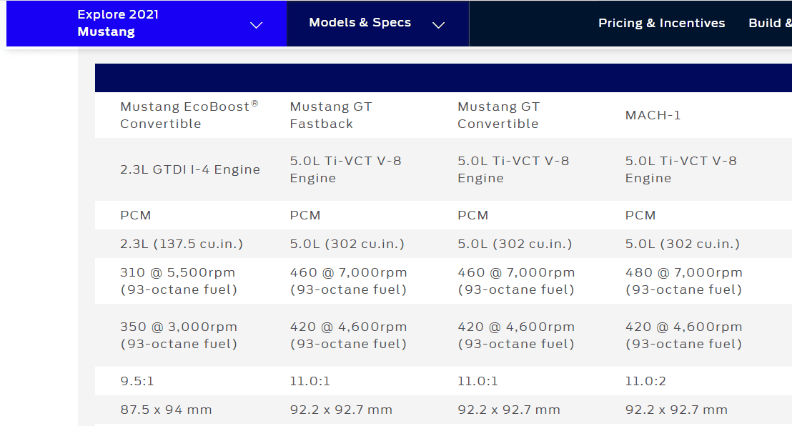

2021 website

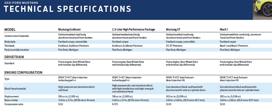

2021 technical specs document (notice 12.0:1)

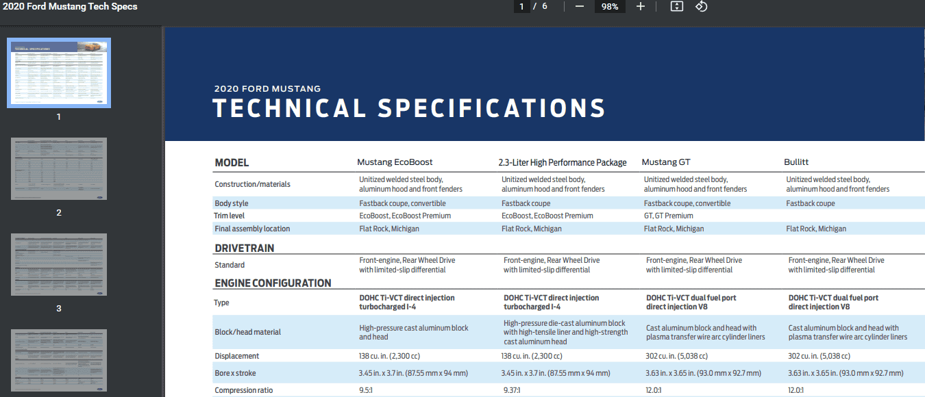

2020 technical specs document, notice Bullitt and GT 12.0:1

Compression Ratio is 12.0:1 across the Coyote range since 2018.
