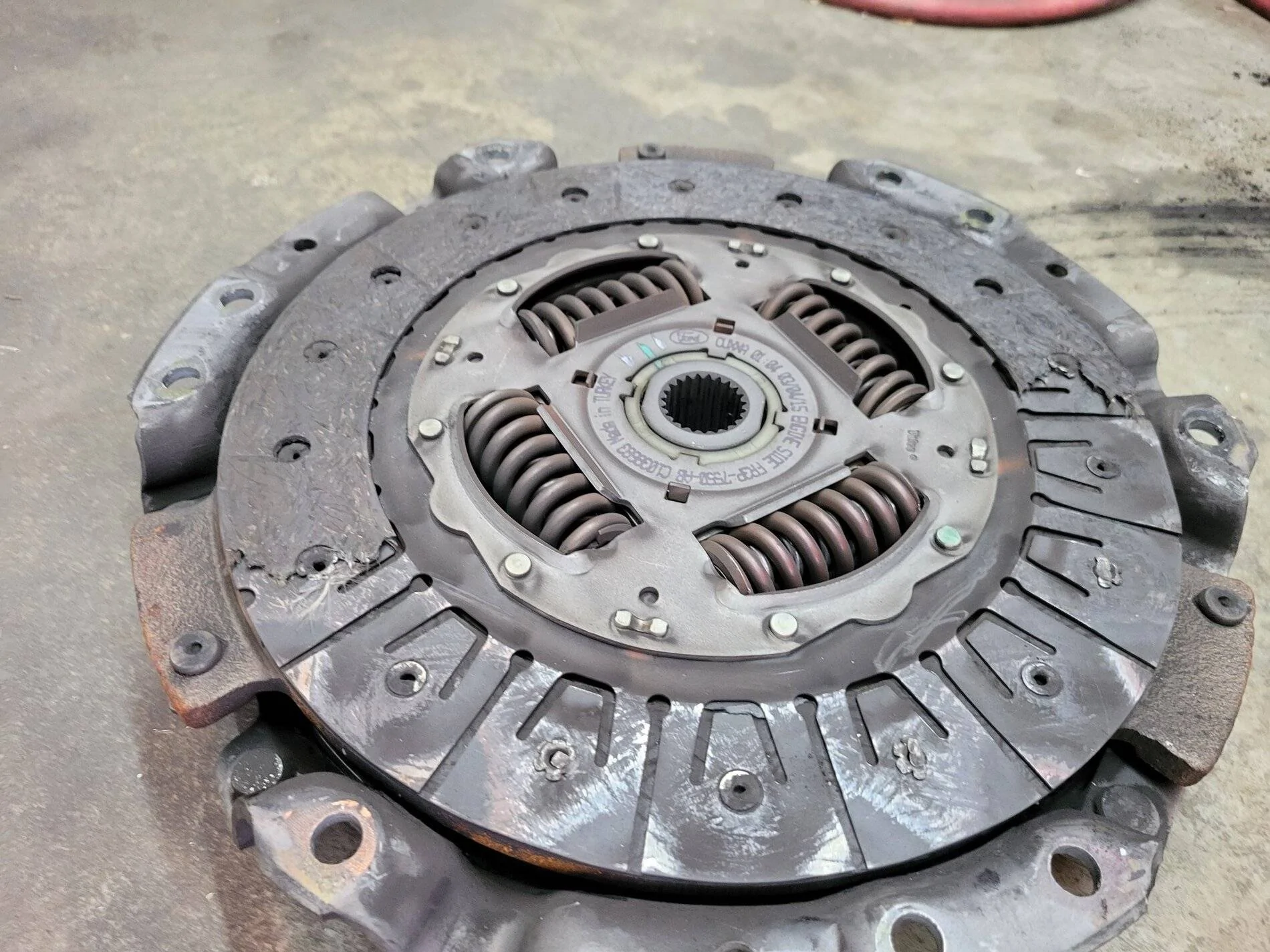

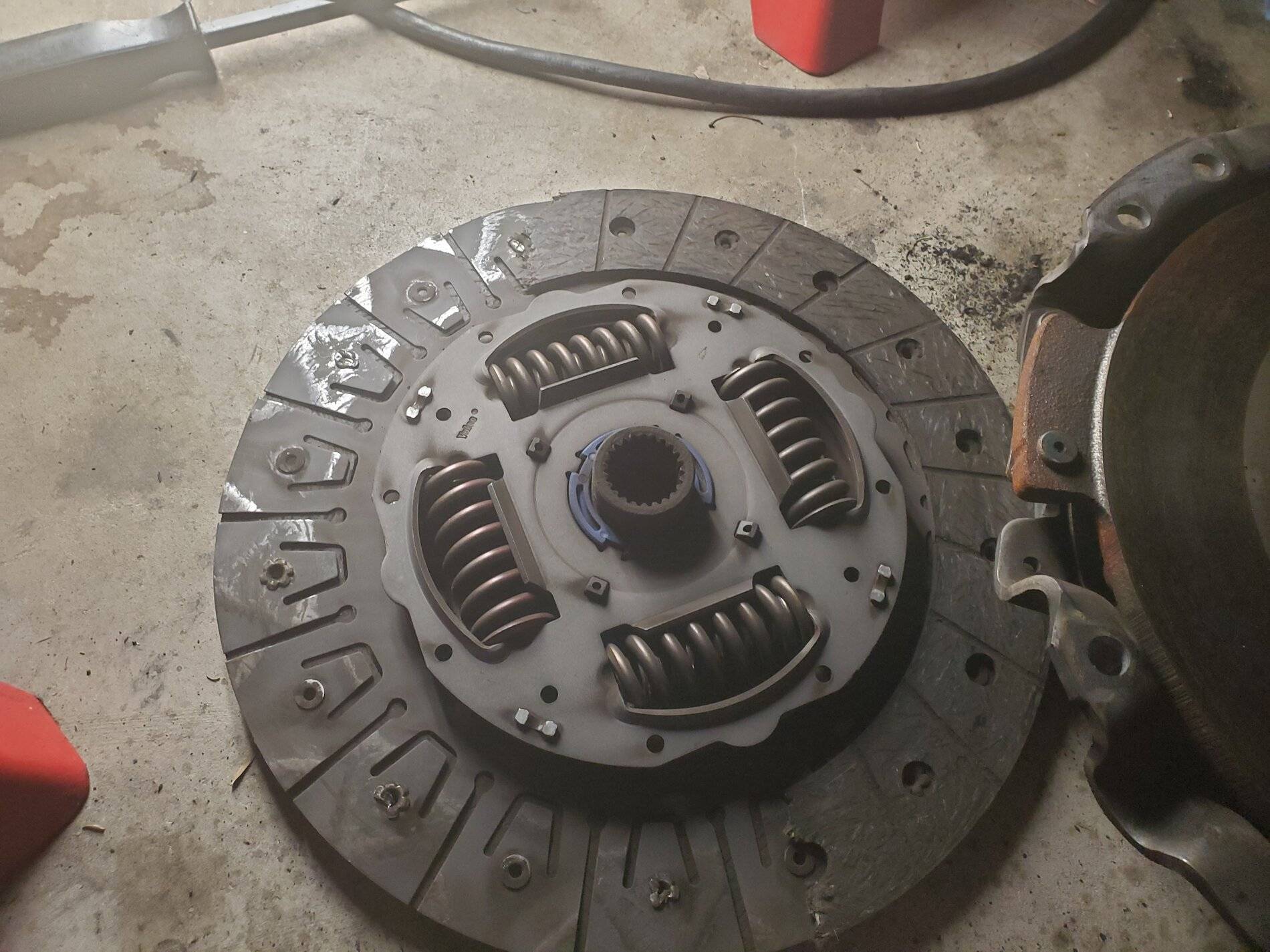

A few weeks ago my stock clutch came apart on a high rpm shift. I was a little surprised being the car has only 22000 miles and hasn't really been abused. When I dropped the transmission it was easy to tell what the problem was.
In my opinion the clutch could of had a better design. I don't think the single row of rivets helps out at all.
