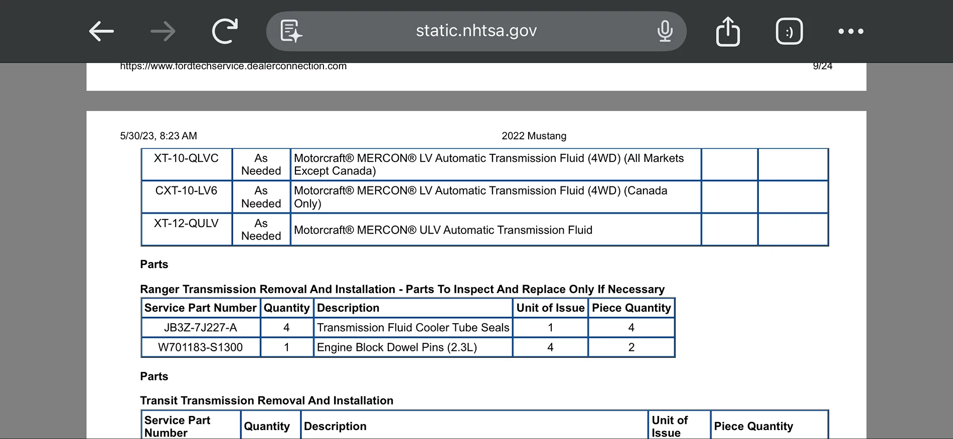

Has anyone used LV vs ULV with their 10R80? Chevy uses LV with their 10L80 vehicles so I'm wondering if anyone made the change since the transmissions are identical. I see some benefits to doing this
quite an old thread by now but I just found this in the recall data for the 10R80. It’s the same trans for the trucks and cars. So going LV vs ULV should be an upgrade in my eyes if ford is calling for it on the 4wd models of the trucks. To me this is fords admission of guilt that ULV is inferior.
