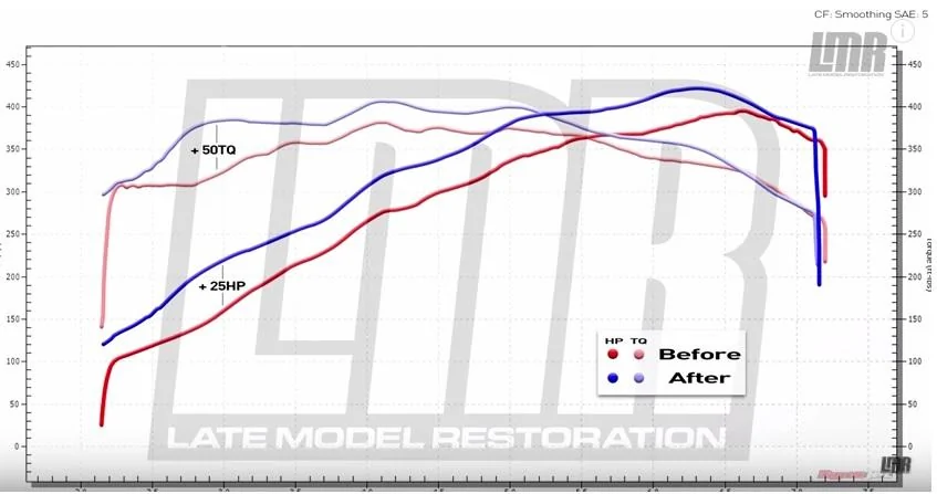

This is a dyno LMR did of the BBK long tube headers, as you can see most power was made from 3k rpms and up.
You'll love it...but most power will be seen up top, not at all midrange...get a solid tune for it to help with that.
Yup..absolutely...I've unfortunately seen others not so good...no so well tuned, etc. too.
Do you know what other mods they had on the car as well, or was it stock with the header only change?
Yea...their car was off road and no cats, with Air Raid and NGauge with Lund tune...works everytime!
OP wants catted and the Borla Touring doesn't breathe quite ad well as the MBRP they used for testing....should all work well though...
