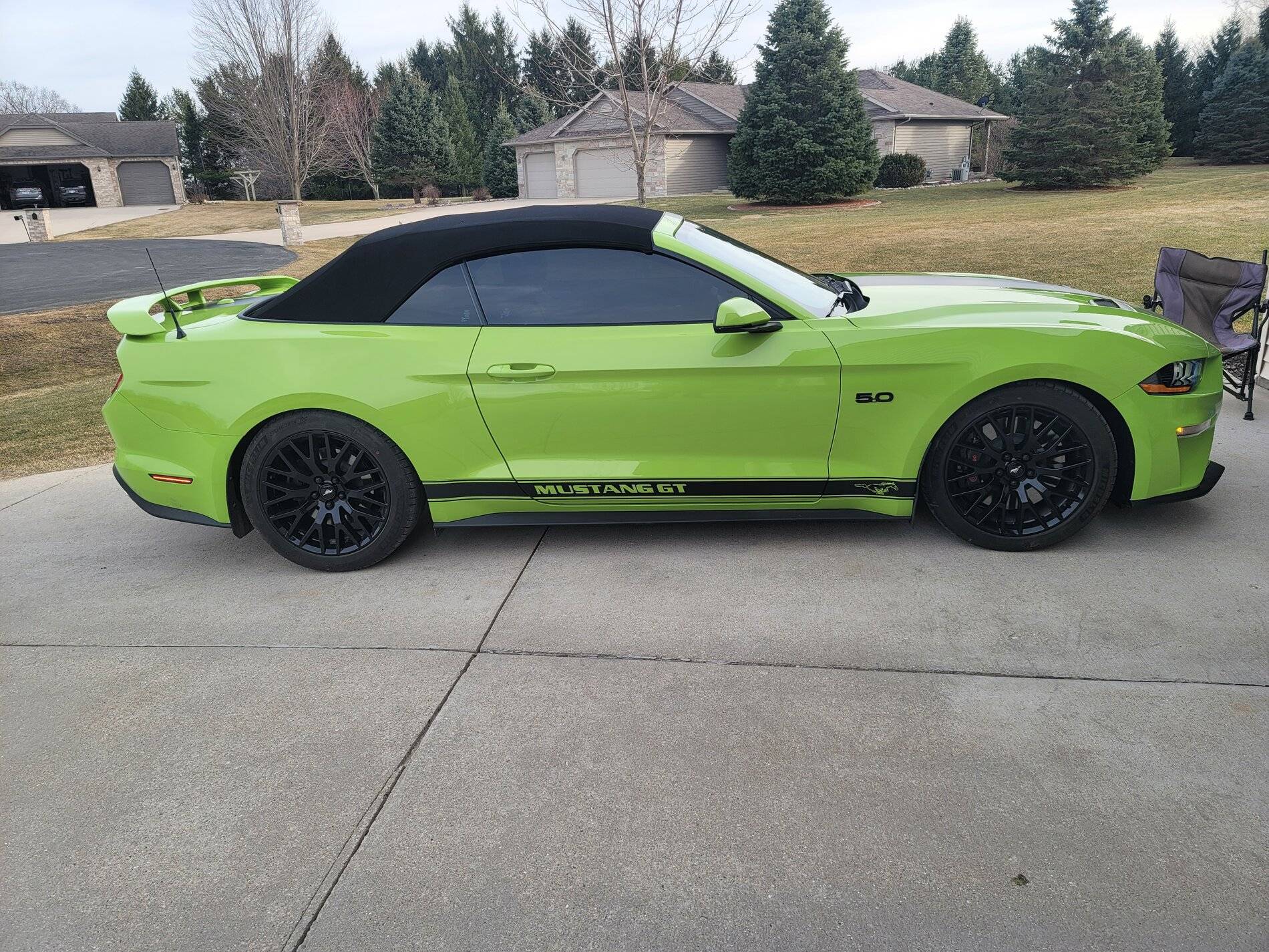

Got everything put back together today. I forgot to measure before I started. Now 28" ground to top of wheel well at the center rear and 27.5" front. Should be about an inch all around.

Looking very good!! How it handles?

I only took it for a little drive. Needs an alignment. I also did the irs alignment kit as long as I had it apart anyway. But the little I did drive it it seemed a little less harsh on the little bumps but still flat thru the hard corners. No body roll. Just as advertised.

Looks great Carl, get that alignment & report back!
