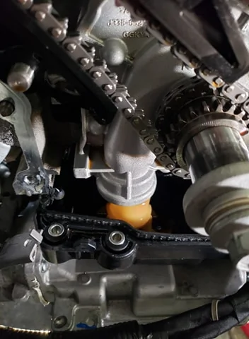

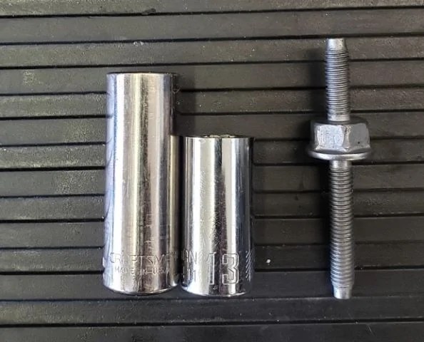

I'm in the process of doing my oil pump gears and Whipple stage II supercharger. On the 2018 on up, we have the composite (plastic) oil pans, so to get the oil pump out, you need to at least lower the oil pan. In the front of the oil pan, there are a couple of bolts with studs attached. There is no clearance to get a normal deep 13mm 1/4" drive socket with a swivel on them. I had to take a deep socket and shorten it to get it to fit with a swivel.
Just thought I'd put this out there to help someone have less grief.

Any advice on the one that is underneath, right above the steering rack? That's the only one really giving me issues.

Long 1/4 inch drive extensions with a swivel socket.

What is the point of the long extension on the studs? I can’t see any reason... Could they be cut down with a hacksaw to make a shorter socket work?
Another question since I’m about to do my OPG... looks like According to the repair manual that in order to fully remove the oil pan you have to raise the engine a couple of inches and lower the sub frame about 4”... I’m assuming there is enough room without doing those things to lower the pan enough to get the oil pump off... but to replace the oil pan gasket, I’d have to take the pan completely off... correct? It appears I have a minor gasket leak...
