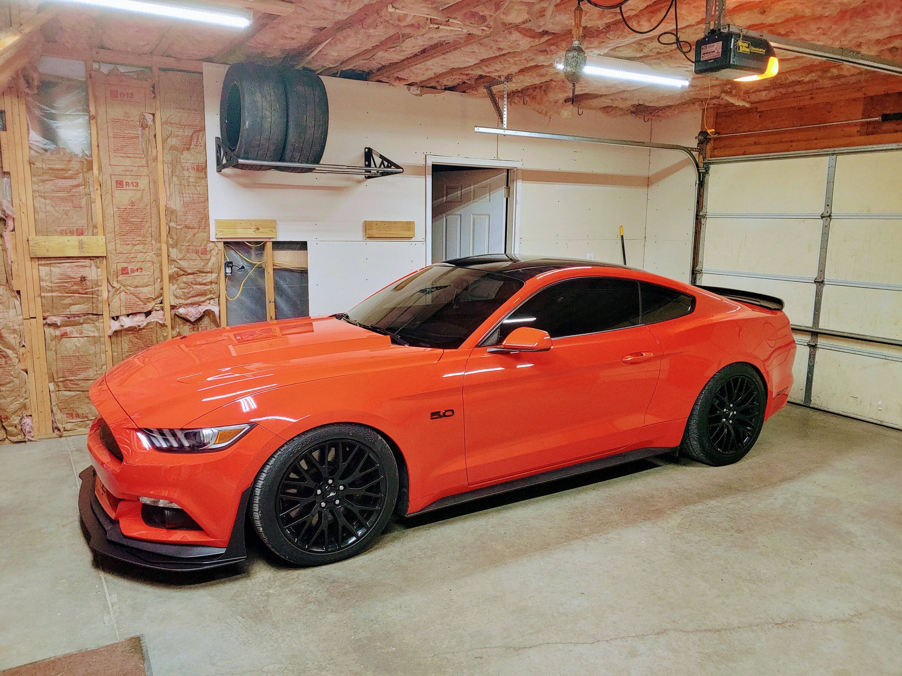

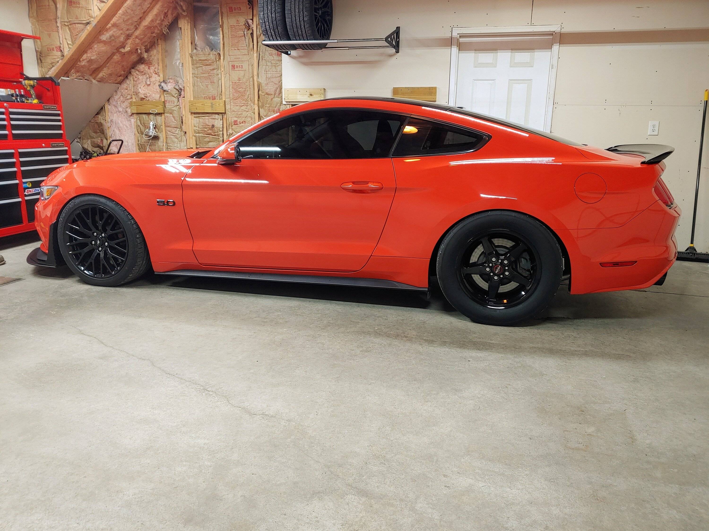

I have the Steeda Ultralight Linear Extreme Springs and they are great. All my experience with Eibach has been trash. Their springs are always crashy and bouncy. I had SR Performance springs on my car before the Steeda and they were bouncy. I think linear springs suit this chassis better for street driving. I don't daily mine, but I would have no problem if I did.

btw love the Orange pics!
