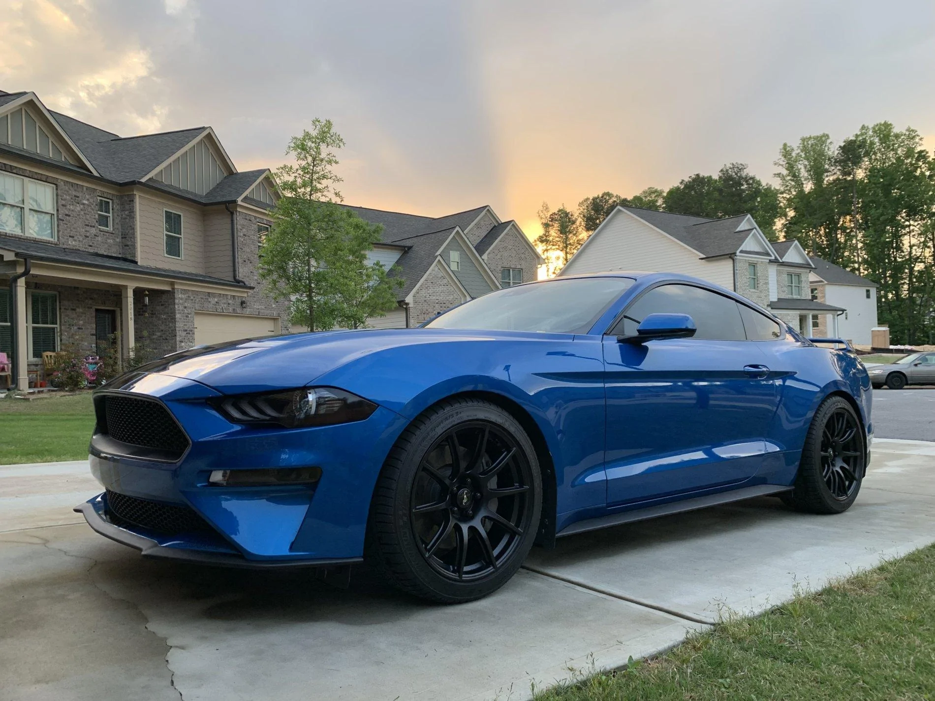

I have the Steeda MR springs on my EBPP. The drop wasnt quite an inch, and i used a 1/8" spacer in the back to try to keep the back from being lower than the back. Not really happy with the amount of drop. The EB starts with smaller diameter tires than the GT so it needs more drop to fill the gap, unless you want to switch to taller tires. When i started looking, I didn't find the Pedders, but i did find them recently. Ive been considering switching to them to see if i got a better drop with them than the Steeda.
Actually all the S550 tires whether they are 17", 18", 19" or 20" all have the same overall diameter. The only exception is the back tires on a GT with the Performance Package which are .7" larger in diameter.
You got the sports or the dual rates?
Car looks good I really like the stance.
I agree - it looks good, in more ways than one!
There we go... I was totally drawing a blank on who had done that install, and I only think about the grille delete when I think about your car. The whole package is just friggin' fantastic, though, I love how your car has turned out. I personally wouldn't drop it any further, but I kinda like how my fully-stock car sits anyway... Outstanding, RB!
At the time, there was only one option, it was a few weeks later before the other was released. Went to look up the order, it was the sport springs. I think they’d be great with 275/40/19, but I’d personally like a hair more for the 285/35/19 that I went with, which are actually about 0.17” smaller than factory. 0.18” lower of the Pedders sounds just right for me.
Thanks! I do it for me, but it’s nice to know others like it too. :) Next up is red Brembos from the Bullitt! :D (I’ll be saving for a little while for that)
