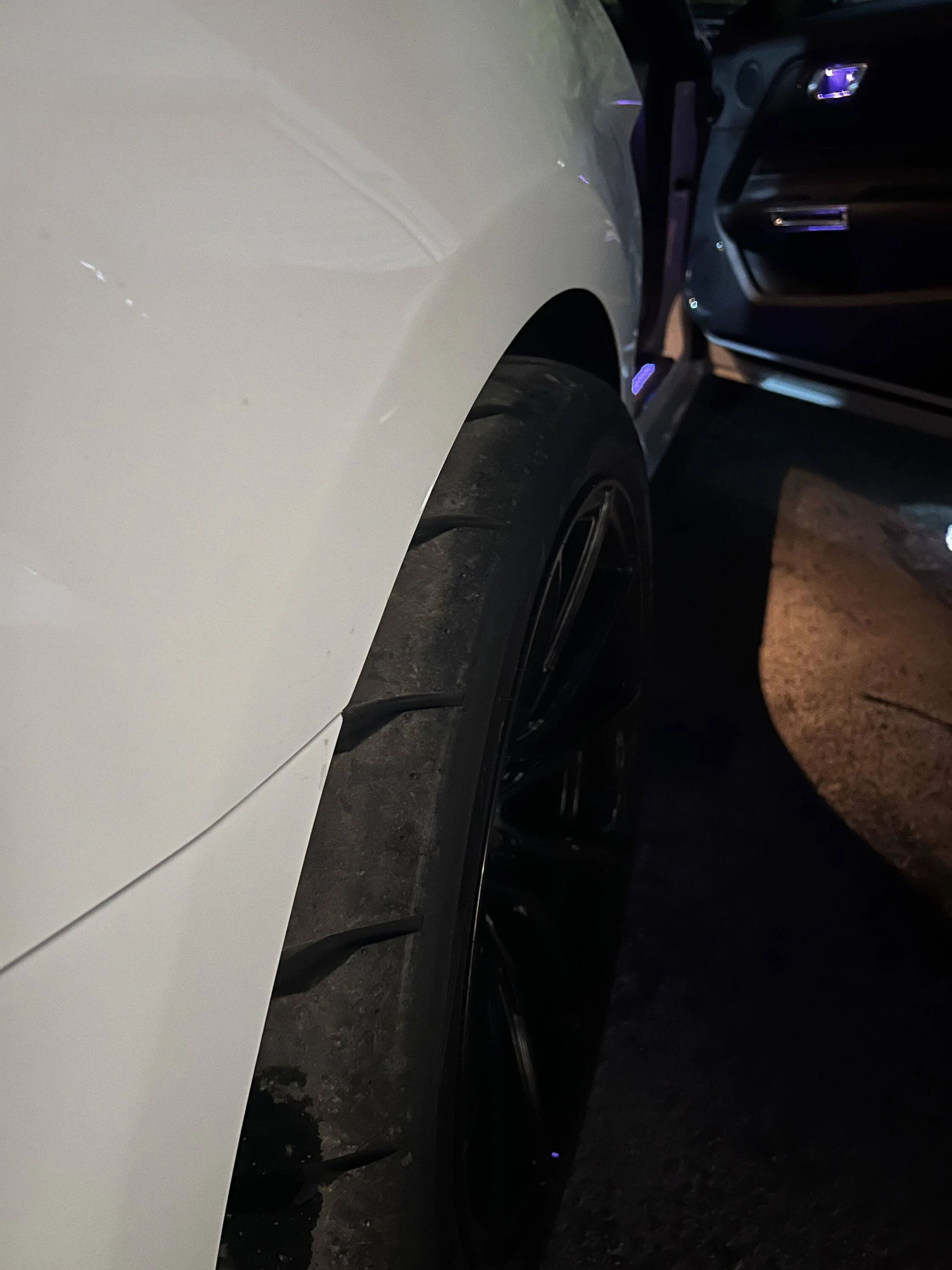

Yea 30 gonna be rough im lowered on eibach with same size toyo r888 but 50 offset
