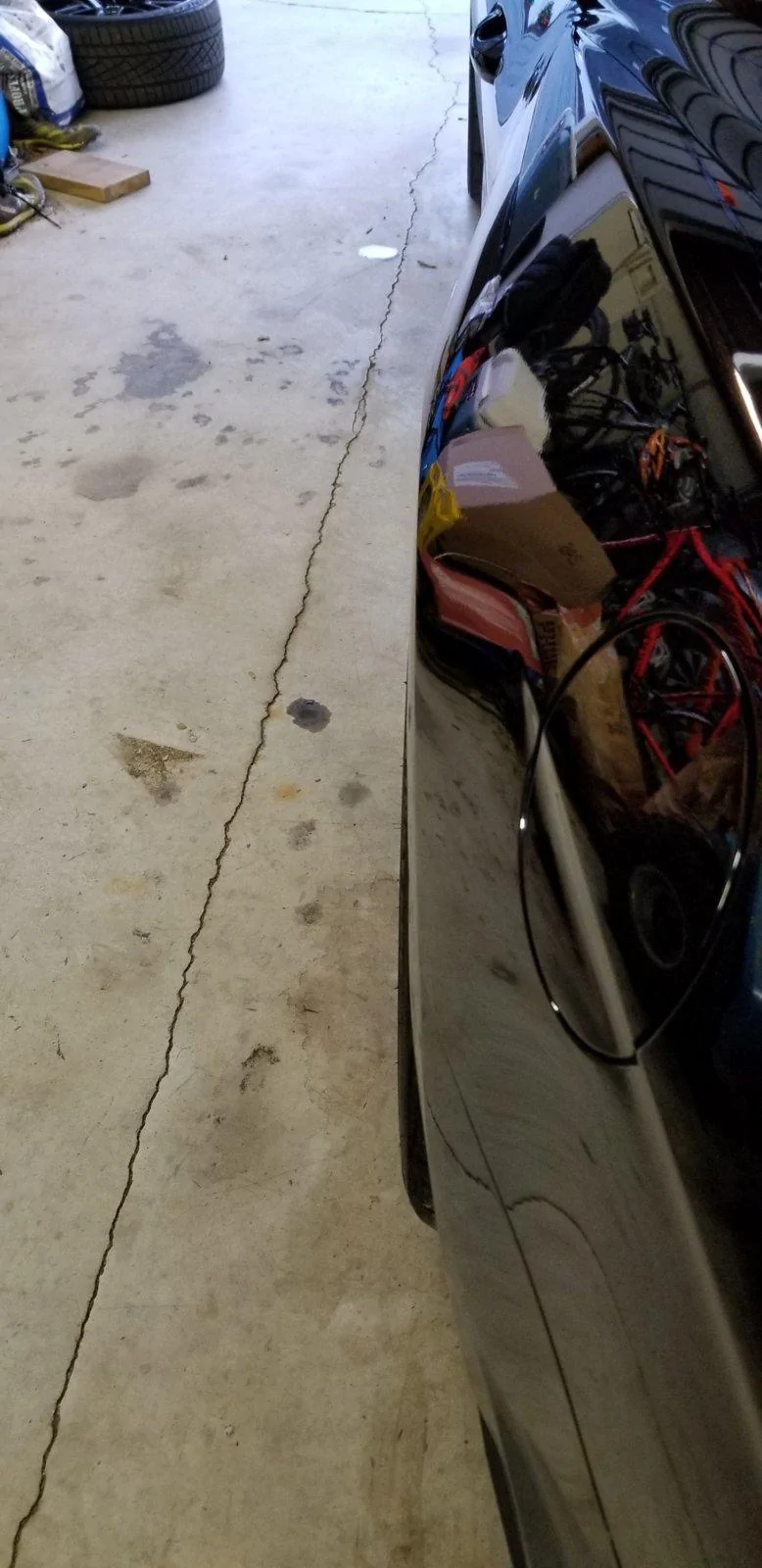

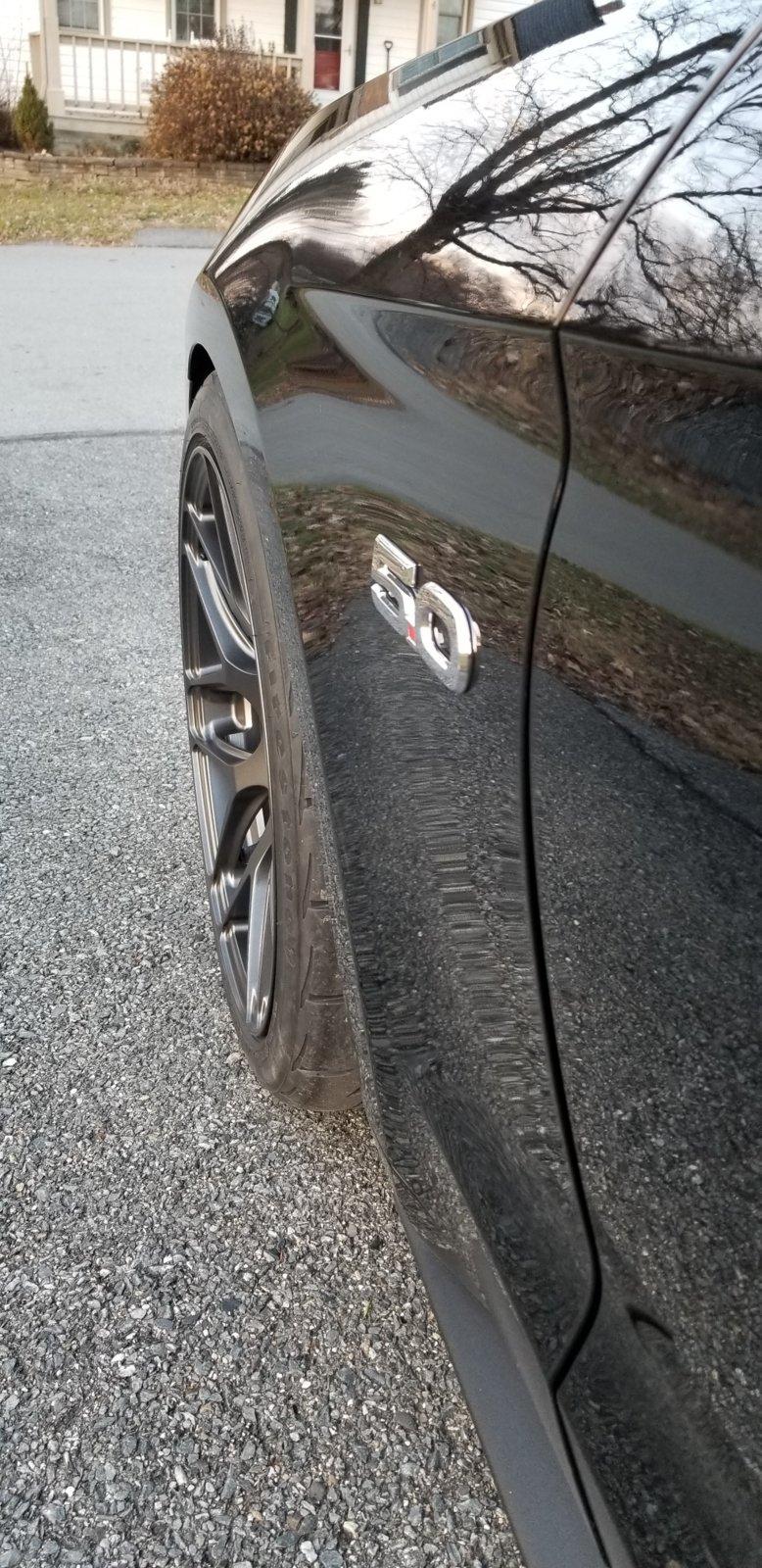

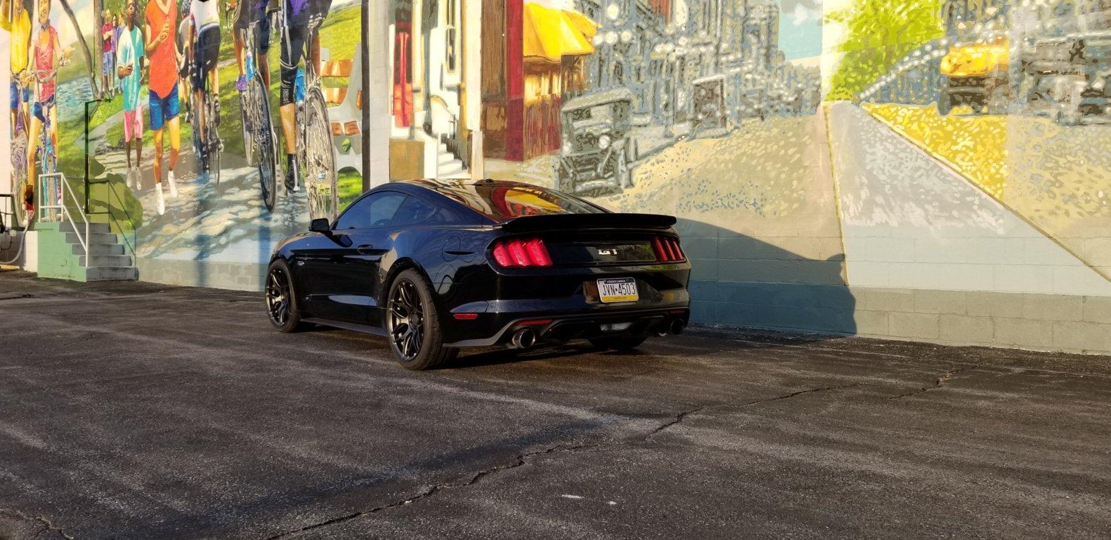

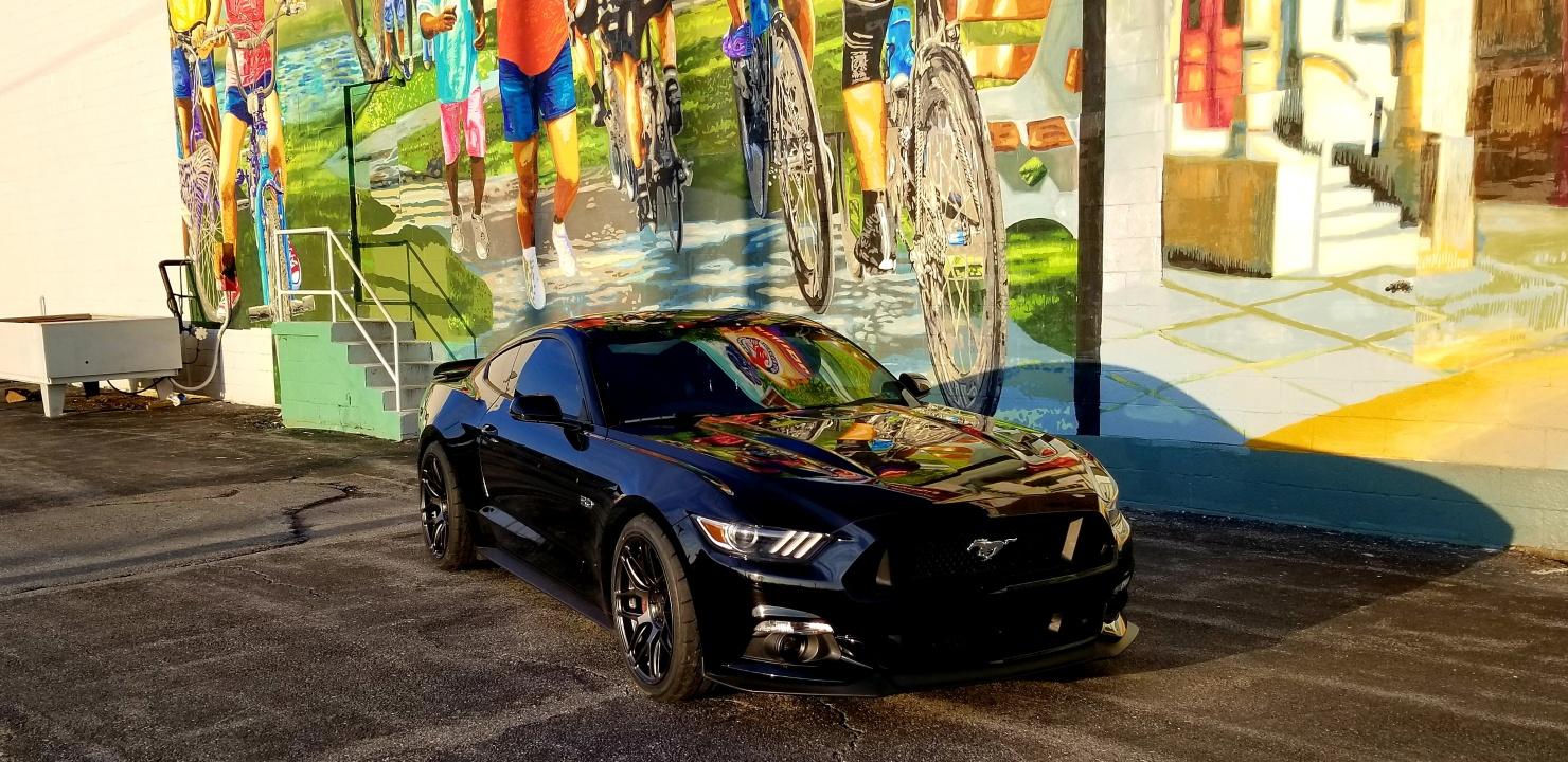

I'd go with et 35 and et 50. I have 20x10 et 38 sqaure with 275/35-20's and all 4 corners are pretty flush. With an et of 35 and a 285/35-20 tire you might have a touch of poke. Here's some shots of mine to give you an idea.
